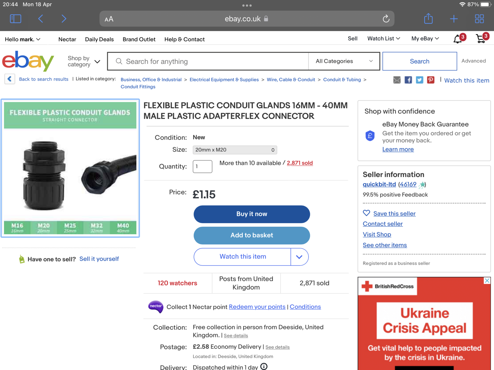

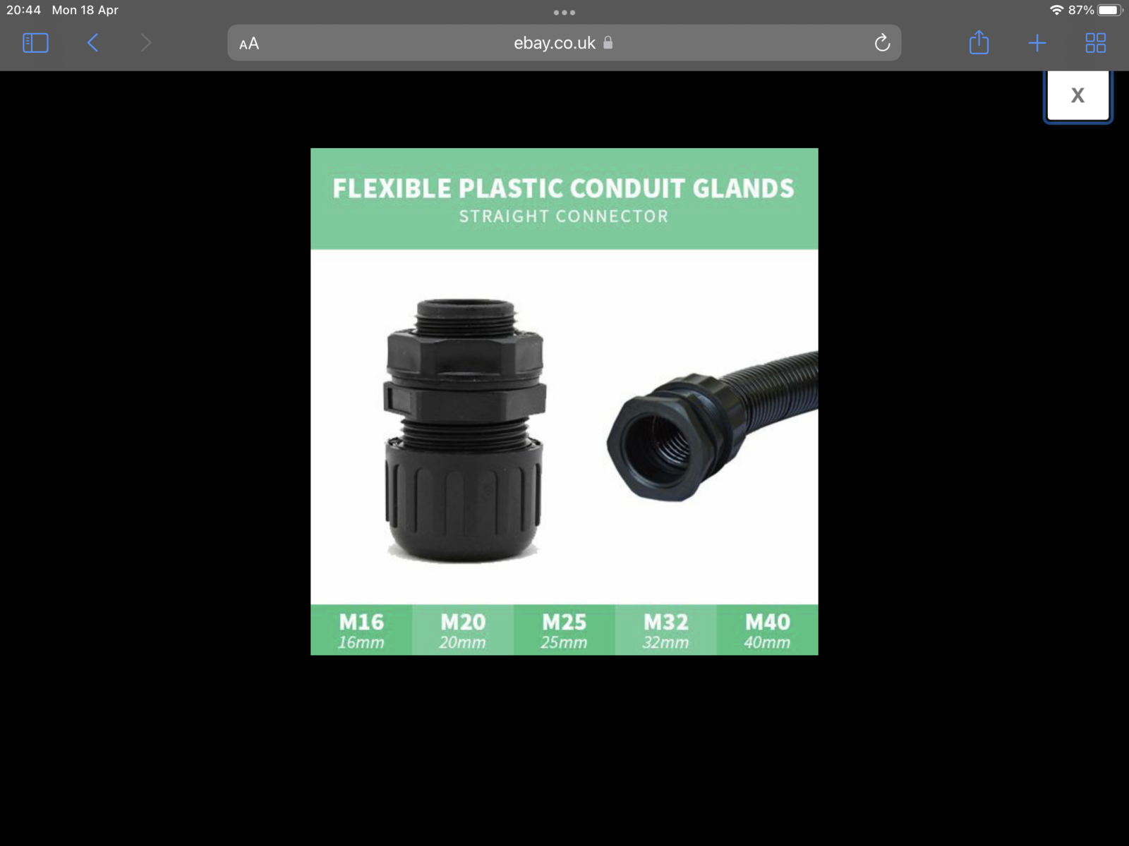

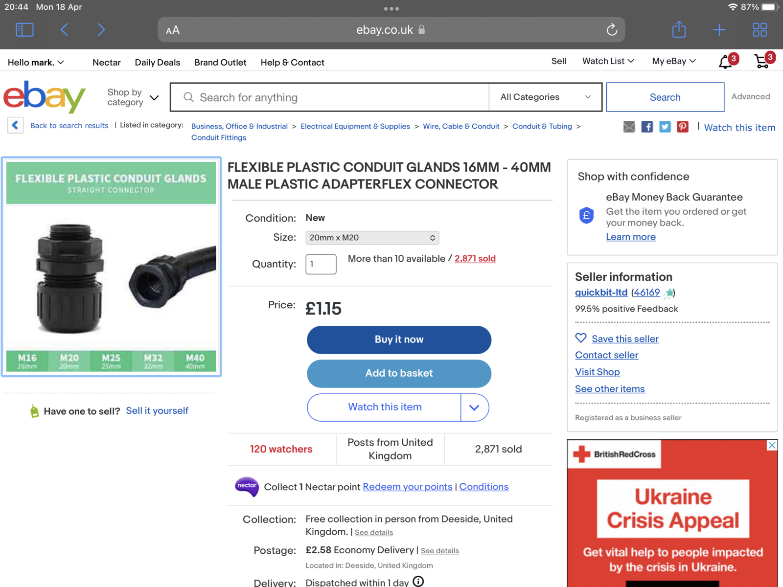

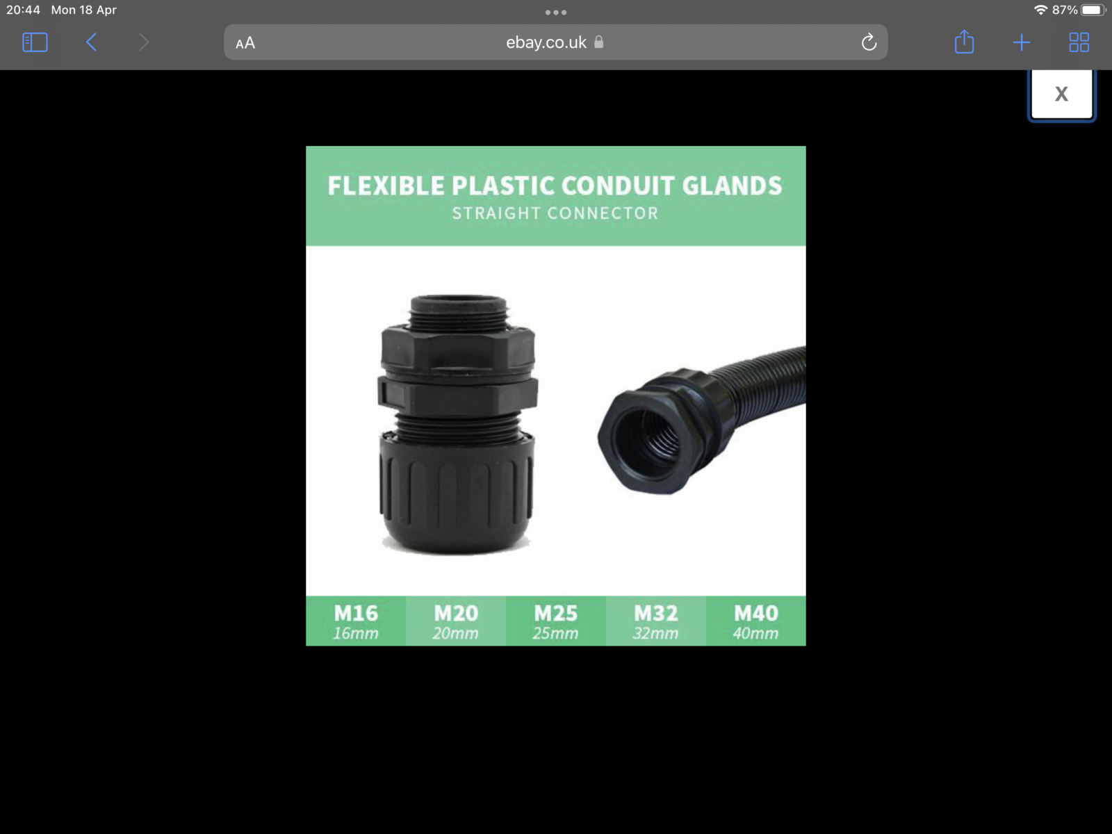

Apols if this is the wrong forum section but I know there’s plenty here that’ll know this. I want to terminate some of that black flex 20mm conduit into an IP65 box on the wall (in my case for cat7 Ethernet cable), any idea if you can get a gland/connector for this? I’d rather make a proper connection than just butt the conduit up to the underside of the box and silicone it.
Ta very much for any words of wisdom (y)
If you buy a contractors pack of flex conduit the glands come with it, they are also available as a separate item, Toolstation have them
Thanks, I just got the coil, no fittings. Any idea what they’re called? Think I’m searching for the wrong thing
Be aware that unlike most rigid conduit, flexible conduit comes in various types and is not standardised across different manufactures. Unless you buy the specific glands for your conduit there is no guarantee of a good fit
70C59AB5-2439-4C09-A3B0-8CC84B4FE24C.png 7E833E13-F246-49EA-8E4D-8065936F15EA.png
