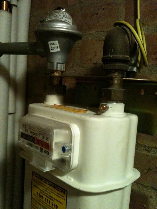

Hi All,
I have a gas meter and, during a house survey (I am trying to sell my house) the surveyor noted:
"No flexible connection to the gas meter". This has sppoked my prospective purchasers.
Looking at the attached image, is there something that needs to be done? And if so, is it correct that Nation Grid will do so, without charge?
Cheers all.

Getting National Grid to do anything is likely to be near impossible unless its either leaking or faulty. It may not comply with current regs but until they have to change it they wont.
My service pipe/governor dates from town gas days, the National Grid guy who came to fix a leak (that National Grid caused changing the meter....) said it was unlikely anything would be done unless it started leaking....

Surveyor has not got a clue a meter can be solid fixed on both sides, send him a bill for your time and his lack of knowledge .
I would imagine when the NG guy turns up he will just say thats perfectly ok and better than an anaconda and not change it

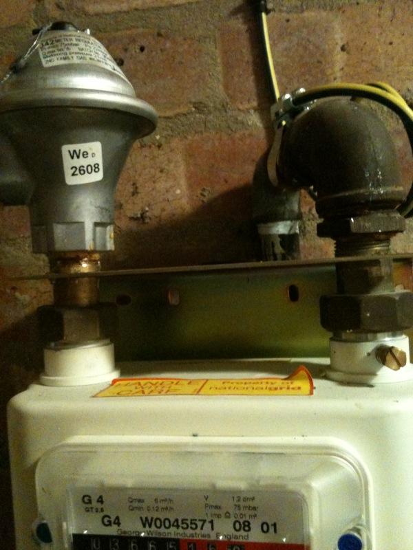

The meter is currently reliant on the fixed pipework for support. Fitting a hose on the inlet without securing the bracket to the wall would be a retrograde step.

What I suspect may happen is that the guy will turn up, but although nothing may be wrong (enough) he'll get paid more if he does more. He can't alter the outlet pipework ( which isn't his, so he'll only join up to it) but he could fix the bracket to the wall, which would then probably need TWO flexible connections.
DO tell us what he does :LOL:
Two flexible connections not allowed. It's in the BS somewhere...
I believe it is if the meter bracket's properly fixed to the wall.
BS6400 2006,
8.9.2 says "only 1 pliable (semi rigid) connection shall be used" on a meter installation, with ref to 8.6.1b for reasoning which is to minimise movement and reduce risk of tampering.
