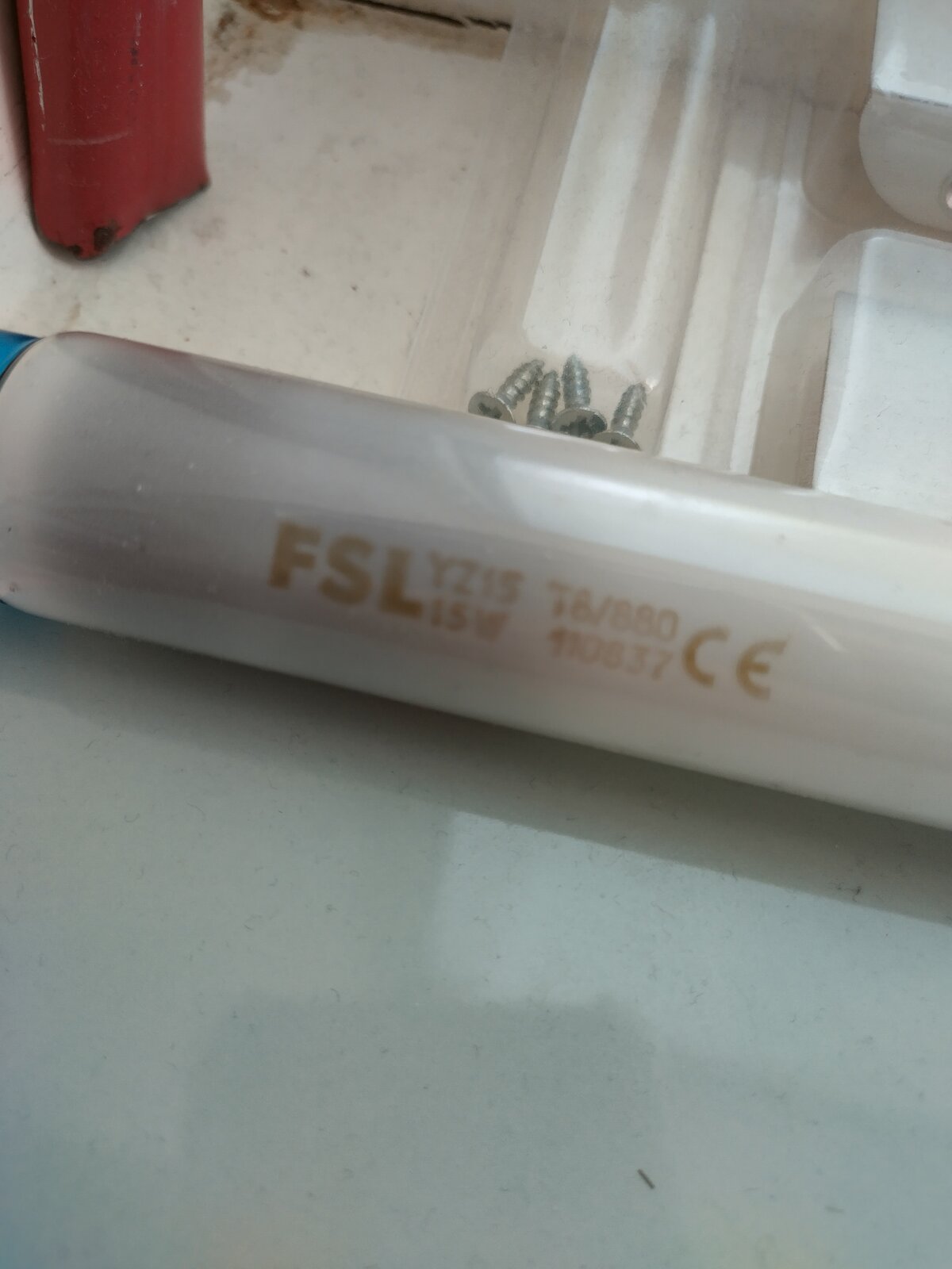

I got some white 15W tubes, but not the same colour. Couldn't find 880.
One side works, the other doesn't. Swapped the tubes. Still nowt on the RHS.

880 (8,000k) is a very rare colour to find and is an extremely cold, blue-grey colour. 840 or 860 tubes would be better suited anyway, depending on your preference- 840 being a neutral white and 860/865 quite a cold blue light.

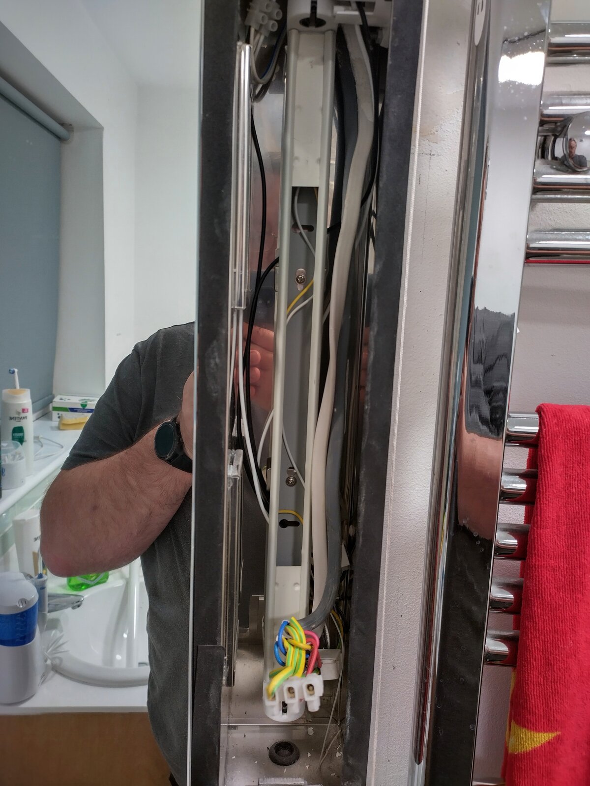

I have opened up both sides of the cabinet and there are no starters and no obvious control gear.
Unless the control gear is hidden in the ends of the fittings. It's the only place it could be.

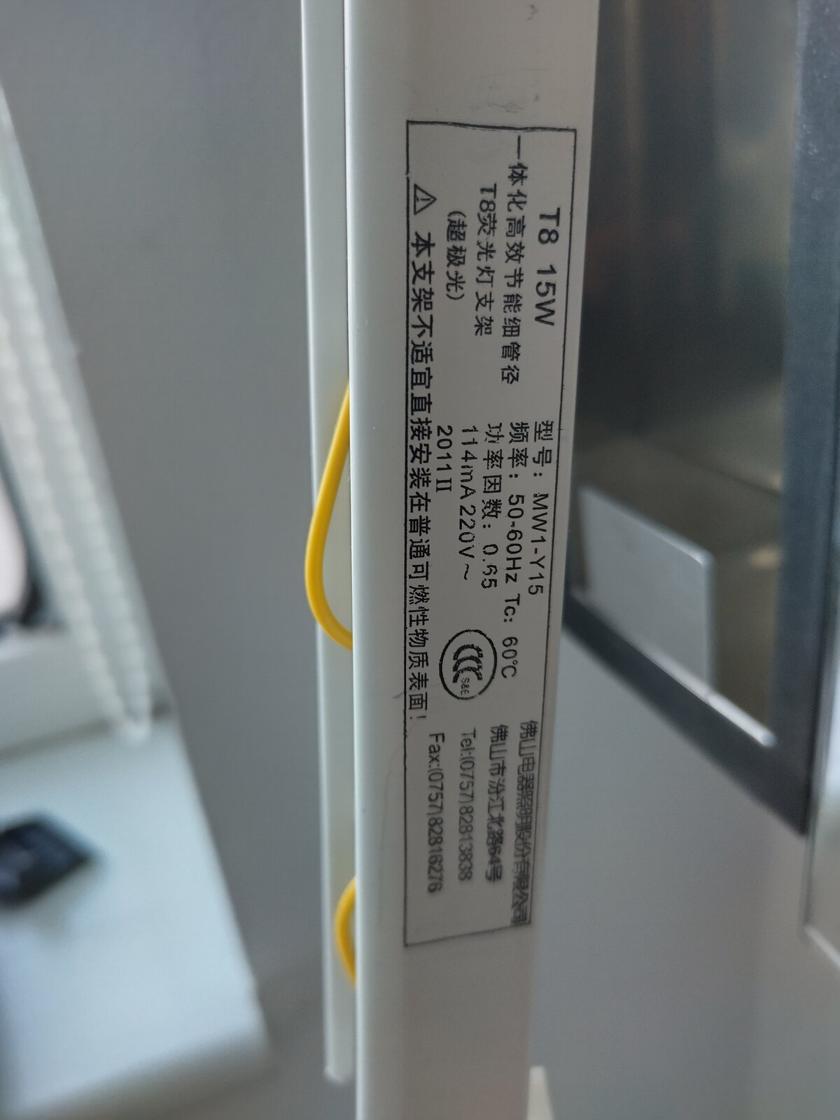

Well, I couldn't get a view with a dental mirror as the guts was shrouded, so I took a deep sigh (and a screwdriver!) and removed the fitting and then I had to pull out the end cap which was attached to a plastic housing enclosing the "guts".
Re-fitting the thing was fun, even with a magnetic driver. Ended up going the magnetic driver route, fortified with Blutak.
They look extremely unsubstantial.
I'm the era of large heavy laminated chokes or at least a fairly chunky box containing HF control gear, but this takes the wee wee.
