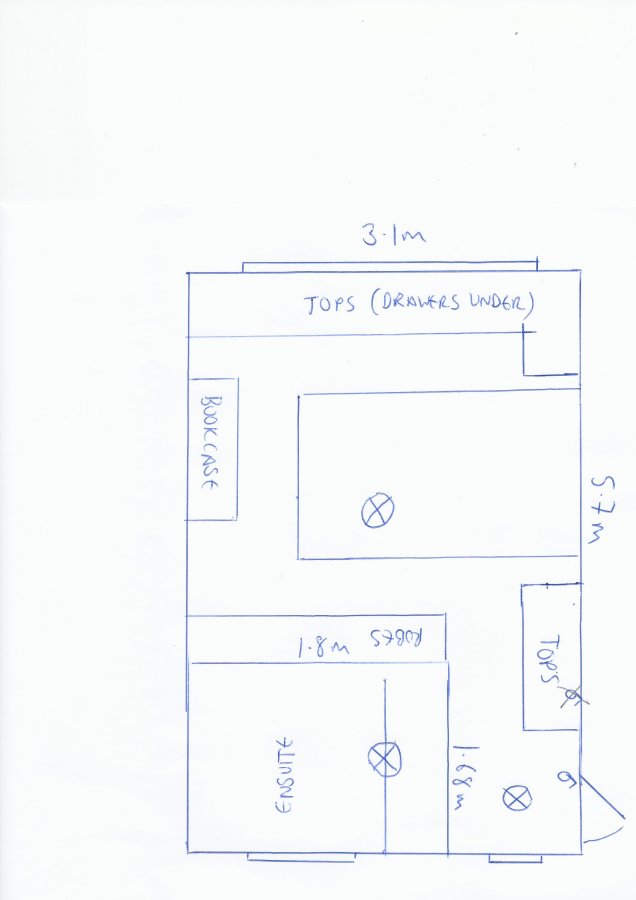

Still researching this.
Found an MK euro module plate that is 6 mods. K185 WHI. Scolmore don't seem to do one.
Then I can have the euro LED (2 mods) the 2 switches (2 mods) and a couple of USB's (2 mods).
Funny thing is, MK don't list a metal box for it. Just a pattress or drylining.
But I guess K863 is the right one.
And I guess as a few manufacturers do Euro accessories, their modules and plates will be interchangeable?
I'd quite like a BG Nexus USB module as they do a 2 module USB with 2 sockets, rather than Scolmore who have single mods, so there would be a join.
Scolmore seem to have the only LED module suited to a 35mm box, rather than 47.
So that would be an MK plate, BG USB mod and Scolmore LED mod & switches...
All the components would be white, but I guess the danger with mixing mods would be different colours and finishes?
