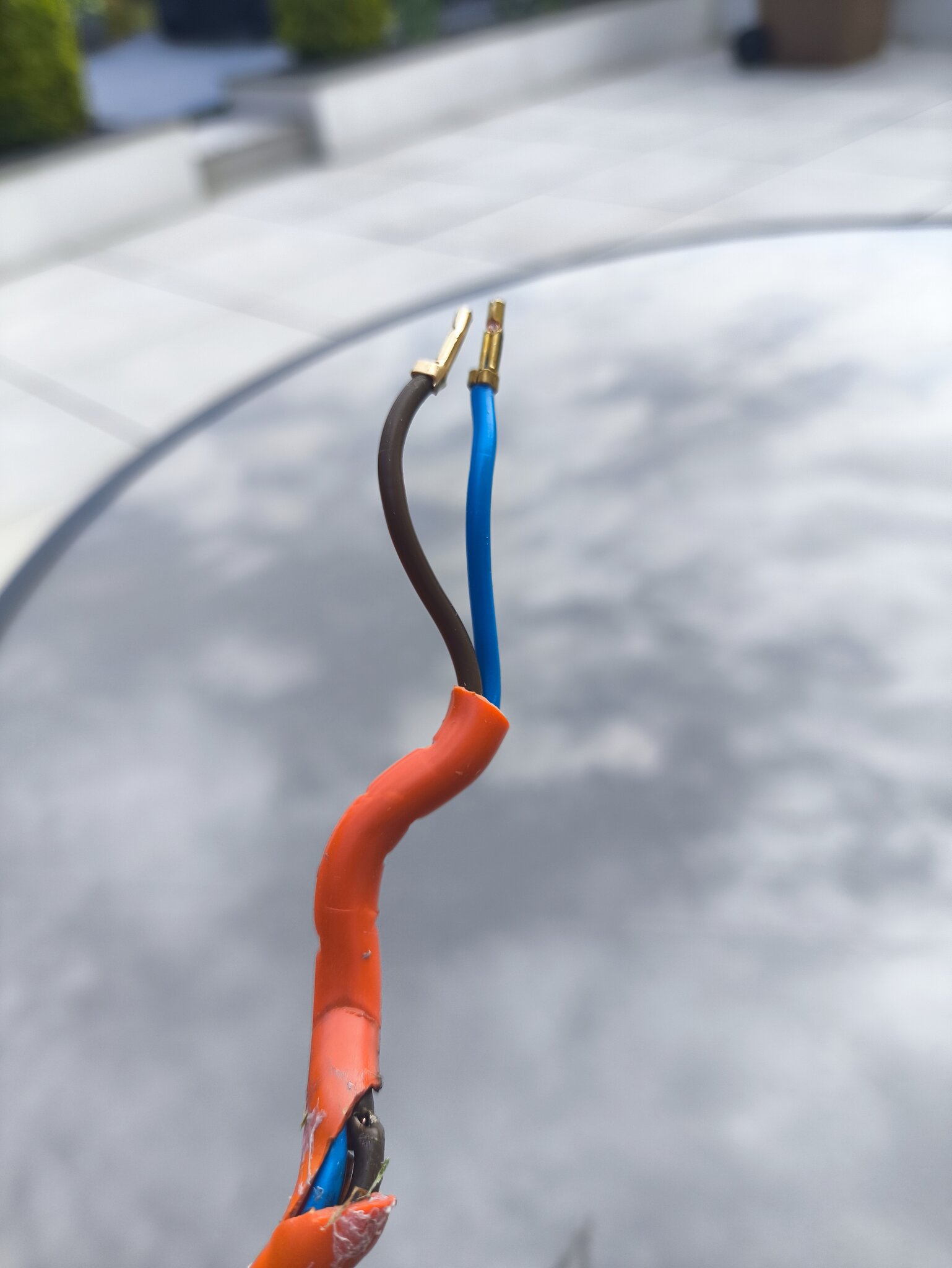

My cable has went this morning on my flymo. On opening the switch unit I noticed the break that caused the issue. I plan to reuse the cable agter cutting back but my question is what's the name of the the small clips at the end of the cable and are they easily obtainable and finally really needed for wiring back into the switch unit

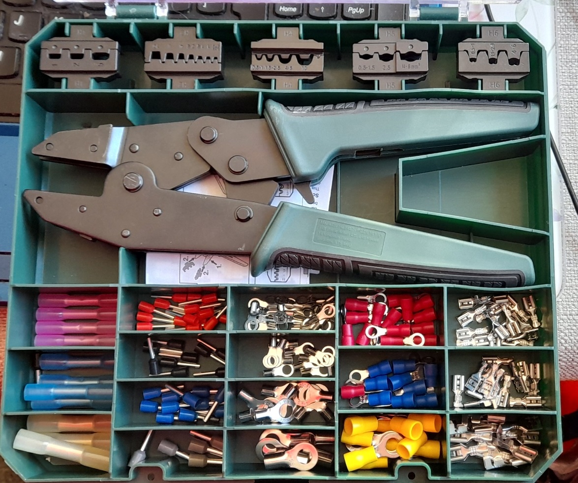

Ferrules but probably not essential in the repair.
Soldering flex wires in screw terminals is deprecated. Don't!
