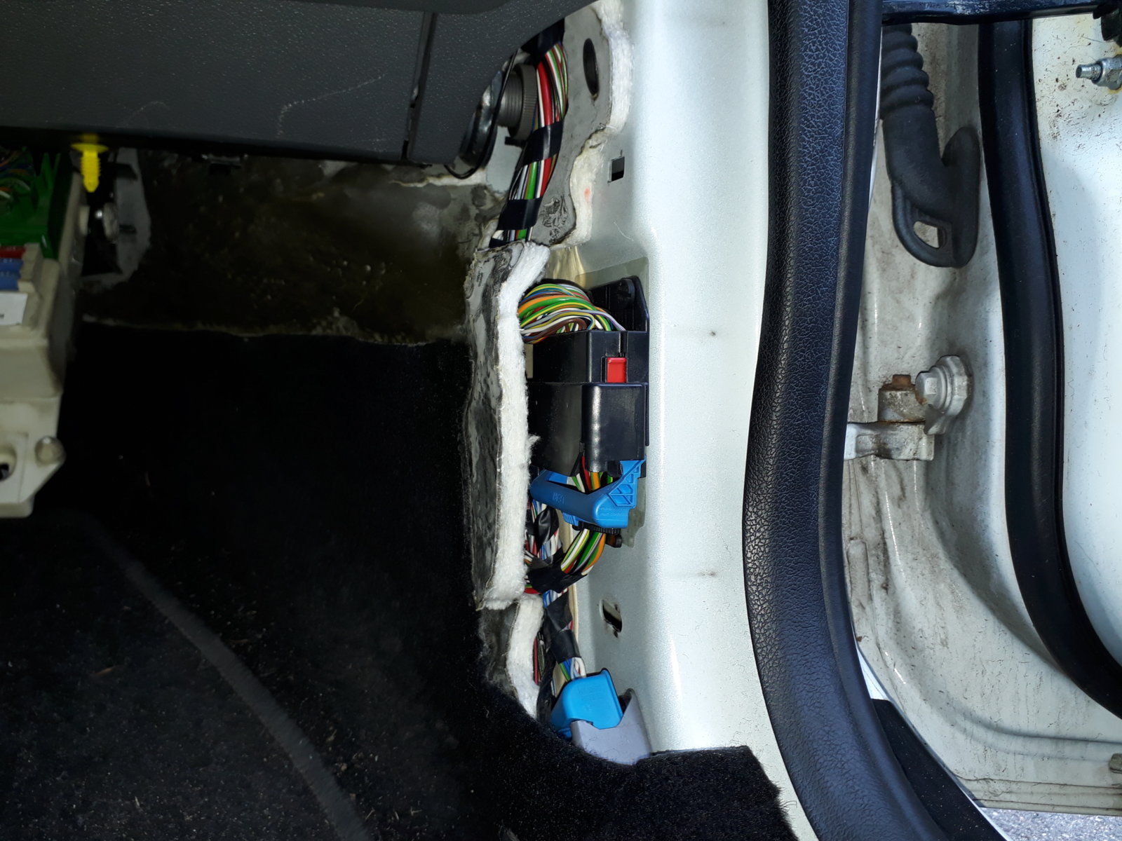

Hello.
Could anyone give me the location of the siemens box for central locking remote unit that's inside car.
I have . looked all over inside of car for this siemens box thing and I cannot locate it. The car i have is a ford focus 1.8 tdci. The year is 06 plate.
I have had fuse box out. From under passenger side.
I have checked under bonnet.
I have taken plastic trim off under steering wheel. Where fault code reader plugs in. Bit I cannot locate this siemens box.
Any help would be appreciated.

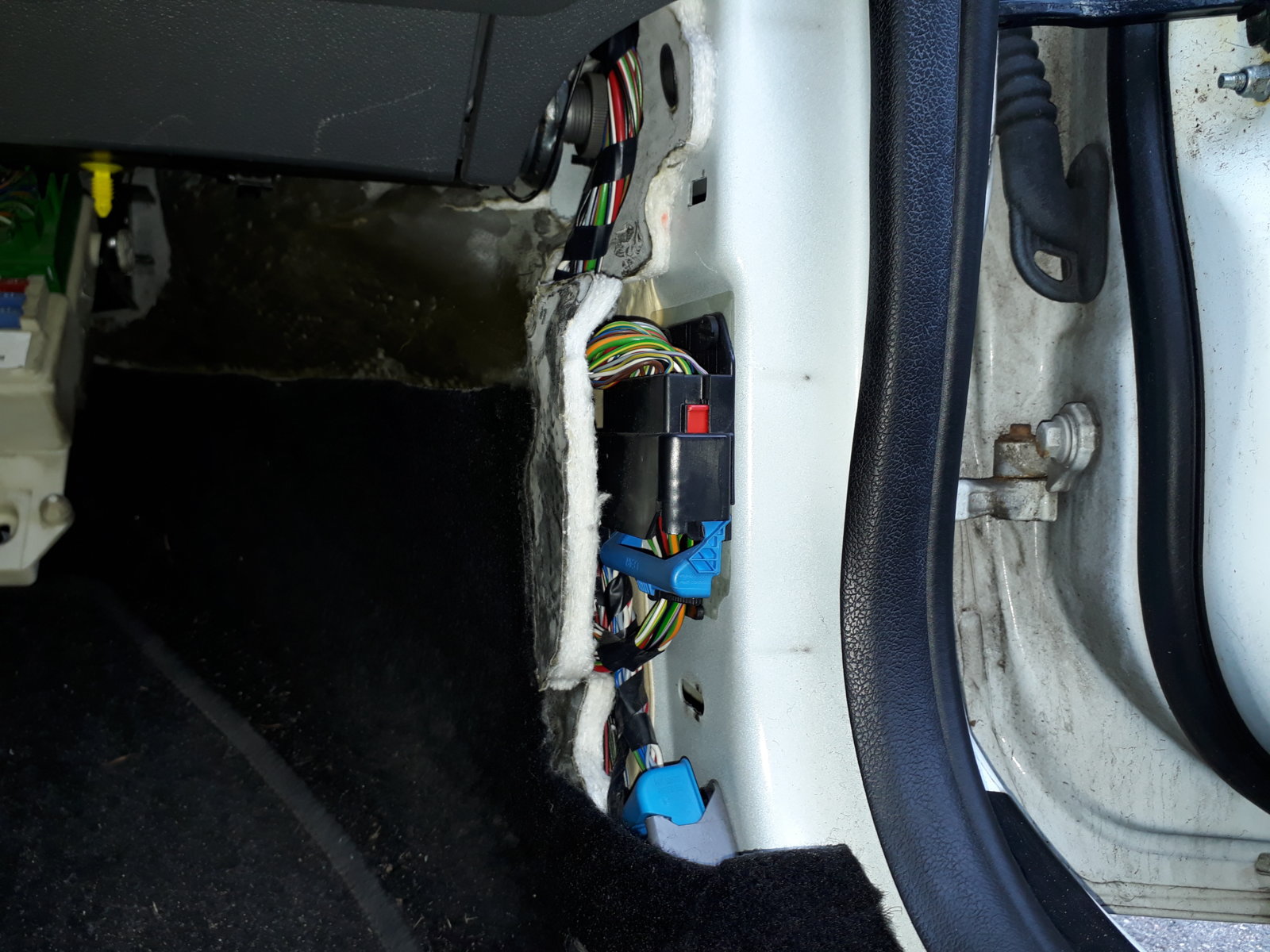

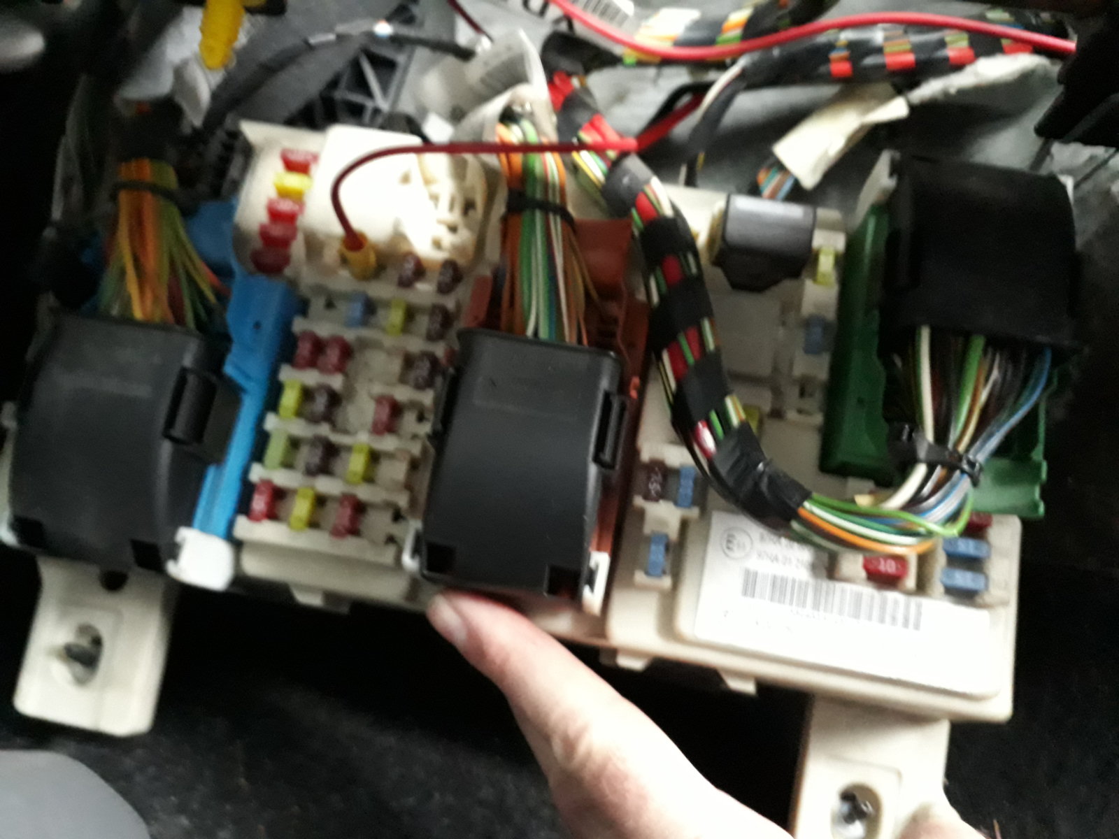

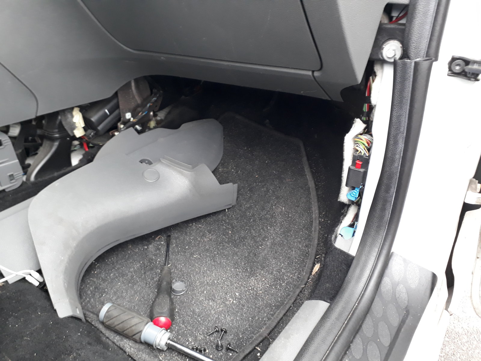

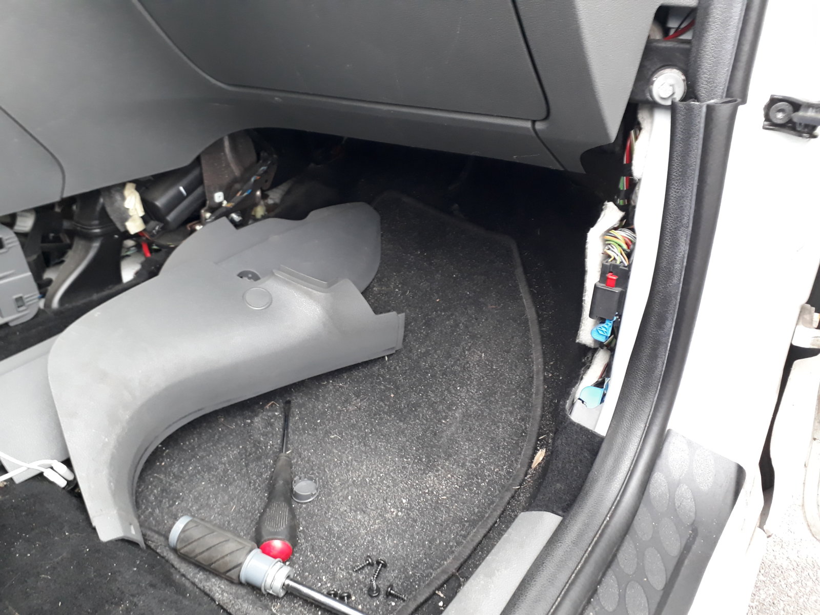

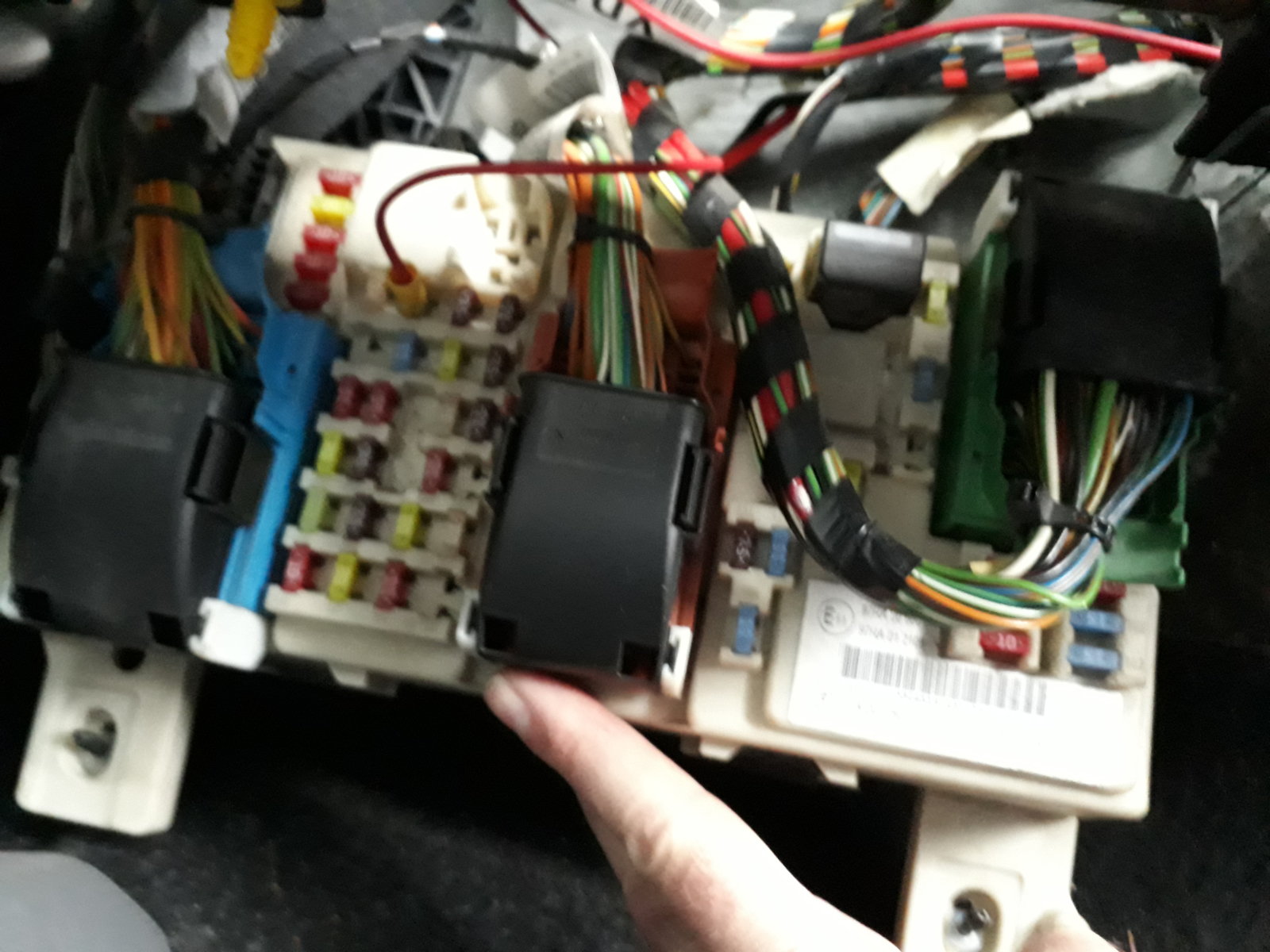

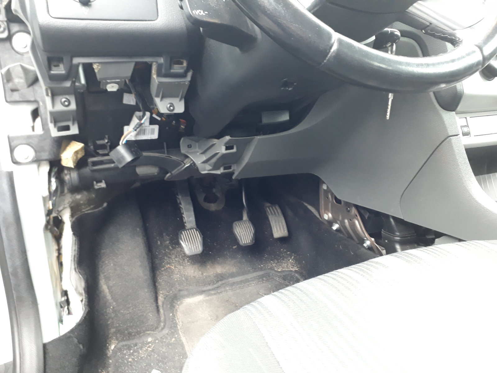

I have a 2008 1.6 Tdci were the remote key has stopped working. Central locking is fine on all doors when I use the key in the lock. I have been searching for Fuse 63 and the Siemens control box, but I have not been able to locate either. My car has the steering wheel in the left side, and glowe compartment in right side. Fuse box is below the glowe box in right side, but there is no Fuse on the "back". All fuses is on the front. I have removed some of the plastic trim to find the Siemens box, but no luck. If anyone has any pointers plz. let me know.
Bo
