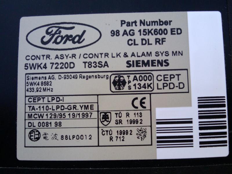

Then I did the above and pulled out the two plugs (green and blue) from the Siemens "CONT.ASY-R/CONT LK & ALAM SYS MN" box and kept it unplugged for about an hour.
I then plugged the connectors back in and lo and behold the remote worked perfectly!
I can now unlock my car using the remote fob from across the road - something which I could not do before!
FYI the part no. for the SIEMENS box is 98 AG 15K600 ED Picture attached.

know your feeling as i bought the car secondhand i dont even know whether it should have a key with a fob although from the picture i took of the unit I would say it should as part of the text on the unit says alarm sys.

Not sure whether you can see the image i took of the unit in question as i have not added a folder and clicked view image before?
