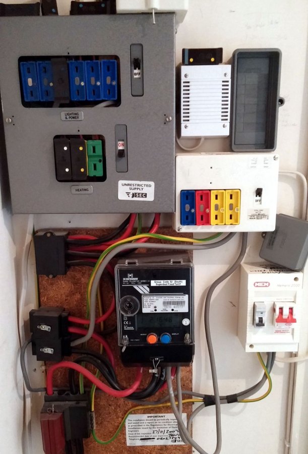

This mess will be removed and replaced shortly.
Nothing has been changed yet other than removing most of the fuses.
Despite the apparently large number of circuits, this is for a 2 bedroom flat.

It's a mess. Apparently partly installed by someone, and then finished by others and subsequently altered by yet another.
Original construction was early 1970s, the white Wylex probably 1980s, the MEM unit 2003 (date on the inspection label as the writing on that and the top of the MEM unit are identical). Both bathrooms totally refitted about 5 years ago, everything else original.
Most of the wiring is PVC singles in concealed plastic conduits.
Obviously no documentation of any kind.
The metal board was designed to have regular circuits and night heating in the same unit - all of it is is now powered all of the time.
The white 4 way Wylex is switched for night heating, and the small MEM unit is switched for off peak hot water at different times to the heating - meter has 3 outputs.
Starting at the top 6 way 15A row, the circuits actually are:
1&2 have nothing connected
3 is the doorbell transformer.
4 is a single socket in the lounge with surface clipped T&E along the skirting boards.
5 is the daytime boost for the hot water.
6 is one of the bathroom towel rails and both bathroom wall lights. Rail has a 3A switched FCU, wall lights wired direct with their own built in switch, no additional fuse. Bathroom wiring is new blue/brown colours, yet no RCD anywhere.
3 way marked 'heating':
5A Lights, plus one of the bathroom towel rails.
20A socket outlets, wired in what was probably intended to be a ring but is actually a ring with radials off of it. The kitchen has the ring at one end, and a row of 3 double sockets taken from it as a radial, all like that from the original 1970s install.
40A cooker, this is a cartridge fuse unlike all of the others which are rewireables. (Only one wire connected, the other apparent wire is the brass neutral block behind)
The 4 way white box is for 4 separate storage heaters of various sizes, the 30A circuit is in 2.5mm and supplies 2 separate outlet plates in different rooms, but only one was in use.
The MEM unit has a 16A MCB which is for the off peak hot water.

Would I right in thinking some circuits have been jointed in the large metal clad cu, and extended to the white Wylex?
Purpose built flat, right?
That makes sense about the 45/40amp fuse - looked like two wires but you can see the edge of the neutral block.
Certainly some unexpected bodges further down the wiring, most of which hopefully can be overcome by the consumer unit change and lower sized MCBs.

Cumon guys --- have you all missed the unmetered input to the meter where the insulation has been cut back to permit "bypassing" of the meter
