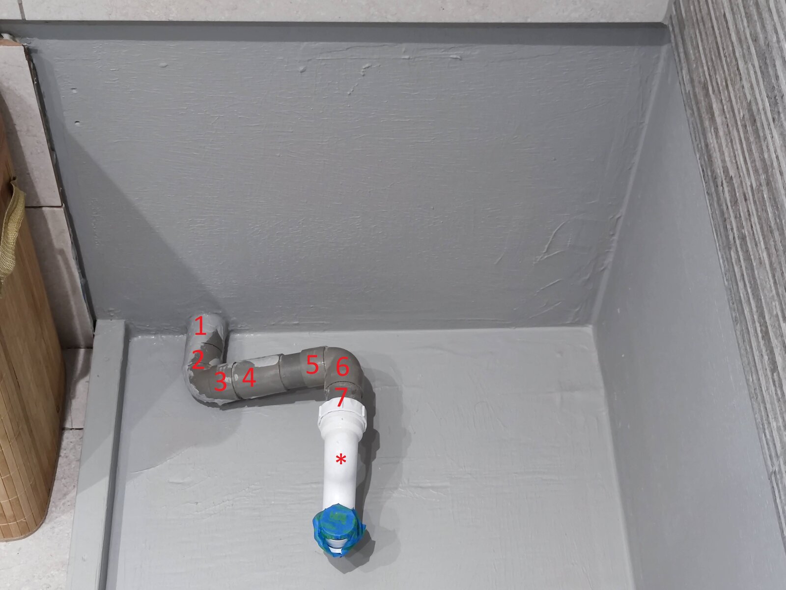

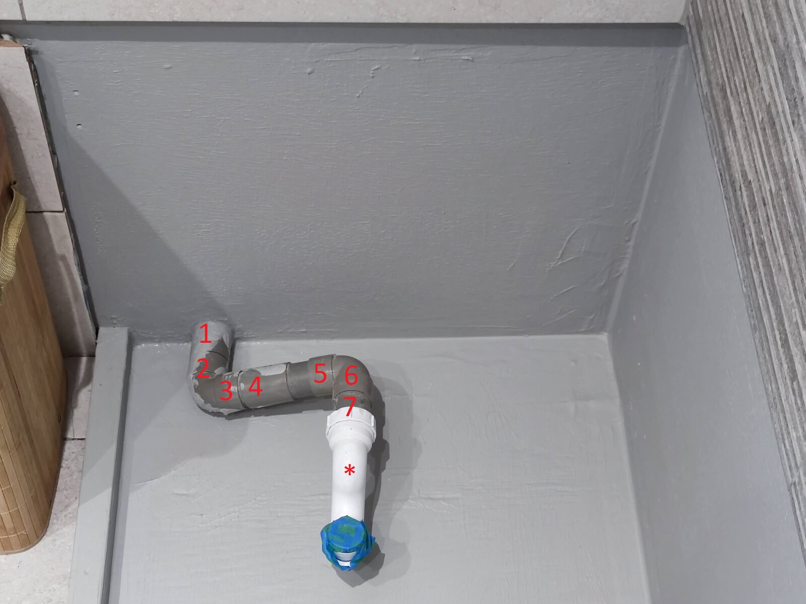

Here is the picture (BTW - I should have done this before doing the tanking...).
The new drain will be where the red * is on the picture, about 6cm closer to the wall than now. About 3-5 cm higher.
I can push the white trap 3cm closer to the wall, but not more, due to the 90 degree elbow.
Ideally I would dethatch 1 from 2 and redo the whole "zig-zag", but if I cut the two parts (that are linked with an insert), then I will need to find a way to remove the half of the insert that is glued inside 1.
If I could twist 1 and 2 so that they dethatch leaving the insert one piece and attached to either 1 or 2, that would be great, but being so close to the wall I am afraid that this could break where I can't repair it.
I could replace the elbow 5-6 with this (https://www.screwfix.com/p/floplast-conversion-bends-90-white-40mm-5-pack/73715) to get closer to the wall those 6 cm, but again - I am not sure how detach from part 4 and even if it works it won't address the problem of having the drain higher from the floor.
Ideas?

Bit of a tricky one that, am I understanding corectly the existing pipe work is 32mm?depending on what's on the other side of the wall and how intricate the waste is I'd be tempted to rip a new 40mm hole in the wall central and go straight out (assuming it's a straight 90 into an outlet or something, but if there's loads of pipework feeding into it or a long onward run , not ideal.
From the picture the star is quite a lot further back and I'd be worried about clearance to that wall and fitting your new pipework in a good manner. My first thought is source a stubbier waste?
https://www.screwfix.com/p/mcalpine-bottle-bath-trap-white-40mm/21158
Second thought is, since it looks like you'll have a removable panel for access AND you've tanked it - I might take back what I said about using a flexible bit of pipe if it helps!
It is 40 mm and on the outside it is welded to other 2 angles, so I wouldn't want to touch it.

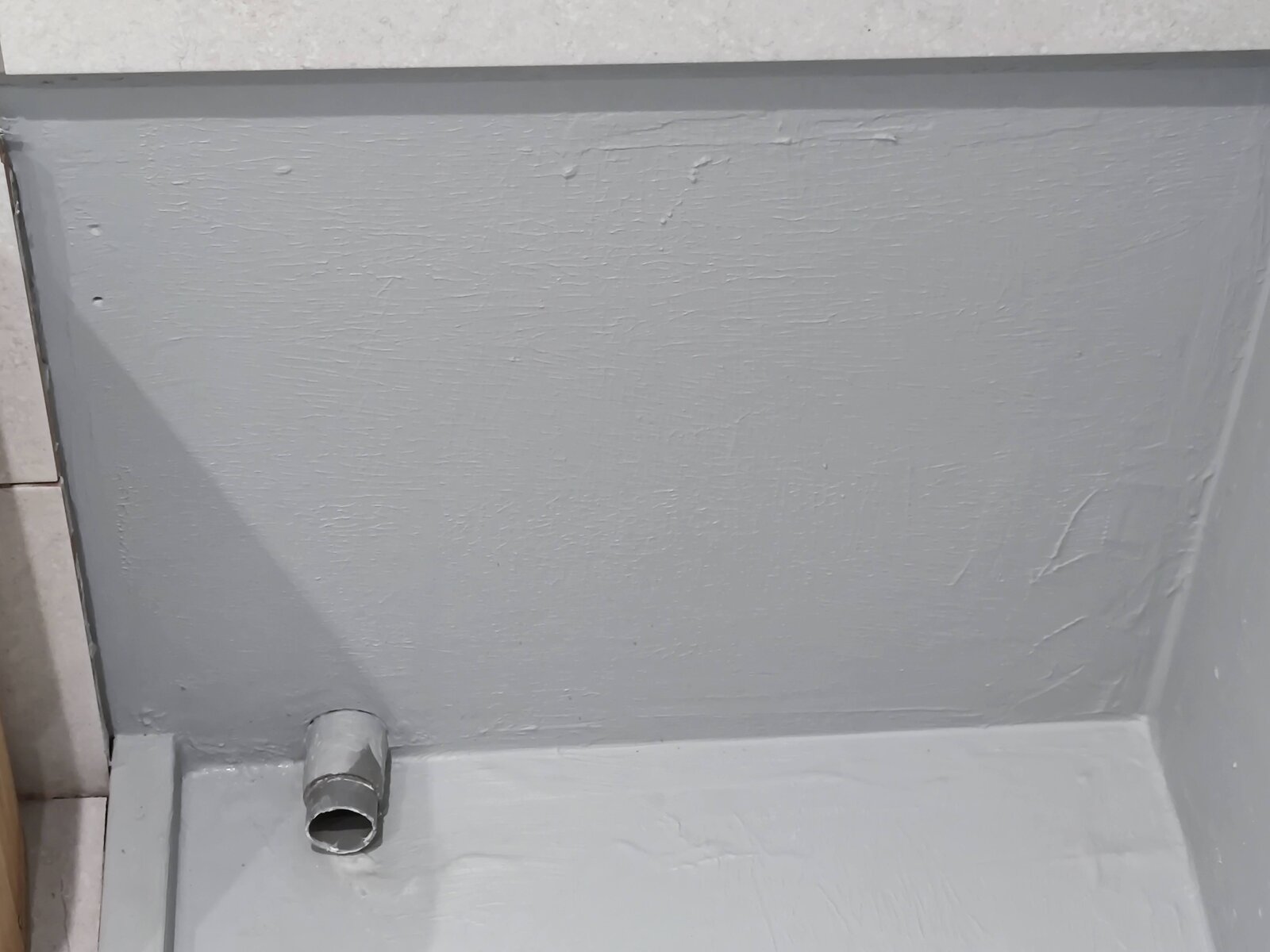

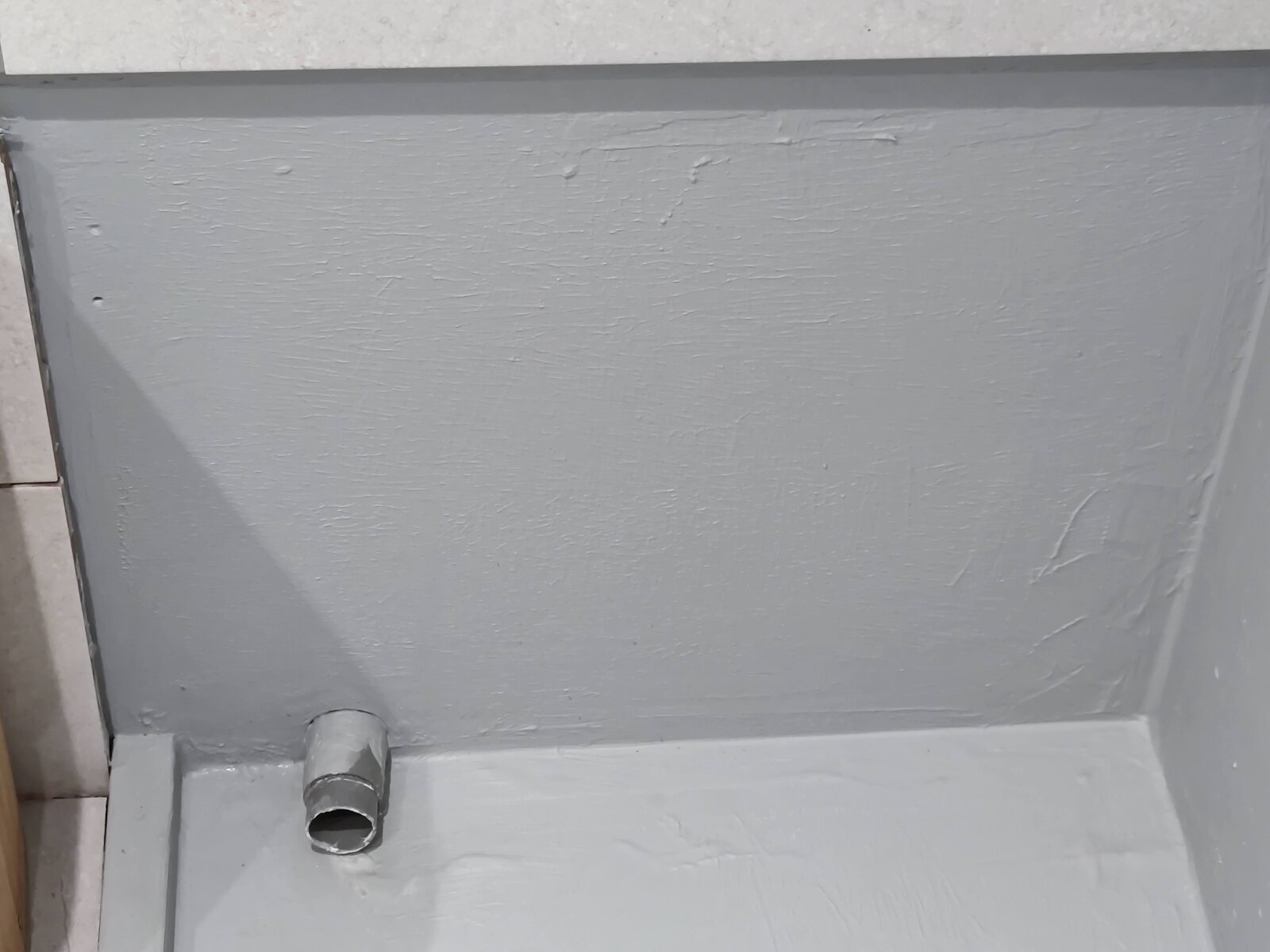

Anyway I gave a try cutting sections using a multitool and then trying to break the smaller parts with a flat screwdriver during the lunch break (the pleasure to work from home ;-)) and I managed to remove as much as I wanted.
It seems the parts weren't welded so well (or they used simple glue).
