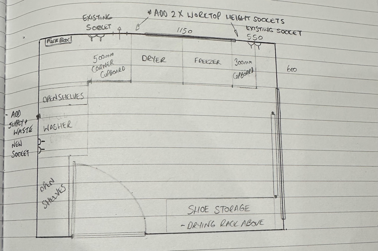

I’m planning to turn our study into a utility room. The consumer unit is in this room and I was planning to place the washer reasonably close to it. Is this forbidden by any regulation?
It is still accessible.
I’ve attached a diagram to help.
The main reason for the washer location is that it would back onto the WC sink drain.
It is allowed to have a washing machine in the same room as the consumer unit. The rules are about access and moisture risk. You must keep the consumer unit accessible, typically clear space in front of it and no appliance blocking removal of the cover. The washer socket should be RCD protected and not directly under the consumer unit. Keep sensible separation so leaks or steam cannot drip onto it. If access stays clear and electrics are protected, regulations are satisfied.
As others have said, nothing to say they cannot be in the same room. The socket for the washer and dryer is behind the washer which is where it would need to be. All my circuits are protected.
An electrician came out this week to install 2 extra sockets for when I’ve installed the worktop.
There is only a base unit in front of the CU so it is still accessible.
