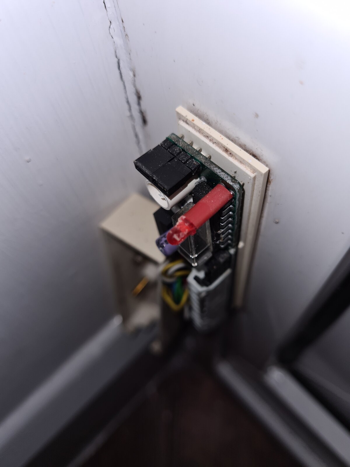

I've moved into a house with an ADT Galaxy 2-20 system (v1.10). The system seems to have developed a fault with the Viper shock sensors which won't allow me to set the alarm. When I view the status in the menu system the other sensors show the resistance (eg. 23 ohms) but the shock sensors show as O/C. The sensors used to flash yellow/red but do nothing now. It appeared to start after I washed one of the windows. The casing is in pretty good condition but could water have penetrated and shorted it?

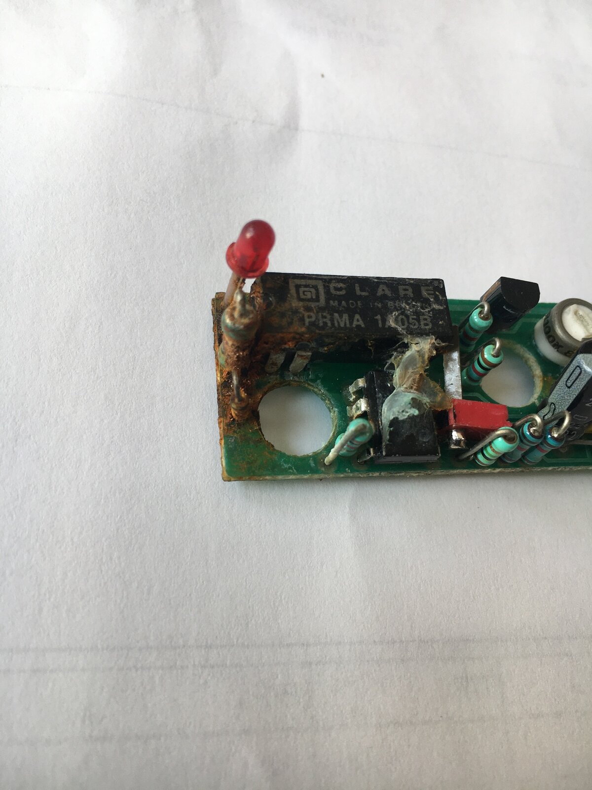

I would take the viper case off and inspect for water damage ....found this one on a service ...
That looks bad! Nothing obvious on this one that I can see.

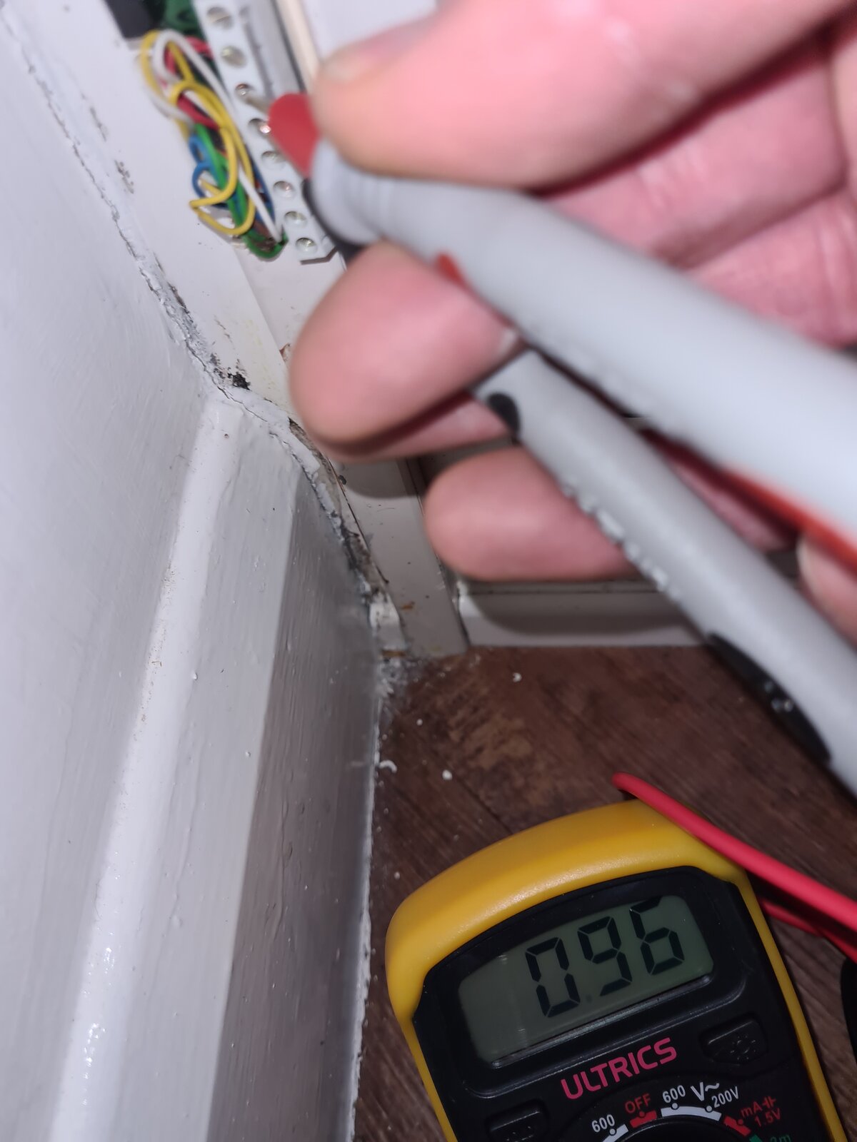

Set on dc range check for 12v on viper terminals 5/6 counting from the bottom where the metal link starts and the one above ...
Thanks very much for helping me out with this. Is that right?
Cheers for the info Mark. Really appreciate it.

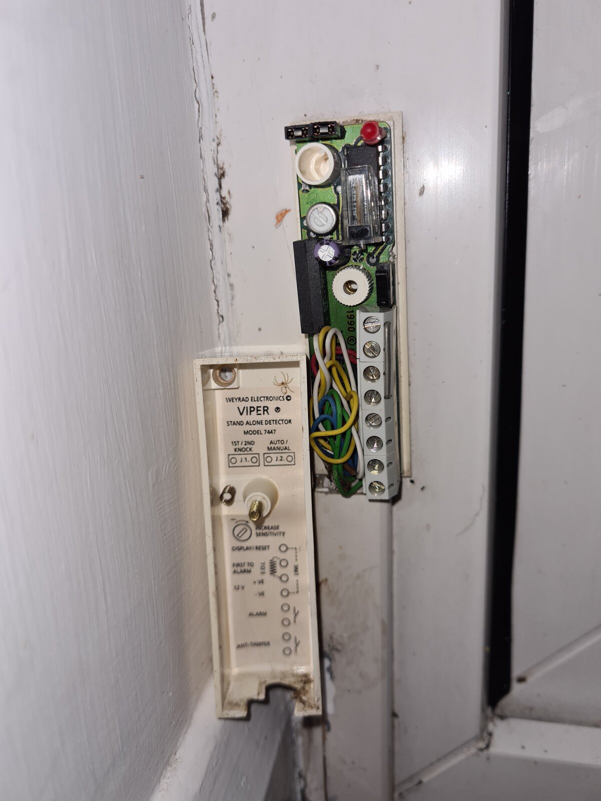

I can't imagine how the cables could have been damaged as they're so well protected in the walls and floor. Can I open the alarm box and replace the fuse or will this trigger a tamper alarm? Or is it time to ring an engineer?
Haha. I didn't even think of that as a danger! No, no alarm when I took the cover off the viper.
They seem to be wired in a series of four. None of the four have power.
