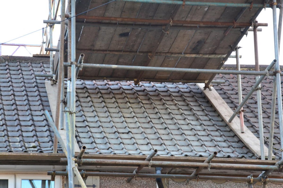

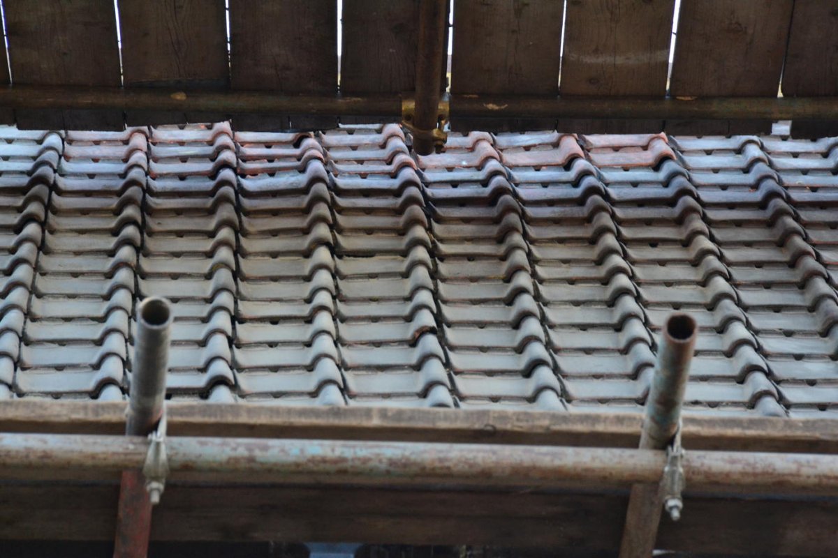

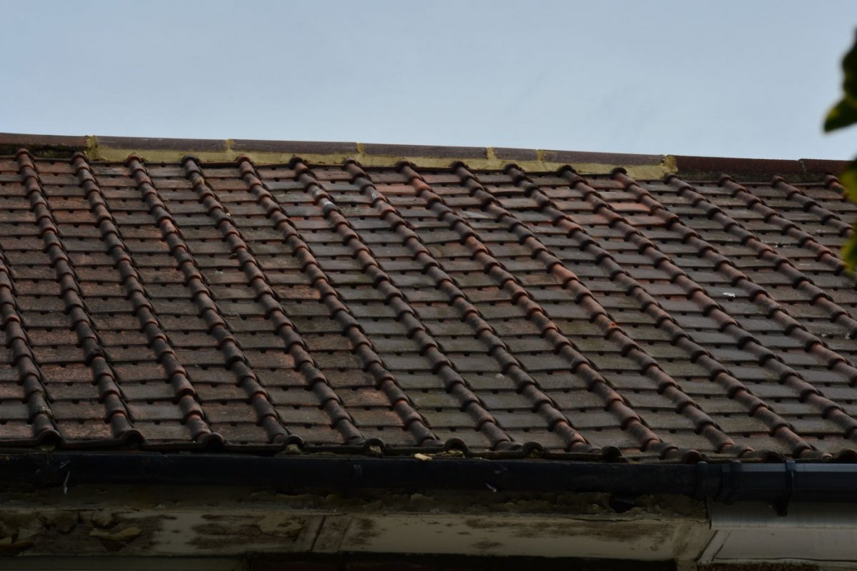

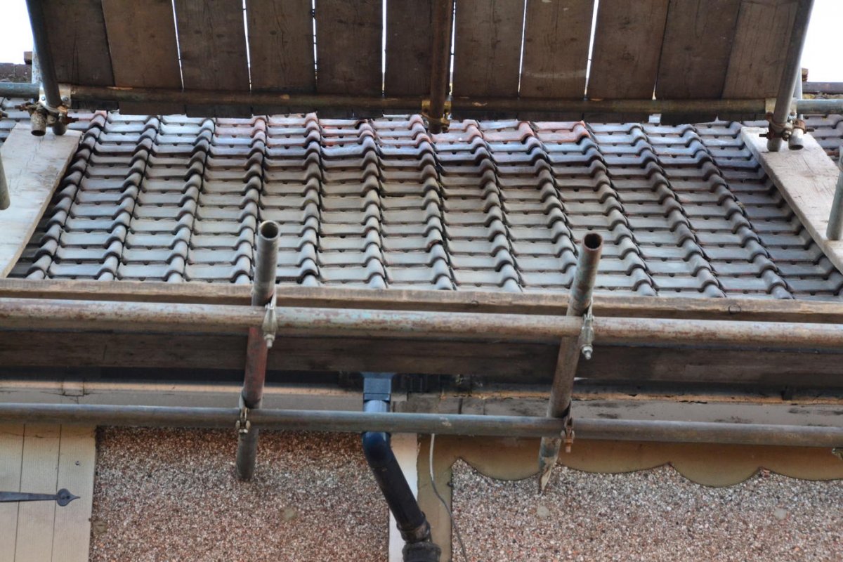

Gaps in replacement tiles after chimney removal
7 Aug 2016
38
4

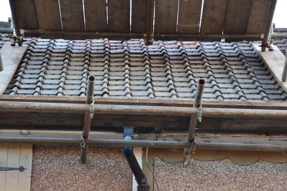

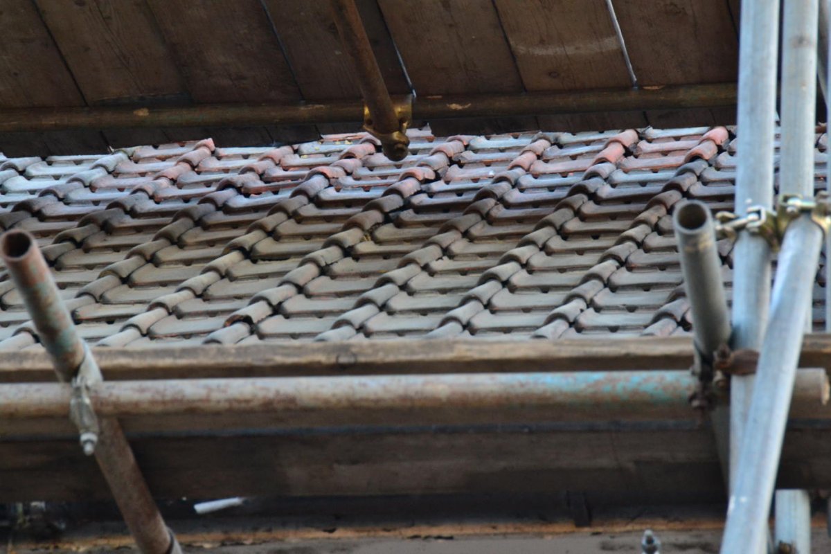

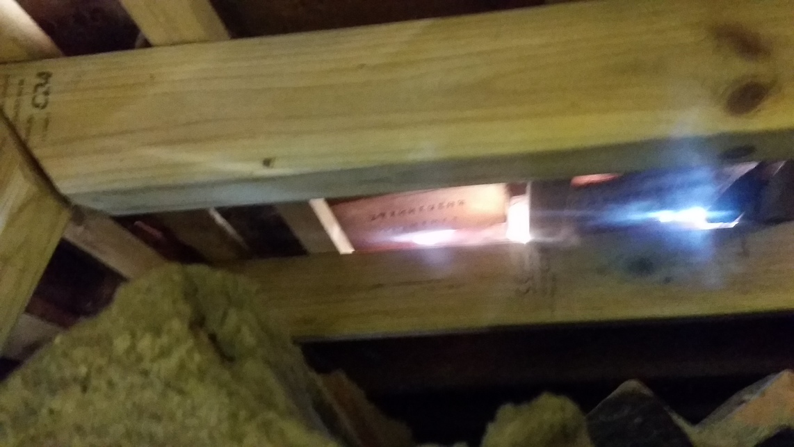

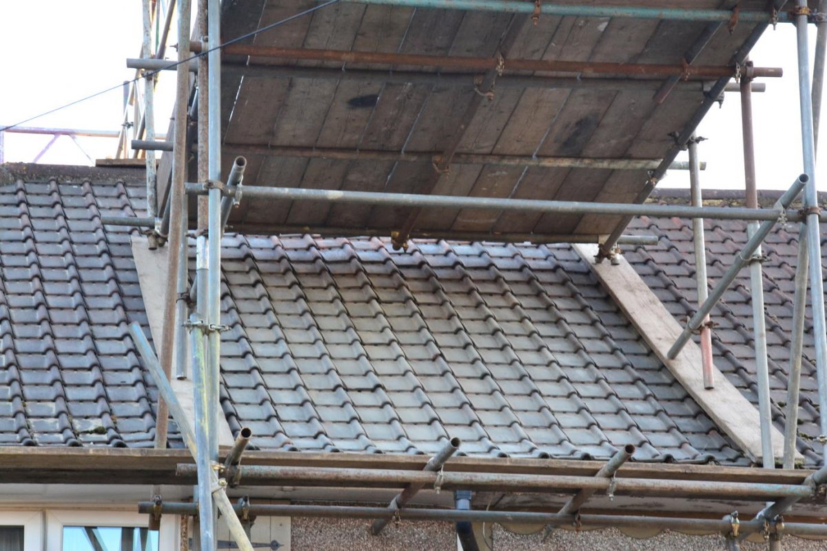

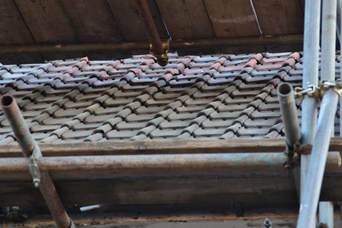

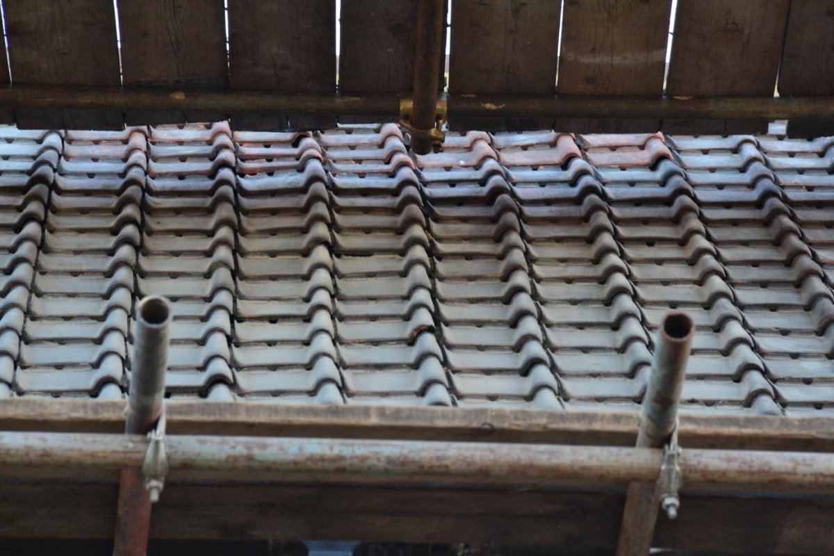

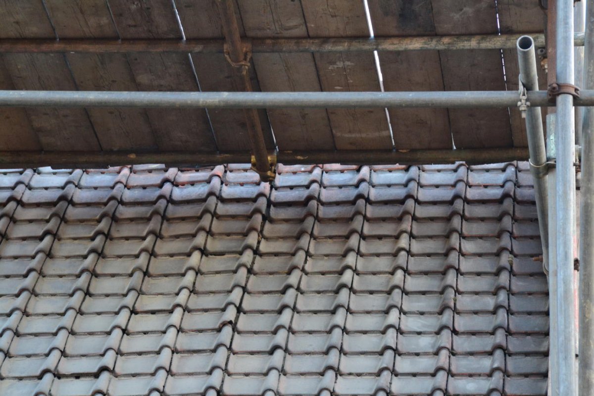

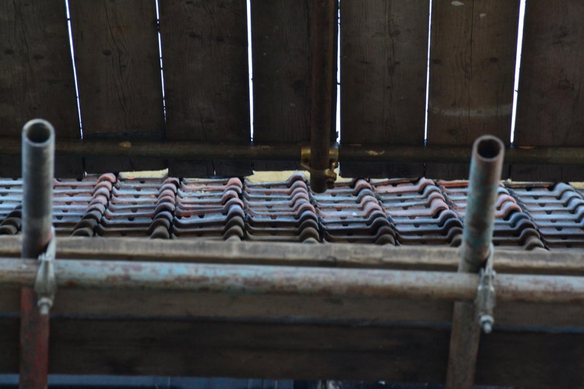

Hi recently had a party chimney removed. The gaps in the replacement tiles look far bigger than existing ceiling. Does new bedding look as bad as I suspect? Also the party wall is not flush to roof. Is there any regulation around this? Or should I fill gap myself with concrete? Or get builder to do it? The roofers left on Friday without saying they have finished. Scaffolding Is still up. I guess the boss will visit site next week prior to payment.
I emailed the boss. Their response:
" the tiles will kick as there clay tiles and will not follow the shape of your roof this will take time. "
Thoughts?
Images attached...

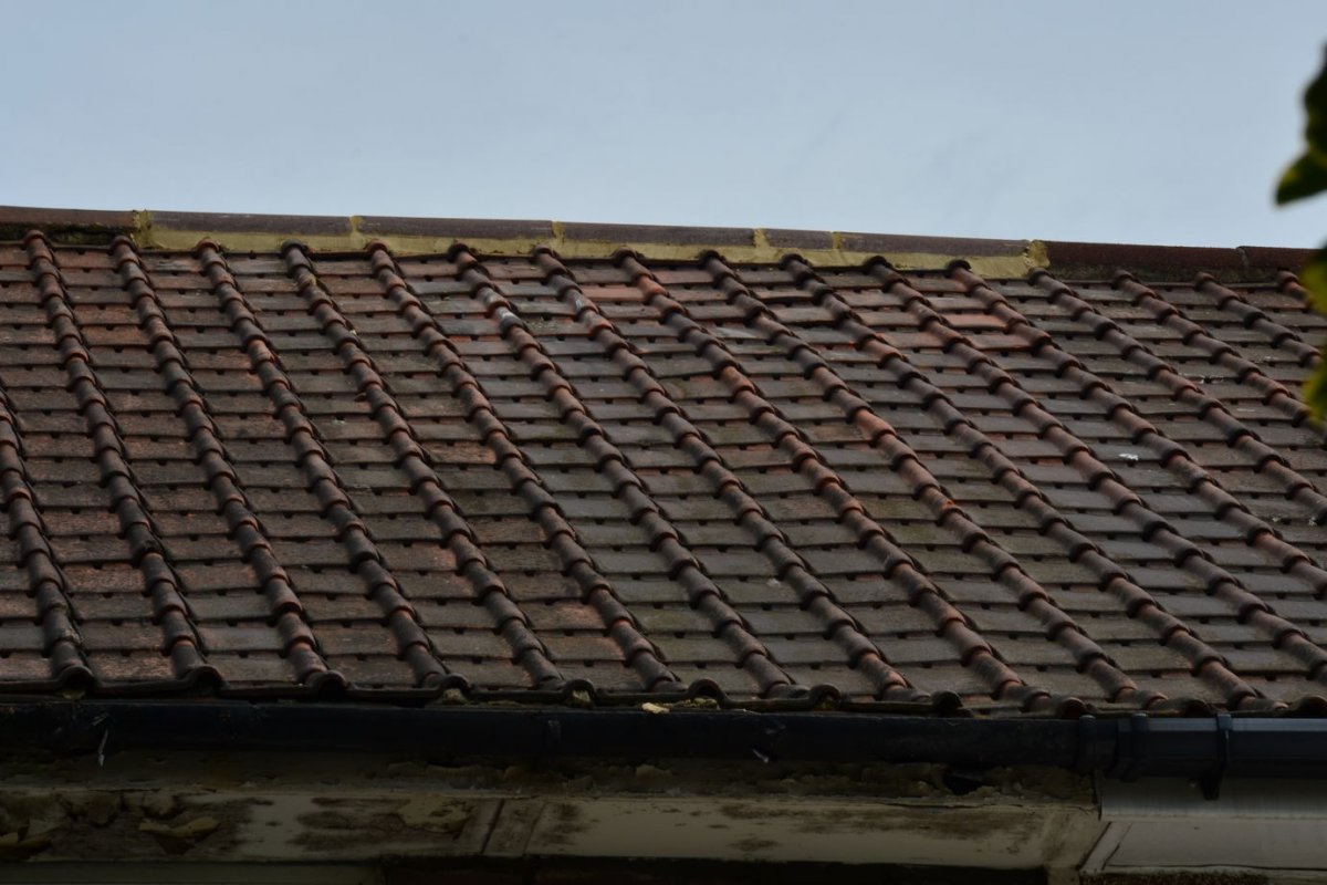

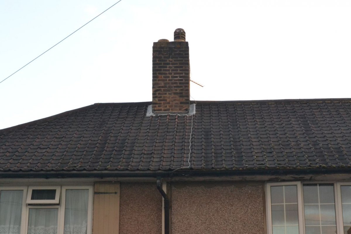

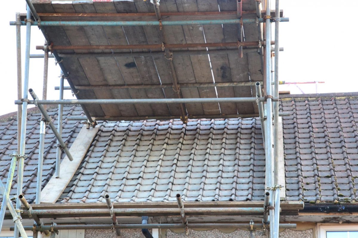

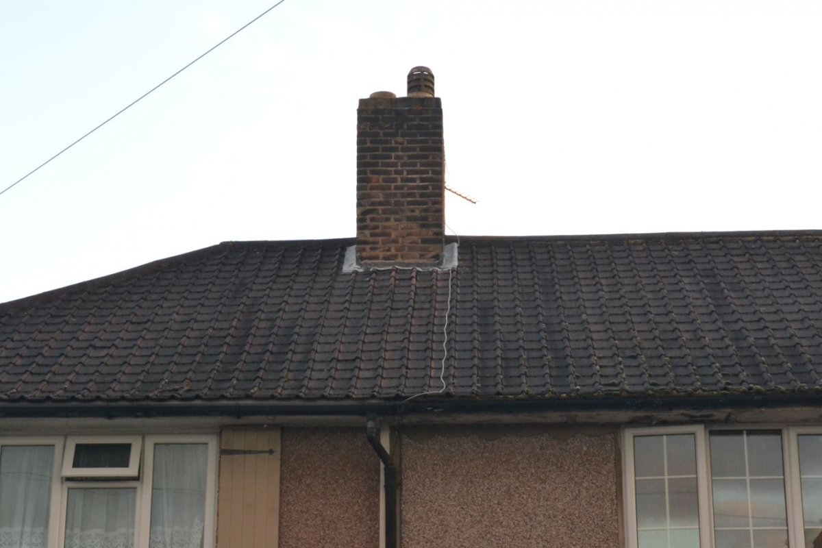

@catlad : Outside Pictures + 1 Before. - excuse my tatty soffits ..
@noseall : Is that pointing or something else? If anything was on the existing roof it has long since disappeared.
FWIW These are all 1930s ex-council houses , and the ones that are still council owned recently had all of their roofs replaced.

So you've had a shared chimney stack removed - the whole stack on your side & your neighbour's side? Where is the photo of the patched over roof?
Are you referring to "new bedding" on the party wall? I dont see a photo of it?
Plus, you are saying that there are gaps below the roof and above the party wall? ie between your lofts?
You dont use "concrete" - use sand and cement.
Have you or your neighbour had any part of the chimney breast's below roof level to ground floor removed?
The job looks to be a bad'un, & the tiles look to be concrete not clay.
From what I can see & what you say, it seems outrageous that they went to all that trouble without (at the least) lifting the tile and felting the roof.
FWIW: Working from roof ladders - three of us would have dropped that stack and made good the roof in half a day.
Wtf? It's that boss and his roughers that want the kicking.
Tip of the day: gaps and roofs are not a good combination.

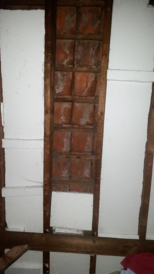

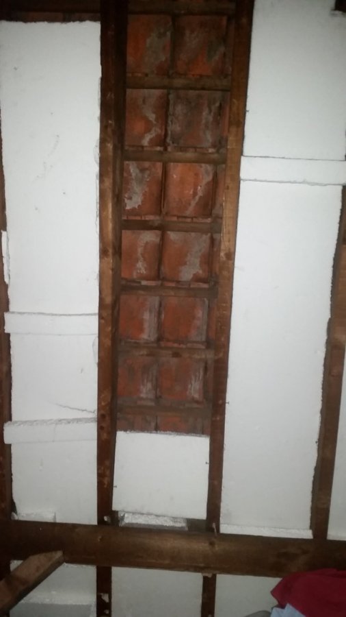

Hi,
Tiles are clay FWIW
A bit more info: The reason for removal is the previous owner of my house had removed chimney breast and only supported the stack with a wooden lintel.
10 years later, I'm planning to rent the house now and wanted to make sure it is safe. (long story involving council, gallows, RSJs, cost of engineering calcs - seemed better approach was to take chimney down )

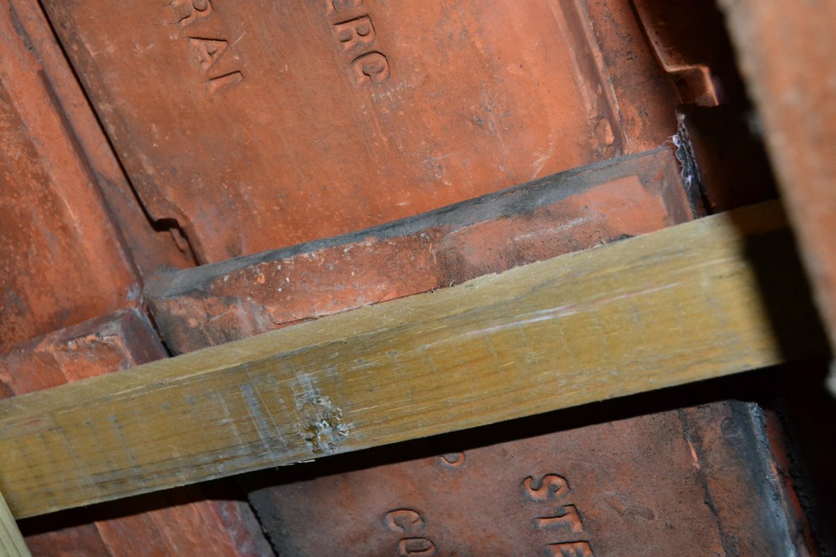

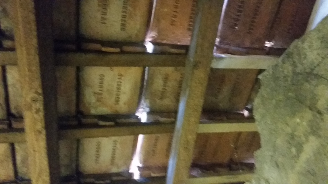

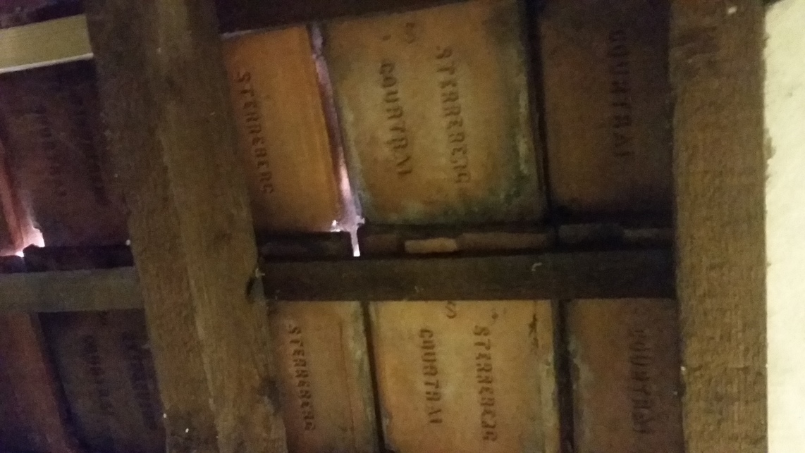

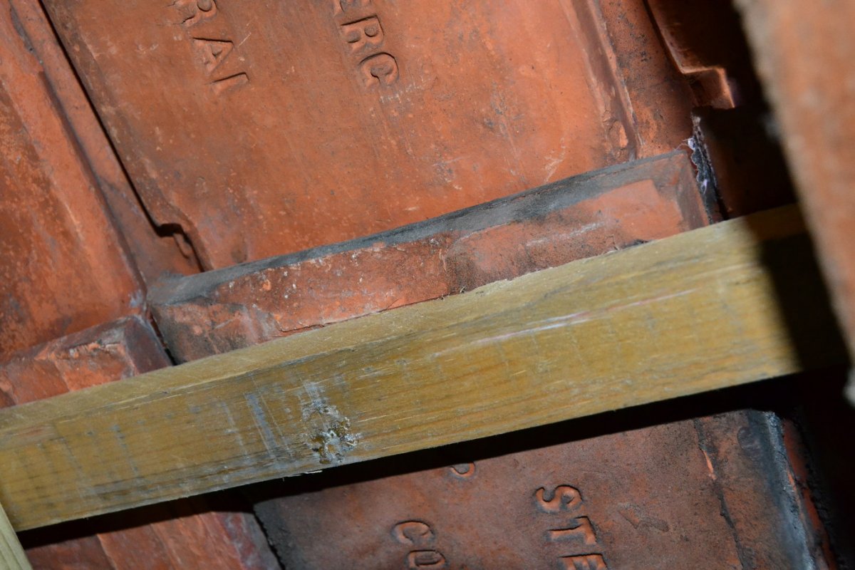

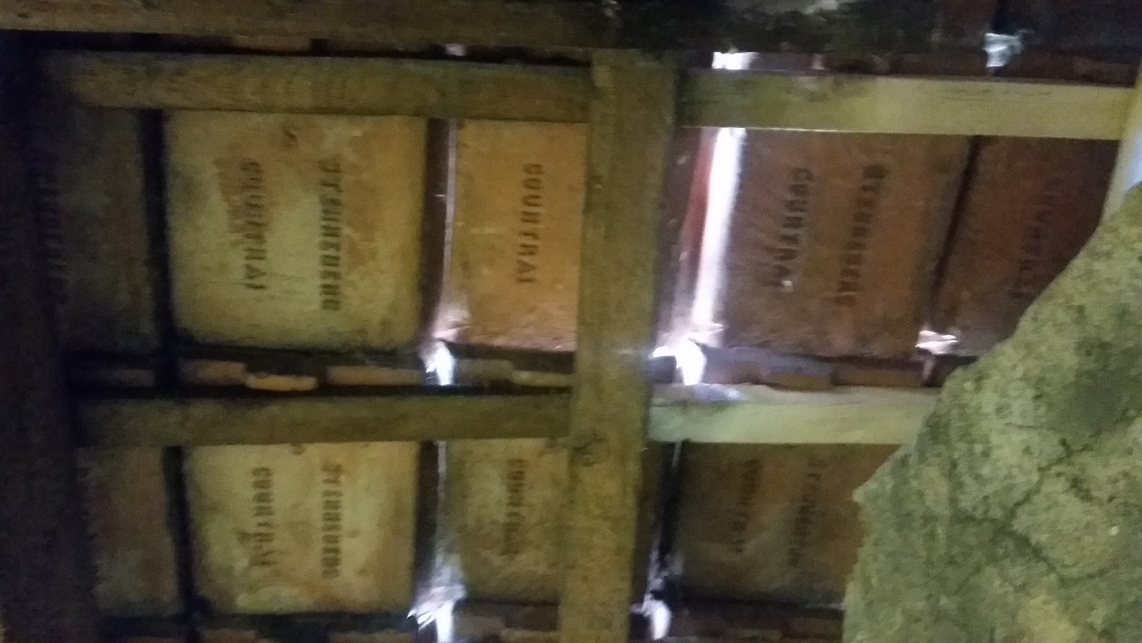

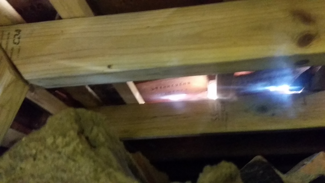

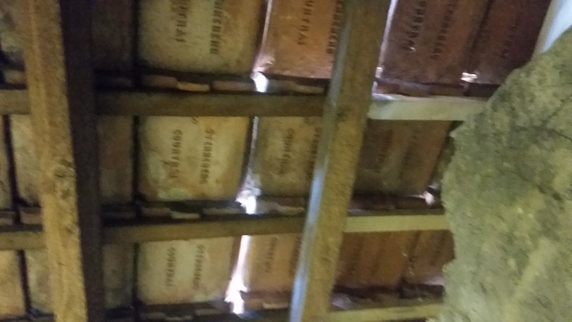

Regarding the gap between party wall and roof space - before the job there was a small gap 1" , 2" gap - which I fill with wirewool and expanding foam to help control vermin.
After the job there is a huge gap - for example one of the attached picture (linked again below) was taken of the neighbours tiles from my side of the loft.

gap-neighbour-jpg.103145
http://www.diynot.com/diy/attachments/gap-neighbour-jpg.103145/
There does seem to be a lot of light coming through the tiles
poor workmanship or the tiles are not quite the same.
I will give you a tip don't pay until its rained, I have never
used that type of tile so I don't know there idiosyncrasies.

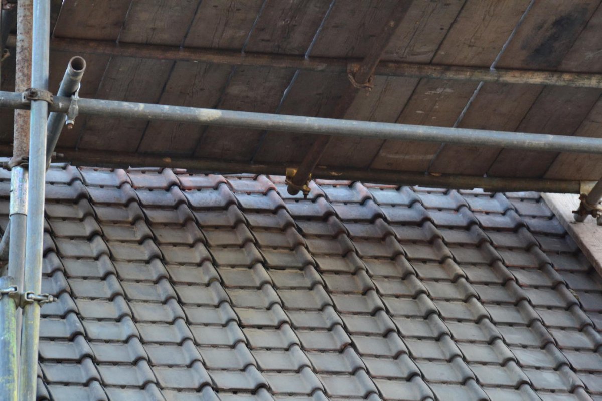

You have to clip the corner on those tiles sometimes to get them to lay correctly. And sometimes you have to bin them because tehy are all bitter and twisted.
The annoying thing is both myself and the neighbour had tiles which were in better condition than the ones he used, but he was keen to use his stock.
Only realised after they had been laid how poor his ones were by comparison.

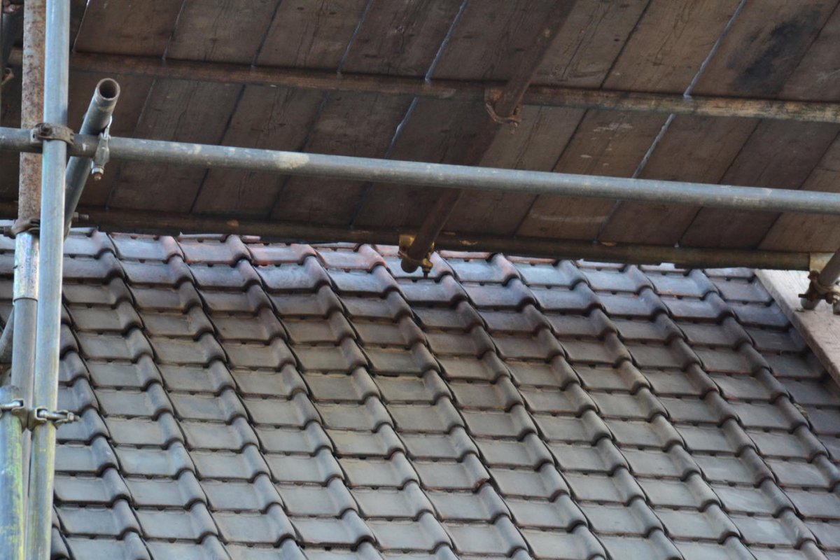

Clay tiles lose their shape whist being fired. If you were to bin all the misshapen ones then you would have none left for the roof. They look like the worst tiles in the universe with which to try and achieve a uniform finish or decent lie.
You only need to look closely at the rest of the roof to see there are gaps. Look at the join in the centre of this image.

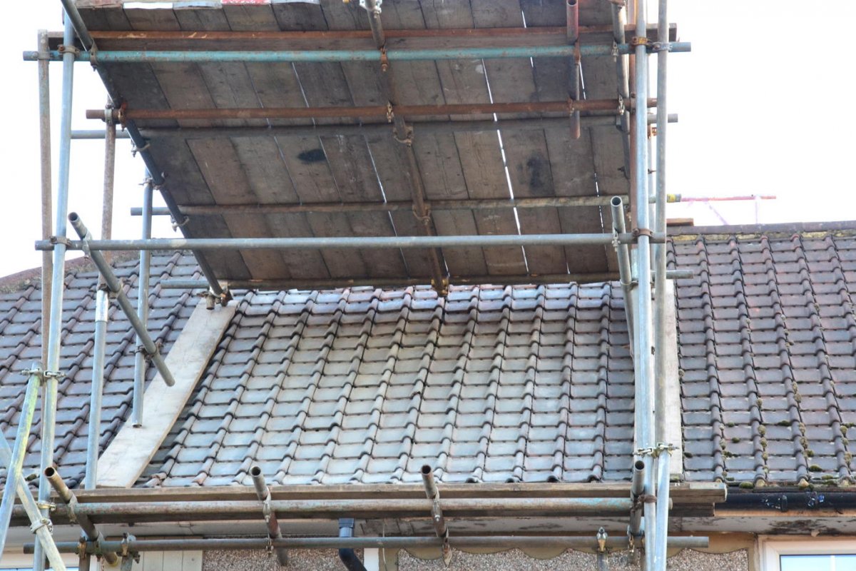

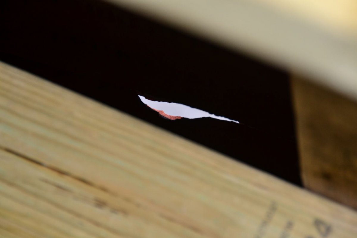

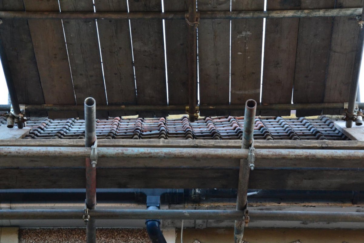

@noseall - agree - the new tiles are redder and mostly hidden by the scaffolding. This has gone now. I've attached back elevation piccy. and one showing a tile with a crack in the groove.
FWIW I've not paid roofer yet. They've resisted all attempts to re-bed tiles. Saying they 'come out if any problems'.
I've ordered a written survey of works from another roofing firm. This is so I can withhold some payment with evidence why.
Obviously 2nd firm have vested interest to critique original job, but they agreed tiles need fanning out better (perhaps shifting over some of the original tiles on each side),
and raised some other less significant issues (insulating stack etc).
I plan to deduct cost of survey and 'fanning' from original invoice. (approx £85 survey + about £150-200)
I may pay extra to whomever gets fanning job to insulate stack at the same time.

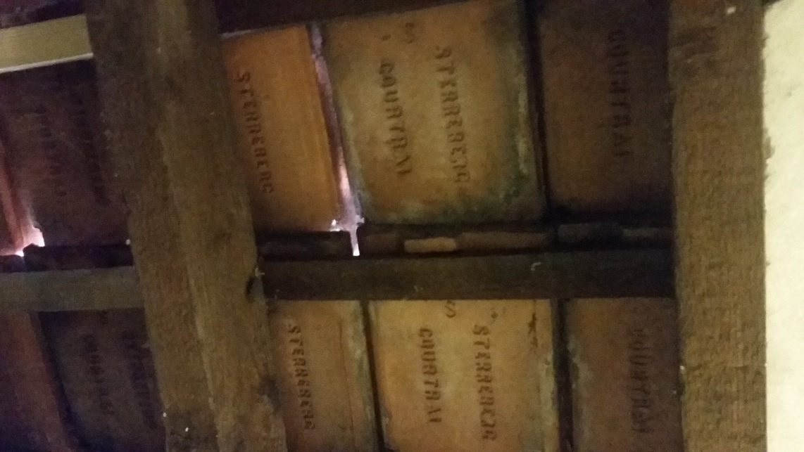

I've learned a bit more whilst looking for a good roofer to fix the issue. Problems started with their carpentry/timberwork (no ridgeboard, rafters extended with screws and 1 foot overlap) etc.
by the time they got to the tiling they had no chance. Two roofers I've seen since said I shouldn't have paid them anything but they did knock down the chimney I guess.
I've put up a page with some pictures of their timbers - I'm not bitter - lol!
Patching in with clay tiles like that is always going to be difficult. As noseall says there will even be variations in tiles from the same batch let alone from completely different ones and the profiles may also be slightly out too.
Even laying a completely new roof with new clay tiles like those is a pain.
