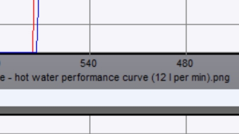

One chart has the statement 12 l/min

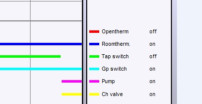

There is a scale for Fan Speed and a scale for Temperatures. Where is the scale for flow rate ?
There is a binary state indicator for Tap Switch

12 l per min CONSTANT FLOW, and one can assume the temperature of the water arriving a the boiler is constant
What would the temperature graph for the hot water temeprature show if the flow rate was reduced fro 12 to 6 l per min.
Would there be a transient rise in temperature ? How long before the boiler modulates down to match the reduced heat load and the temperature returns to the required value.
Boiler matches temperatures perfectly adequately.
Seeing as you're such a smarty pants I'm sure you can use physics and fan speeds to extrapolate all your answers.
Inadequate answer.
Agree a change in fan speed will ( should ) occur when water flow rate changes. How long before the boiler reacts and changes the fann speed. ?
Unless there is a flow meter in the DHW circuit the only information available to the boiler controls about flow rates and hence the amount of heat needed is the change in temperature of the DHW leaving the boiler when the flow rate changes.
