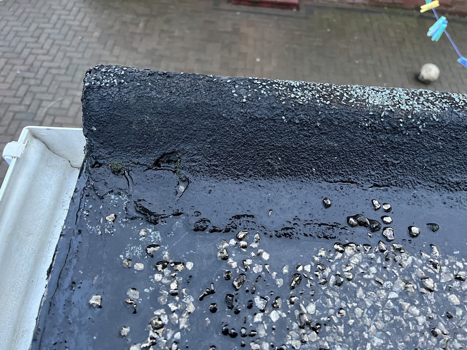

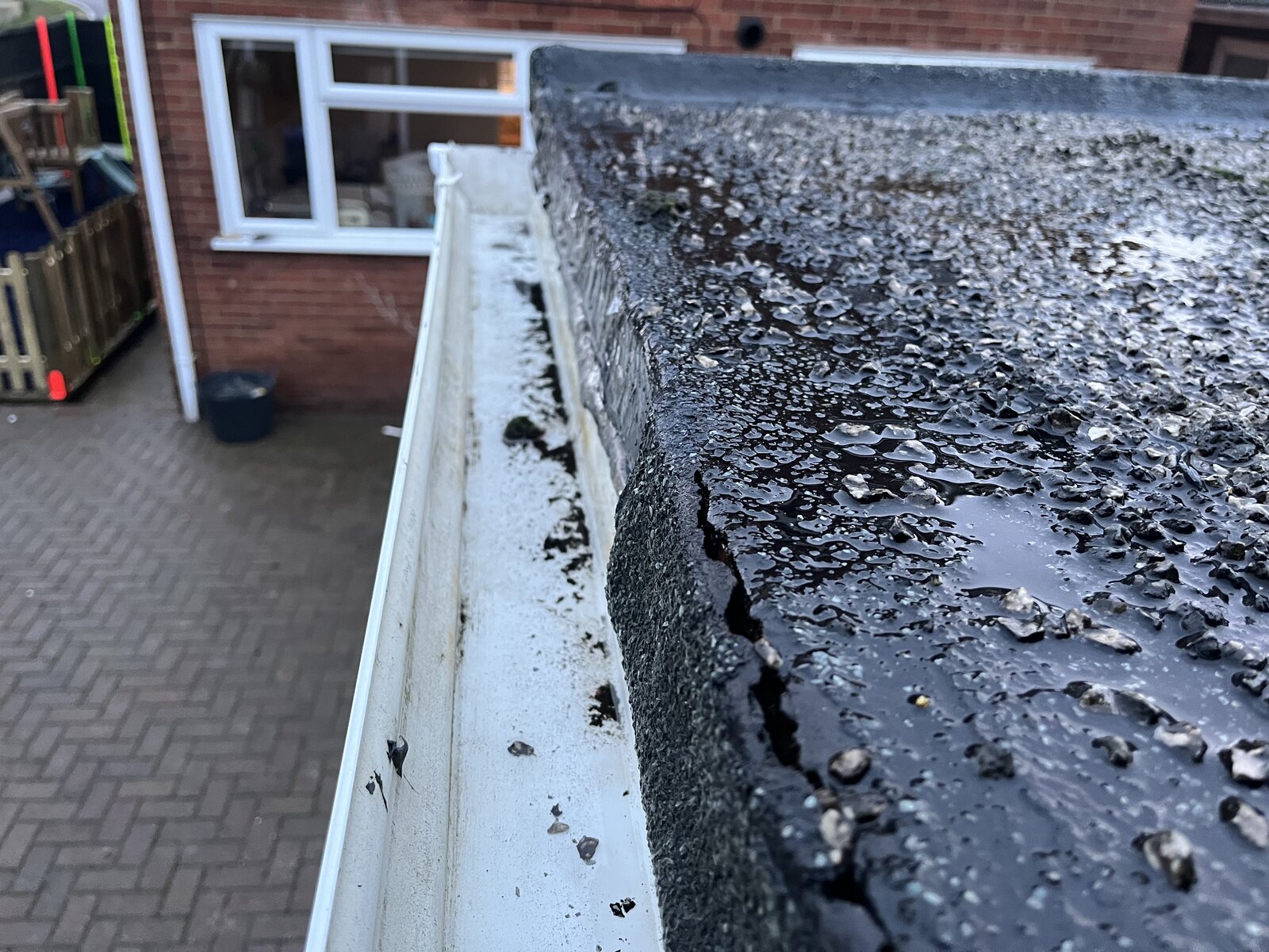

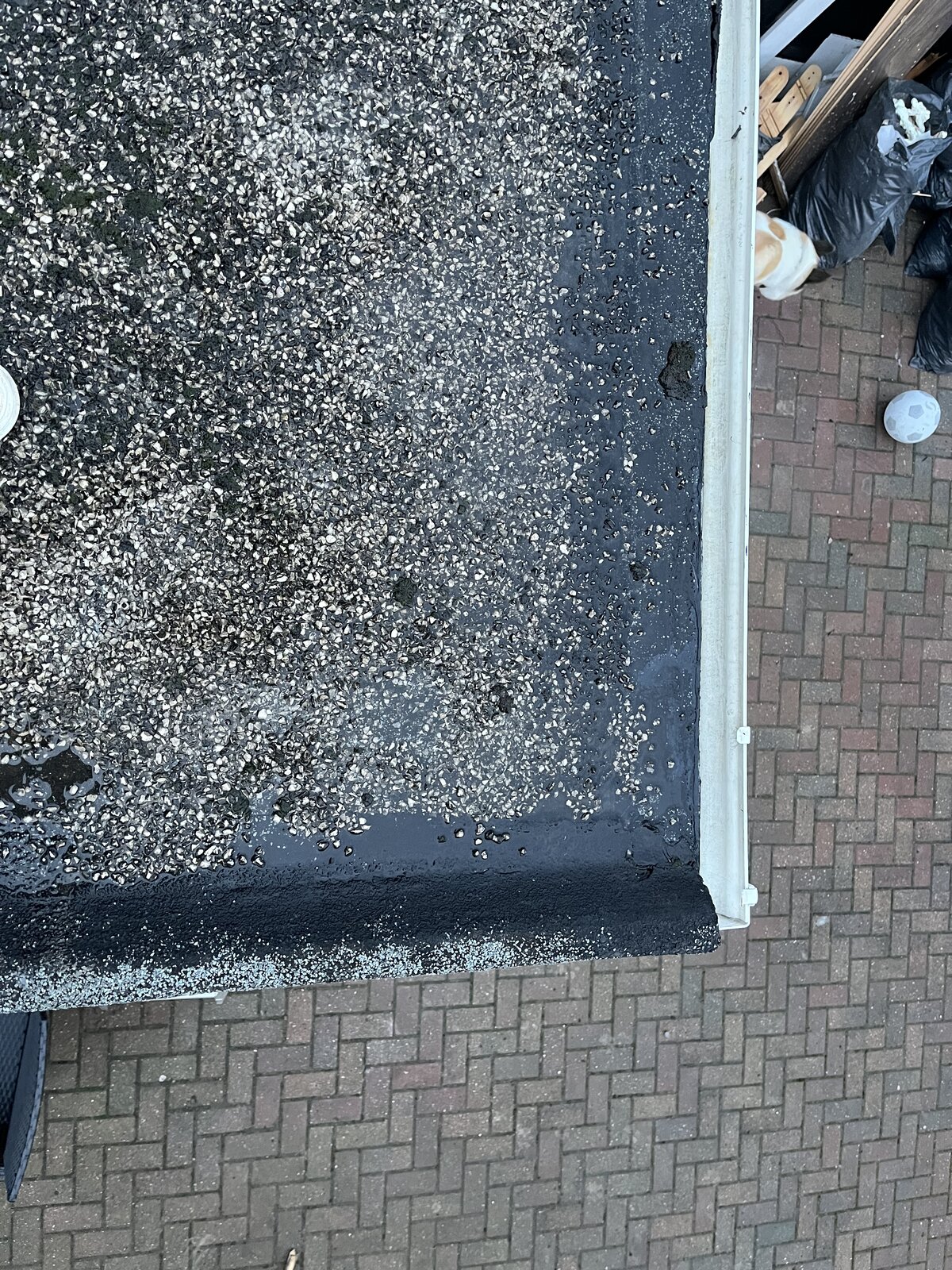

hello!
Could someone advise me on the best way to repair my garage roof.
Flat roof. - felt with stones.
The flashing into the gutter has worn, which is now allowing a small amount of water into the ply underneath.
Looking for the best way to seal.

Hi there! it looks like the flashing and roof edge have significant wear, which could lead to more water damage if not addressed properly. While a temporary fix with bitumen tape or liquid sealant might help for now, the condition suggests it might be time to consider a professional repair or even replacing the roof if there are other areas with similar wear.
Roof looks like it's had its day.
Needs stripped off and recovered.
You could use something like EPDM to recover it.

Acrypol, cromapol would be your best bet for a short term fix..got to be clean and dry...your local builders or roofing merchants stock it.
