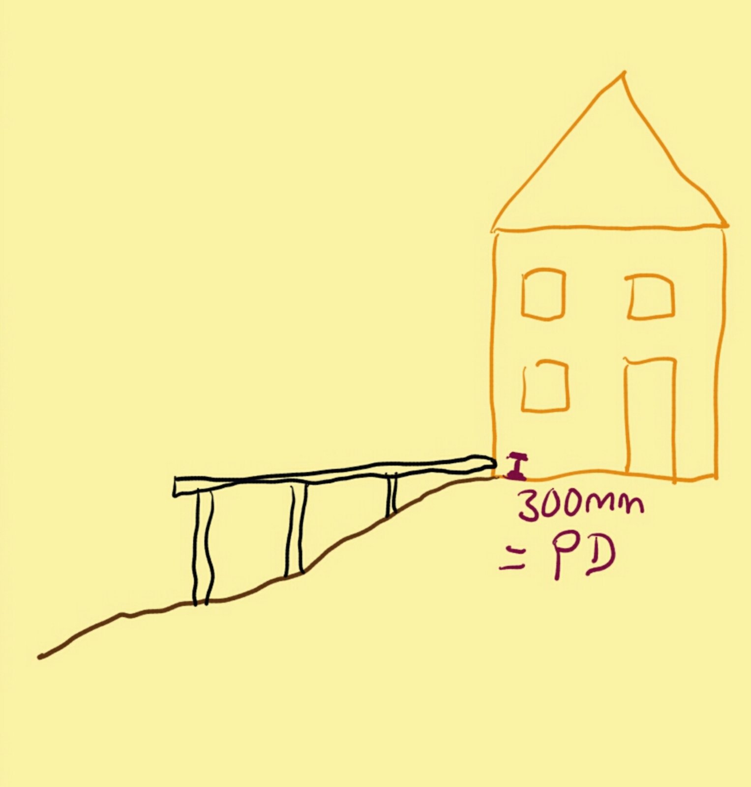

With any planning regulation and height, height is always measured from the highest point of the ground immediately adjacent to the development (ie the deck). 300 mm for a deck is established as permitted development, and it does not matter what height the other end is above ground.
Invite that planner to state precisely why he does not think this so in your case, and advise him that you would not like to go to the expense of instructing professionals to prepare and submit an application purely on his advice - and then have to complain to the Ombudsman for your costs back if this was not necessary.
Glad I came across this website now. I'm due to move house soon but got put off putting decking up as I read it as 300mm maximum at any point. If this picture is correct and the OP has this same scenario as I will do too, then I'm now encouraged to carry on with fitting the decking up

It doesn't matter how many slopes you have on decking or how the ground lies. If the highest part of the ground the decking is built off is no greater than 300mm to the top of the decking at that point, the whole deck is acceptable (subject to the 50% of the garden rule)

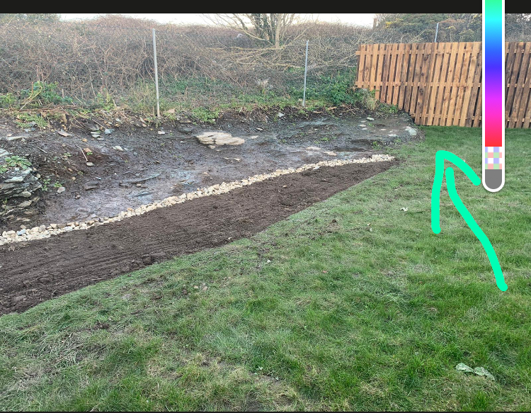

Hi All,
Really interesting reading this thread.
@LukeB123 @John D v2.0 wonder if you could advise.

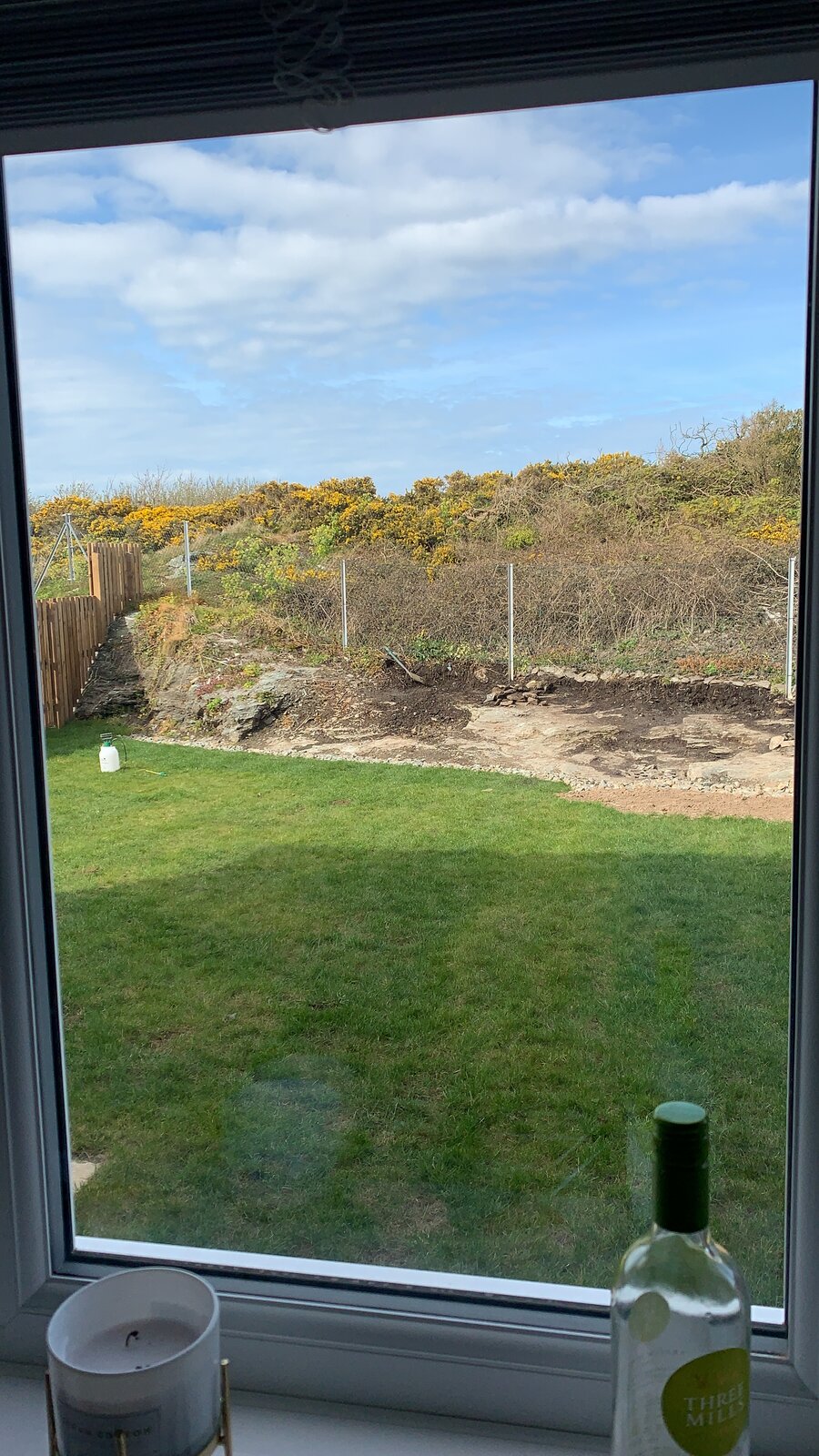

I am looking to put some deck over the rock in the photo. (Arrow showing where)
The deck will be pretty much touching the rock at the highest point. Then at the bottom it slopes down so the gap will be around 30-40cm.
Would this fall under PD.
The rock is a natural feature of the garden and is much larger to the left of this photo. Would this class as the highest point of the garden? Photo again attached

@Luke1988 you'd probably be OK to build it under PD there I reckon. If it is "original ground" I guess it can be made up of big rocks and other things, that's not unreasonable.
You're only issue may be if it is raised by someone, it's pretty difficult to prove that a rock in the ground is the "original" land level (E. G. Anyone could throw a rock in the floor and pack some dirt around it and measure off it)
As I said, I think it should be OK from what you've said and the pictures (the land looks like it naturally was higher at the back and the gardens have been cut into it)
If you want to be sure / are worried, either take loads of photos and vids to show the height with something in there for context so it shows the height for future reference, or it may be worth in this instance getting a Lawful development certificate (only if your concerned by neighbours etc)
