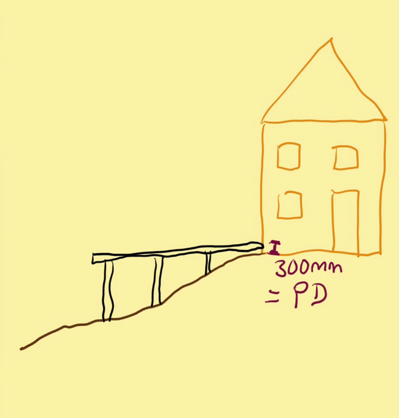

Hi All
I hope someone here can guide me on the below.
I have had built decking in my back garden. My garden itself is sloping. As a result of the slope the deck from the back of my house is below 30cm, in height, from the ground whilst the front of the deck is approx 50cm, in height, above the ground.
My neighbours have now decided to make a complaint to the council. The council has come around and had a look and measured up as i have illustrated above. The council says that my decking is in breach of planning control. As a result it either needs to be taken down or i need to apply for retrospective planning permission.
His own advice to me was that there was most likely no chance of me getting approved retrospective planning permission and that i should apply for a lawful development certificate. If the certificate is not given or it is referred back to him he will advise that i take it down.
Does my build fall within a permitted development?
Is there any breach at all?
What is the law / regulations on decking height?
I would like to keep my deck as is and would appreciate any guidance as such.
Many thanks

I don't quite follow the OP's post. Is it any part of the deck less than 30cm above the natural ground level?
Thanks so far.
Through my research i found the below information.
"Where ground level is not uniform (e.g. If the ground is sloping) then the ground level is the highest part of the surface of the ground next to the building."
If this were the case then i would not be in breach.
As i step out of my back door the deck starts and is less than 30cm above the natural ground level.
The other end of the deck is more than 30cm above the natural ground level (approx 50cm)
This is due to the sloping ground beneath.
I hope this clarifies.

The fence does not come in to it. There is no right to privacy with regards to back garden fences and planning regulations. That planner should not be commenting on things outside of his remit and expertise.
With any planning regulation and height, height is always measured from the highest point of the ground immediately adjacent to the development (ie the deck). 300 mm for a deck is established as permitted development, and it does not matter what height the other end is above ground.
Invite that planner to state precisely why he does not think this so in your case, and advise him that you would not like to go to the expense of instructing professionals to prepare and submit an application purely on his advice - and then have to complain to the Ombudsman for your costs back if this was not necessary.

He's talking crap.
It's good that he does not despute the actual planning regulations, because then he would be plain wrong not just an incompetent buffoon.
What he's doing is trying to satisfy the complainant. There is no such thing as a privacy issue in planning in this context, and the talk of a step is laughable because it's still a single development in planning terms. This means that if (and yours does not) a part of the deck exceeds the permitted height, then it would still be a single development, and a step would make no difference if part of it was too high.
There is no way they can enforce on something that is permitted development.
