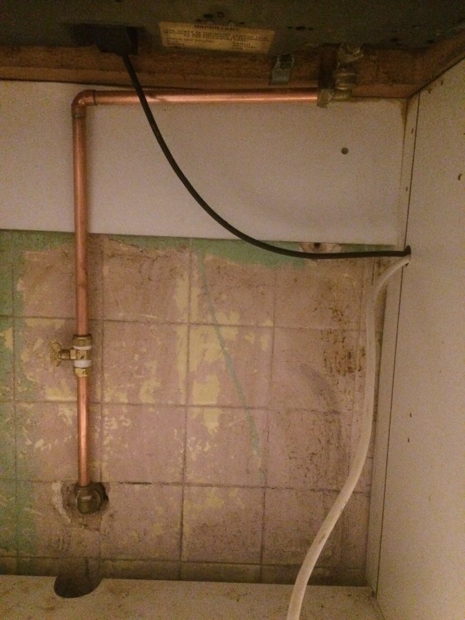

Gas Man Says built in hob should not have a flexible hose?

don't understand why people use ptf tape on compression fittings when installing new pipework .
Just a month ago we had a flexible hose replaced with copper for a gas hob. It cost £65 and it was done done after we got back from work at 6pm.
Would've been half the price if he hadn't emptied his tub of gas seal everywhere!
I'd introduce him to clips, solder and a spirit level too if I were you.

I just hope that the PTFE tape on the threaded end is Gas Rated and not just regular 'Plumbers Tape for Everything'.
Generally it has an Yellow tint to easily identify it.
Patrick
From the picture it looks like it's Loctite 55 which is all encompassing but hard to tell.
never noticed the yellow tint, except when on the roll:)
Me neither but I'm going to have to check in the morning now!
That is nothing to be proud of! You were over charged for crap work.
Fook me. Was it done in the dark as well?
Reminds me of a phrase my dad used to say after I did repairs on my first car. "Fook me, was it painted in the garage by candle light with a brush!"
Thanks for that lovely example of paying peanuts and getting monkeys. Did you see the installer's Gas Safe card?
Probably didn't have time before the horse bolted. OR its a DIY job thinking they were going to get praise for such professional work and we wouldn't tell the difference! My money's on the latter!

Similar thing happened to me, i got a guy in by recommendation who had the appropriate bits of paper (i even checked online to be sure) to run a pipe for a hob, and he installed it, squint, with 3 clips over a 5m run of pipe, then unclipped one end and left it hanging due to not having measured correctly, and hid it behind the dishwasher. When i had the appliances out a few weeks later i realised he was a knob and ended up attaching some more clips myself to secure it properly.

I didn't just want to pay peanuts, I wanted it done correctly. I phoned a recommended gas safe engineer, he came, did it and charged £65. I wasn't chasing the price down and I didn't get any other quotes. I was just giving the price I paid as a comparison.
Also he was gas safe registered as I checked the gas safe website.
