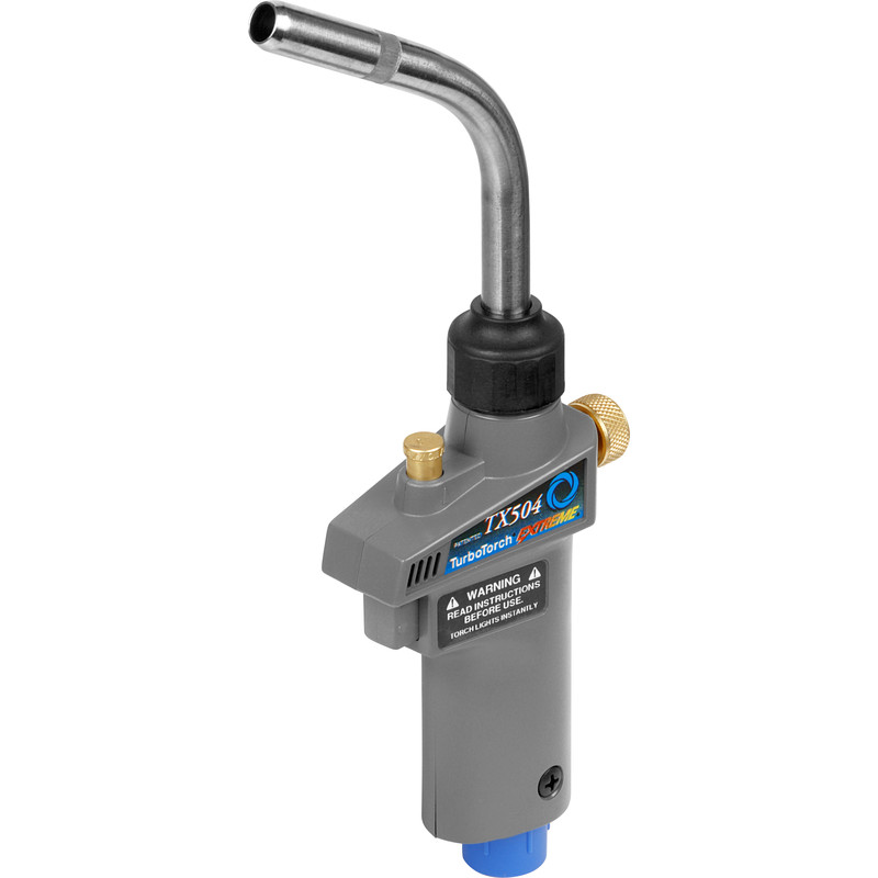

Turbo torch

@ban-all-sheds For a day to day functional torch then the Rothy superfire 2 no need for extra nozzles, works at all angles without flaring, does up to 54mm with MAPP (not tried it higher as have a separate torch) fully serviceable and can take a beating.
If you want to have t swap nozzles to pipe sizes and add shields etc then the Vulcane. I don't like it as its plasticy and just doesn't feel well balanced but others like it. When you add in the cost of extras it gets bloody expensive though.
You could hit the rothy remote head if you want to get into tight spaces. Cracking bit of kit but I prefer the Superfire 2 for continuous soldering and the remote head for odds and sods and awkward spots. I have both and would highly recommend.

Anyway, here's the one I've used for years, just over £30 in B&Q;

NERRAD FIREJET 10 year guarantee hasn't let me down yet about £ 70 really pleaded with it ( but not a remote ) from plumbcenter
TBH i dont think you need extra nozzles or remote head, i have never needed them for any job, if you improve your torch skills you can do it all with a sure fire 2

100% agree that you don't need extra nozzles and shields but honestly try the Rothy trigger torch. Depends what you do, if you are first fixing and have all the space you want then you won't use it but behind kitchen cabinets, under floors that are an arm stretch away, working over head height for a period of time its awesome.
I thought the same as you to start with but I love gadgets so got one. Best £70 I spent. If you do try one you won't regret it. I'll even buy it off you as a spare if you don't like it!

The only reason I mentioned different nozzles was in conjunction with the Vulcane that I mentioned. It's new out but needs different nozzles for larger pipe sizes. I don't rate it but others do. To me it seems more style over substance.
Rothy SF2 is the benchmark as far as I'm concerned.
That's a good point - again, unlikely that I'd need a torch like that vs one that screws onto a cylinder, but I guess I'd never find a situation where I couldn't use one, whereas I might with an integrated.
Any downsides of that design, other than taking care how you put it down after use?
A Torch is for shining light a Blow Lamp is for soldering.
The Rothy etc one are far to easy to knock over & break. While this is a safety feature, it's an expensive repair.
No need to worry about putting it down as the holster that the bottle is in also has an integrated torch holder.
