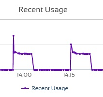

Did it on the Falklands on a farm, an old bus was bought, the Bus became a green house, and the batteries Ni-iron were used for the house lighting, which was done with the bus fluorescent fittings. But still the same question as last post on this thread, what size inverter needed to start a freezer?
Ah, that's a piece of string question.
Go back a while and you'd need an oversized inverter to handle the startup current of the compressor - so perhaps a surge rating of 10x the running current. These days inverter drives are common and the startup requirements are less.
Then you need to look at the inverter. Some will crap out at the mere hint of overload. Others have a surge rating well above their steady state rating - specifically for starting difficult loads.
My upright has an inverter drive, not seen it with chest freezers, and the upright uses around 180 watt for the defrost cycle, so needs around 200 watt inverter to supply it even when run is around 60 watt. And upright use around a 1/3 more to same size chest freezer. So if worried about power cuts would what a chest freezer, a chest freezer will last around 24 hours, but upright depends when the last de-frost cycle was, could be down to an hour if only just finished defrost cycle.

I used an energy monitor, I could see the mark/space ratio quite well, and the chest and upright nearly the same. But one, the upright gains more heat when the door is opened, and two it has auto defrost which it needs due to the large air change when the door is opened.
The other difference is the chest shows an inrush when started, the upright has an inverter drive, so very little in-rush. I would think the upright would run off a 200 watt supply, i.e. if enough for defrost cycle, it would run, but the chest working out size of inrush is a problem, this 1734546259406.png is actually a battery charger, but the start peak is the same pattern with a freezer, we know each start will be the same, but the software does not record them as being the same, so only way to find out is suck it and see, but want to know before one buys a generator or inverter will it work.
I could monitor my chest with another energy monitor, but that is my freezer, not the one in question.
