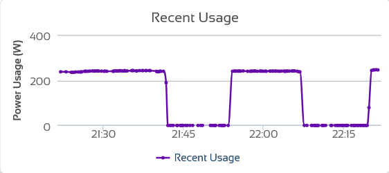

Seems I was well out, the inverter drive freezer

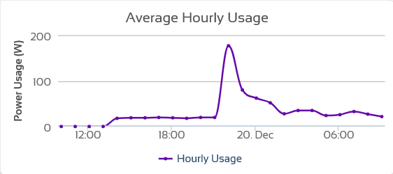

However this is nothing to do with getting a generator. However this 1734651257642.png is, not a clue why now the upright is only using 62 watt, why it used more earlier I do not know, I thought the last time I monitored the two freezers were nearly the same.
I had considered a small inverter generator before I got solar panels, this one 1734651622149.png at just over 2 kW would likely be enough, and at £205 it would not break the bank, maybe pay a little more and get from Machine Mart 1734651787035.png a little smaller at 1.1 kW, want some thing which does not make too much noise. 69 db at ¼ load, but would like to hear one running, today solar has actually lasted the whole day, I still have 20% battery left, so no real point in getting a generator now.

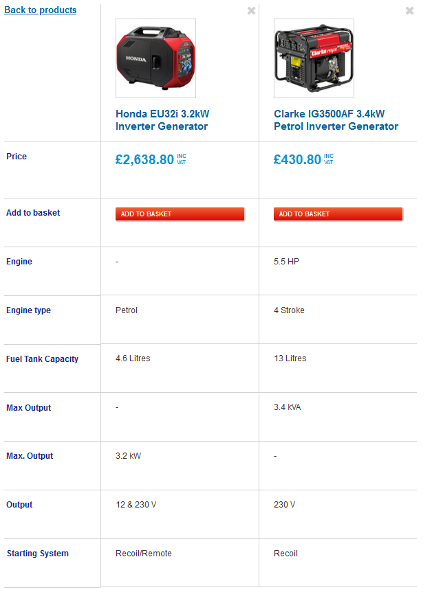

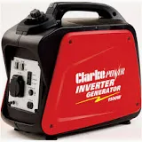

maybe pay a little more and get from Machine Mart View attachment 366659 a little smaller at 1.1 kW,

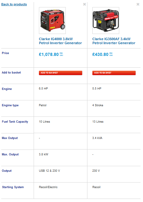

OK - so looking at Machine Mart - I get that Honda engines are very good, but is it only the engine which makes this:
cost over 6x this one: https://www.machinemart.co.uk/p/clarke-ig3500af-34kw-open-frame-inverter-gener/
Just looking at "Clarke" ones (yes, I know they're just badging all sorts of different makes), but what accounts for the price difference between these:
