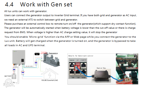

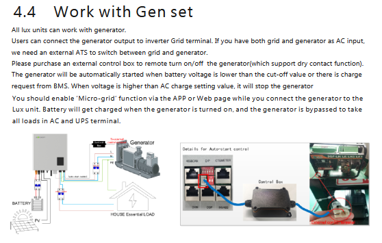

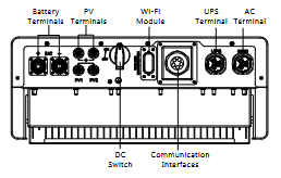

I have wondered if I can connect a generator to my inverter, I see no option here
unless I got another plug and could swap the AC Terminal plug? That is what it seems to say here
However I have not had enough power cuts to be worth getting it to work with a generator, but the system it seems will decide when a generator is required and auto start and stop it. Today at the moment running the clothes drier, I am monitoring the solar production, not high, but more than I would use without the dryer, and this is the problem, one becomes a slave to the weather, deciding when to switch things on/off, a dryer takes 2.5 hours, and only draws 600 watt, so it needs to go on before the battery is full, or still exporting.

I have wondered if I can connect a generator to my inverter, I see no option here View attachment 373283 unless I got another plug and could swap the AC Terminal plug? That is what it seems to say here View attachment 373284However I have not had enough power cuts to be worth getting it to work with a generator, but the system it seems will decide when a generator is required and auto start and stop it. Today at the moment running the clothes drier, I am monitoring the solar production, not high, but more than I would use without the dryer, and this is the problem, one becomes a slave to the weather, deciding when to switch things on/off, a dryer takes 2.5 hours, and only draws 600 watt, so it needs to go on before the battery is full, or still exporting.
To use a generator used for camping to run the house in a power cut is one thing, to buy a generator in case of a power cut is something else.
Your options are to manually change the connection and manually start the genny, or install an ATS (automatic transfer switch) so the inverter can switch the input from mains to genny when needed (and start the genny if you install the remote control interface).
