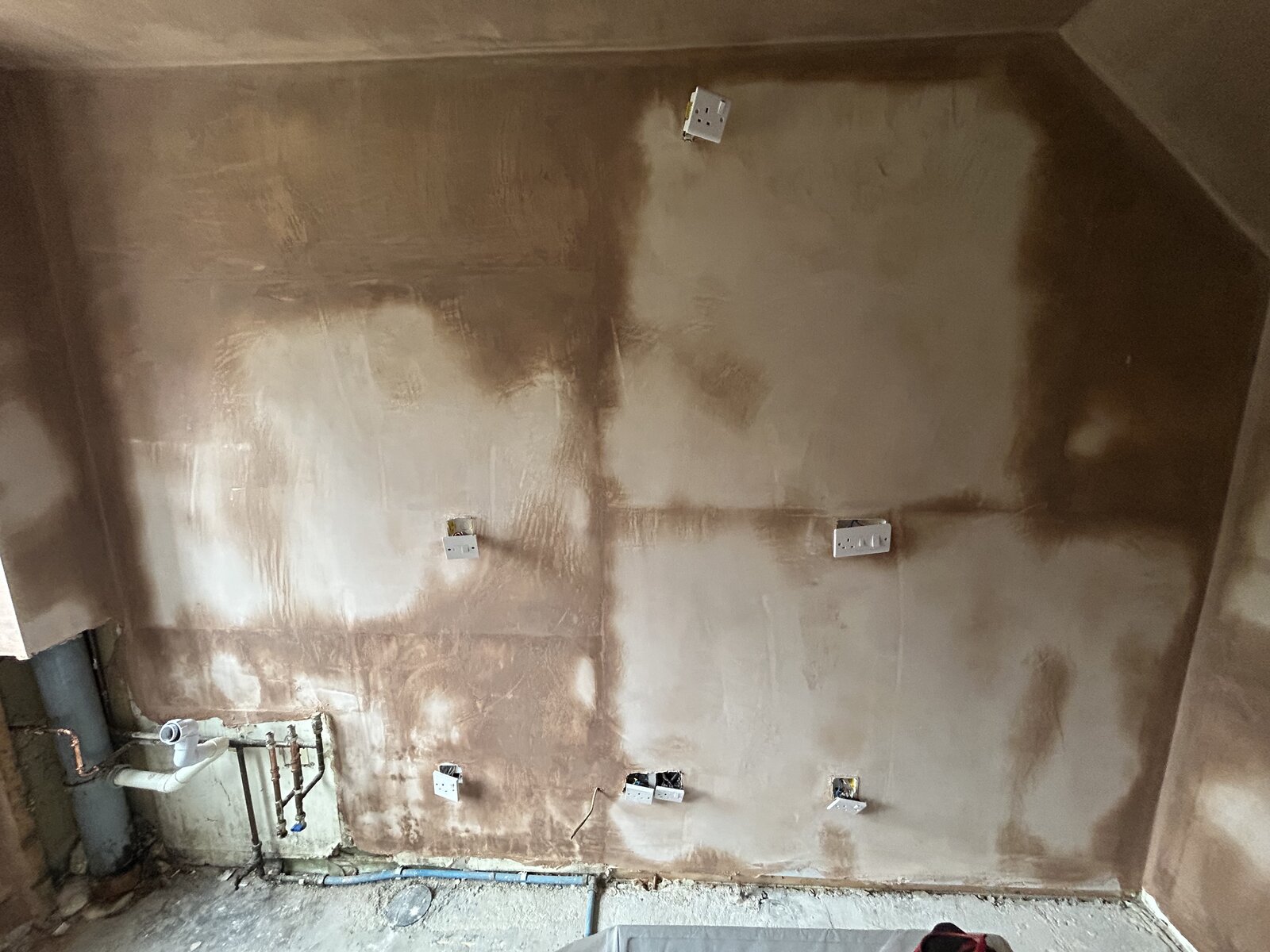

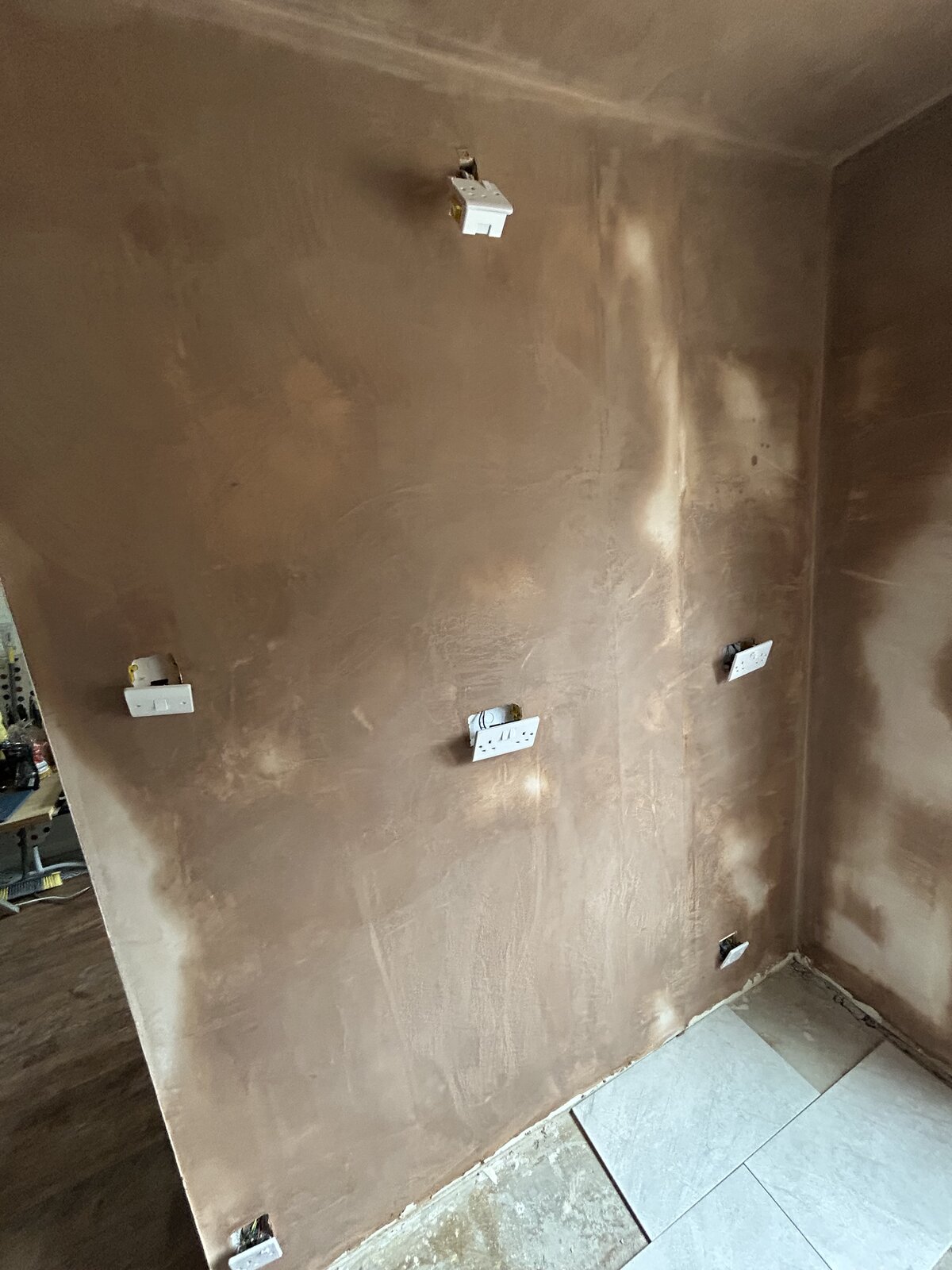

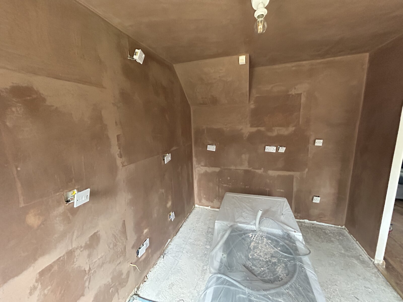

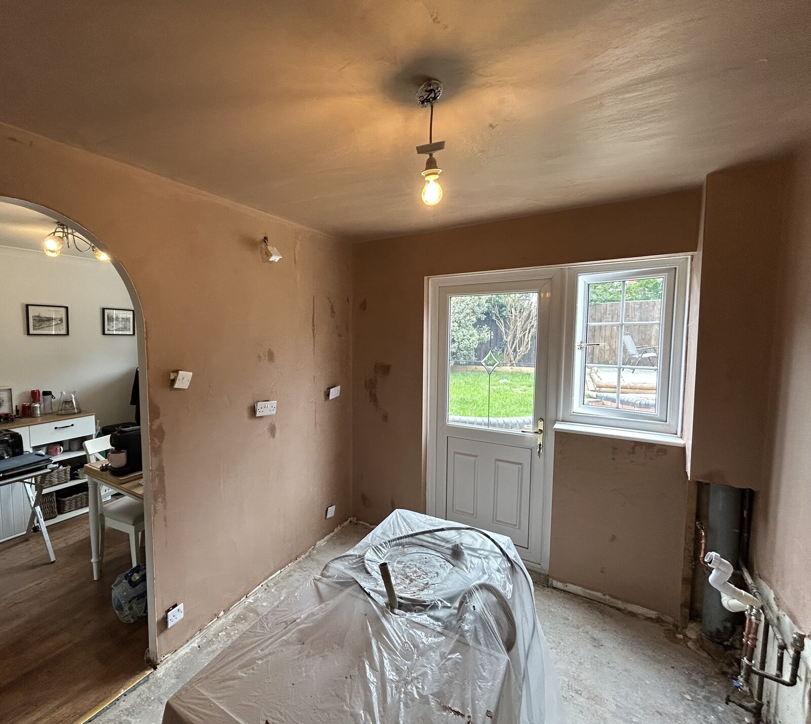

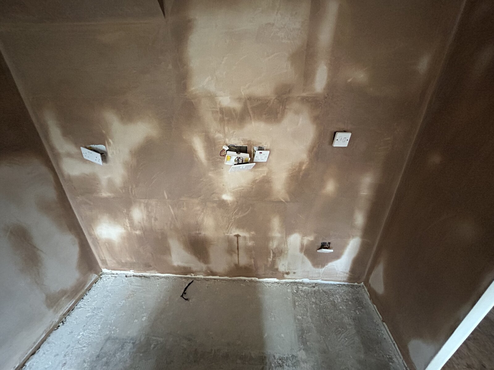

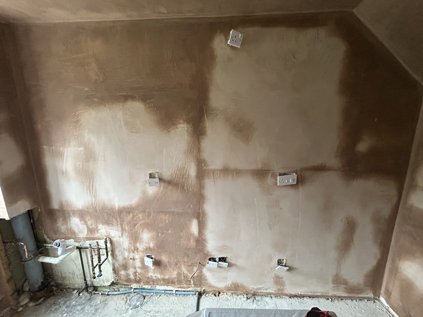

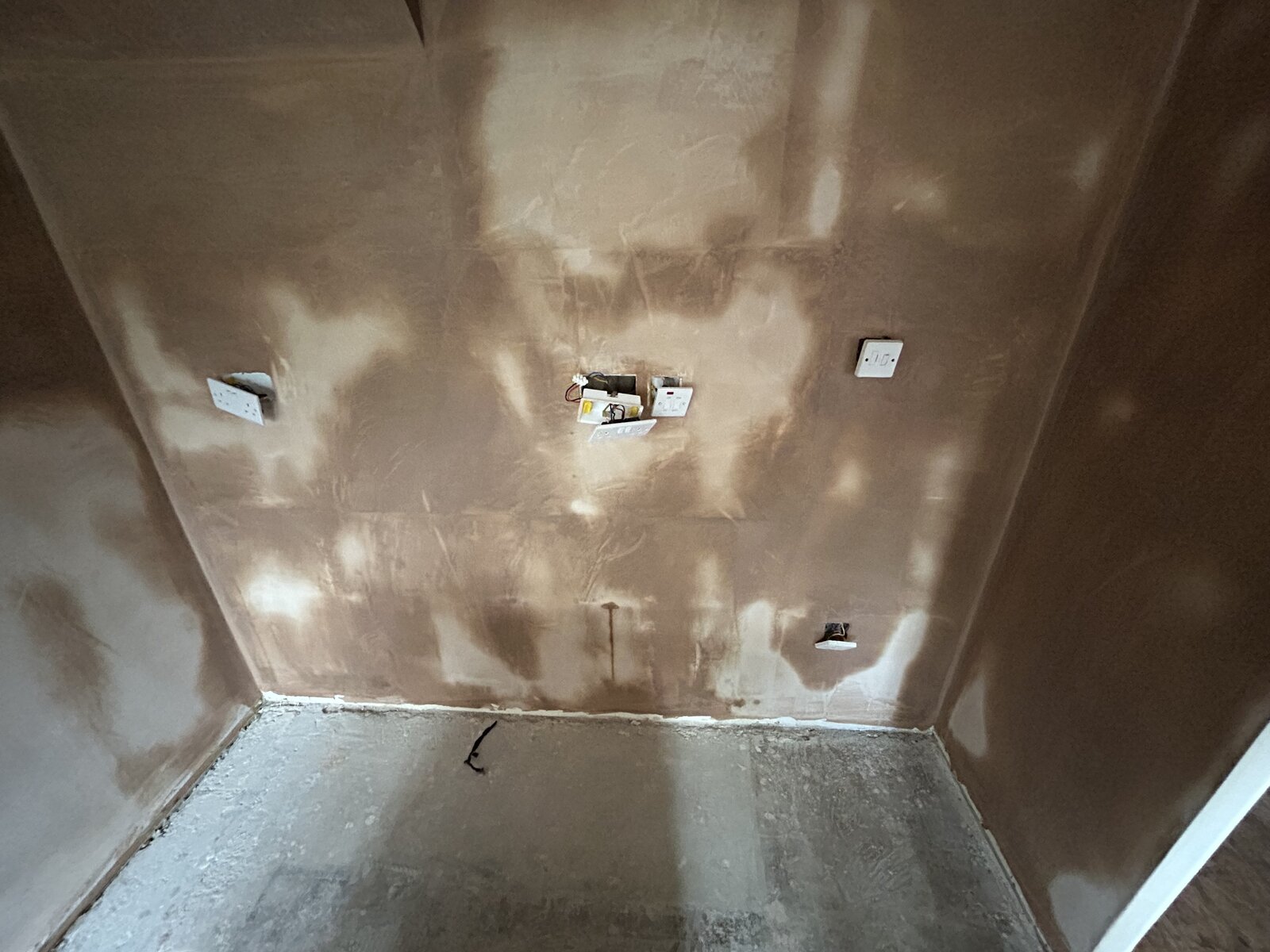

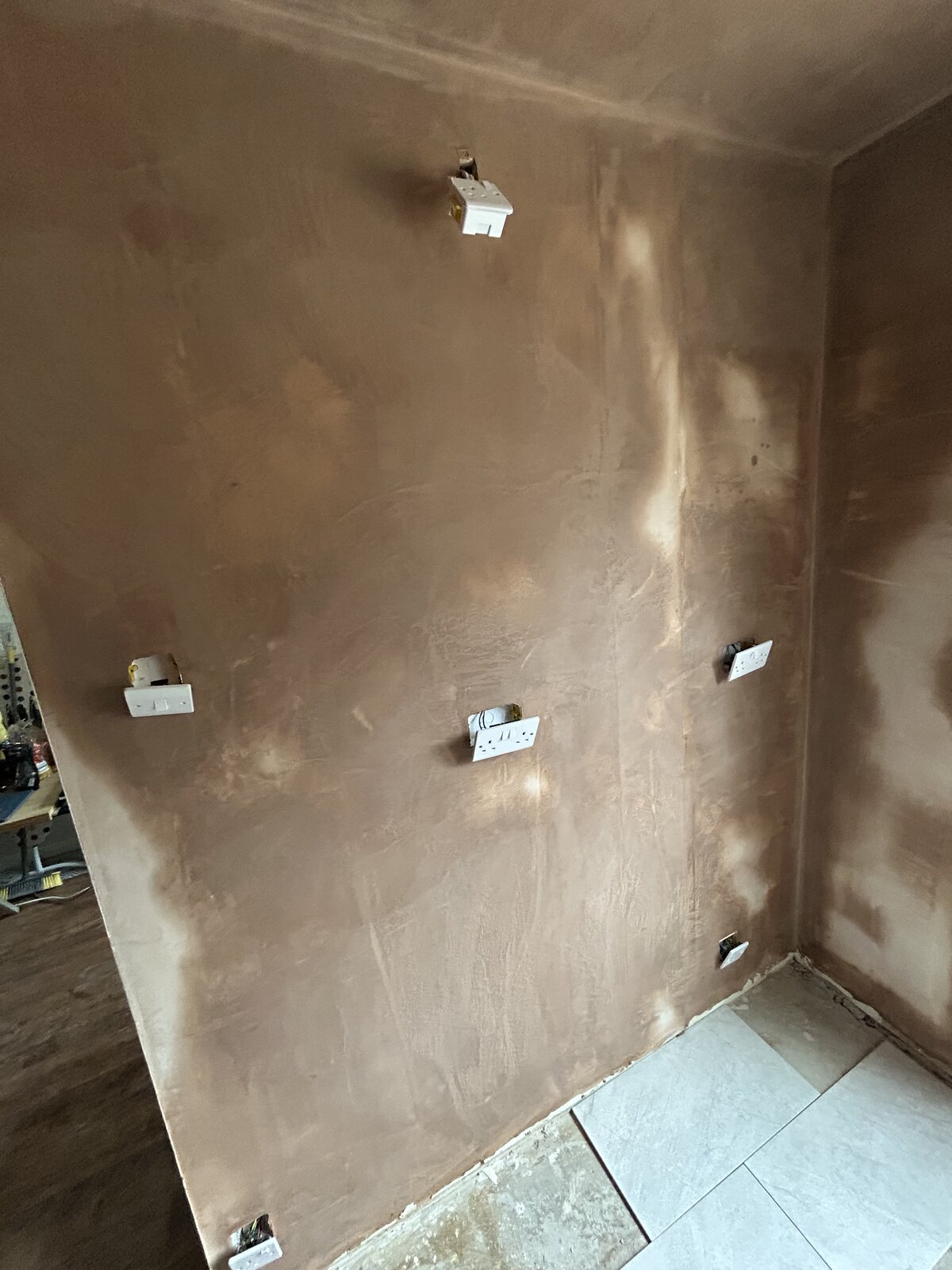

Having kitchen refurbished. Got to the stage where old kitchen cupboards ripped out and had to replace some plasterboard sheets as the olds tiles had ripped them to pieces. All was good up to today when the kitchen was plastered and now I seem to get a small electric shock when touching any of the fresh plaster. I do not receive any shock when touching old plaster next to the fresh plaster. To note, the RCB in the fuse box doesn't go when I get these shocks.
I have checked each socket and they are all secure and no bare cores in contact with the wall.
Any ideas on what this could be? Is it possible the issue will phase off as the plaster dries out? My thoughts are to go over each socket connections and then let the plaster dry out and test for shocks in a couple of days…if it persists then I will contact an electrician.

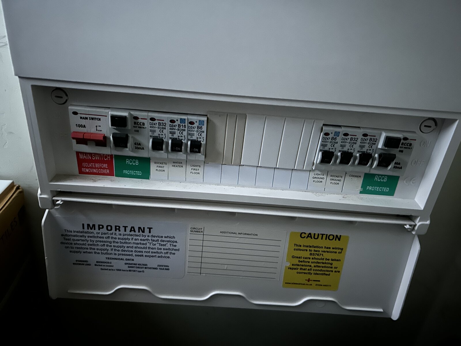

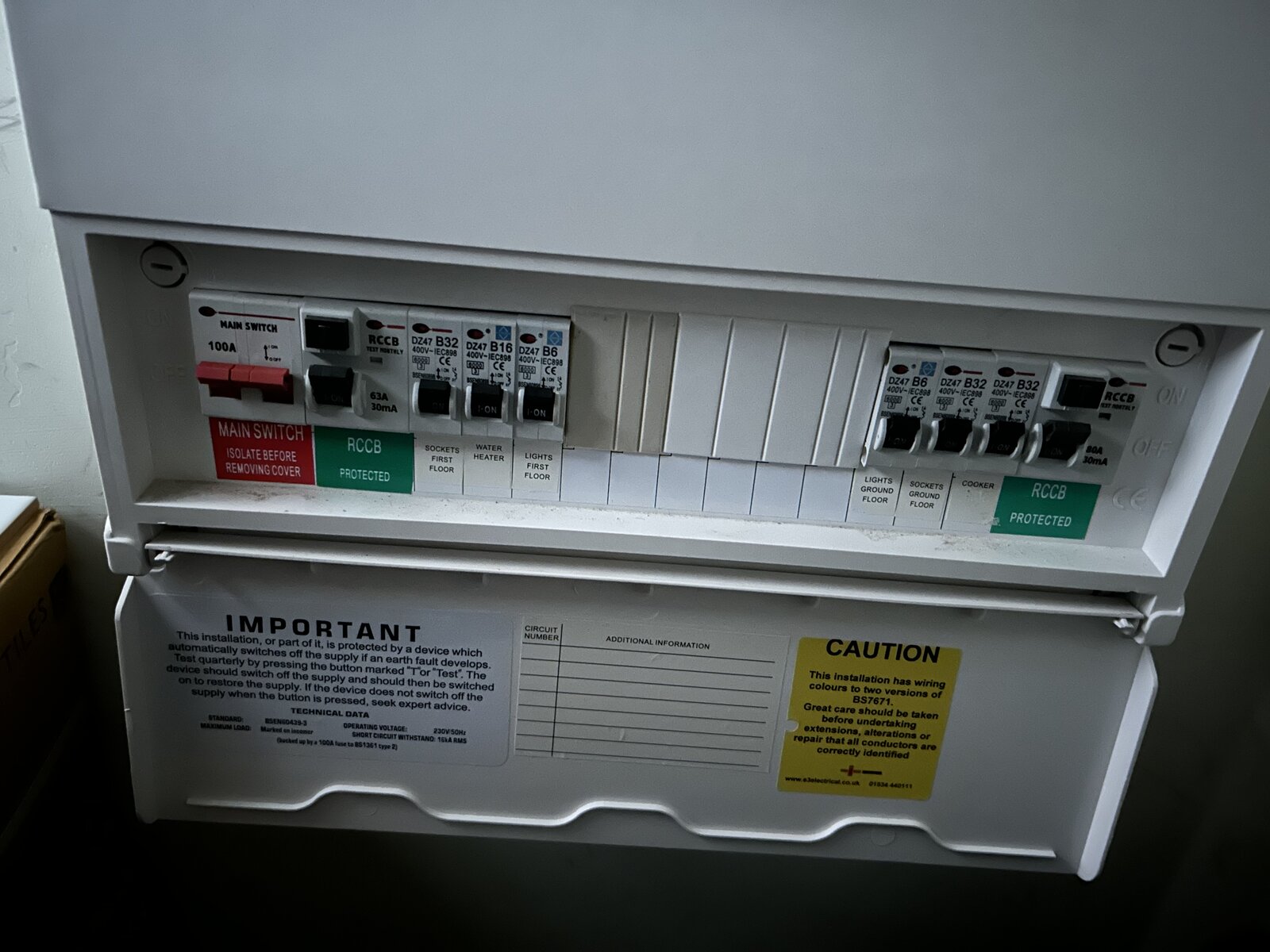

Please show us a photo of your "fuse box" with the lid open, and the thing you call an "RCB."

Here’s the photo of the fuse box…

I spent the majority of yesterday cleaning about metal backboxes and inspecting and resecuring all the wires in each socket. I always added an earth cable to bond my water supply as the existing cable had been damaged. I then went out a bought a non contact voltage tester. I ran the voltage tester around the wall in the areas I knew I screwed in plasterboard (specifically in the electrical zones) and the pen started lighting up. I removed the screw and then called an electrician round just to be sure. No more shocks are occurring and when the Electrican did his tests, he said everything was normal and nothing out of the ordinary. Apparently 3-4 volts on the plaster, which is apparently normal? So I believe it to be the screw I removed as it could have nicked a wire.
I’ll keep checking for shocks over the coming days but I believe the issue has been rectified…fingers crossed.
