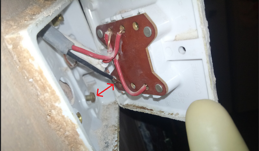

I've messed up - electric shock after plastering wall
Not a sparky, but always heard that there should be no visible copper in connections.
Now you're an electrician, your plastering needs work, though! Good on yer for DIYing though. Learning to plaster is fun
Anyone think the protruding mounting screw & conductor would have been mighty close when the switch was in place originally?
The switch only needed drying out on the radiator.
Blowing it with a hair dryer for 5 minutes would probably do the same.
When you do refit or fit a new switch, cut the exposed copper down to about 8mm max, what you have is way too long and it exposes live copper.
Try and out some sleeving on the earth wires. Green/yellow is preferred but anything is better than nothing.
Green and yellow is mandatory - not merely preferred.
Bi-colour combination of green and yellow ONLY.
As I said, preferably green/yellow, but if the only other colour he has is green then it would suffice. Better to have a correct 'old' colour than the completely wrong colour or nothing at all. No-one is going to be prosecuted for using the old colour coding.
Green would not suffice. It is expressly forbidden by BS7671.
Some people obviously do not understand the meaning of "something is better than nothing" AND its all a mute point because the OP bought some green/yellow sleeving after all.
And BS7671 is a series of recommendations NOT the law - so if someone used blue sleeving then it would still do it's job - and it would be obvious to anyone opening it up what it was doing because it's on the earth wires. stop labouring over something petty that does not exist!
