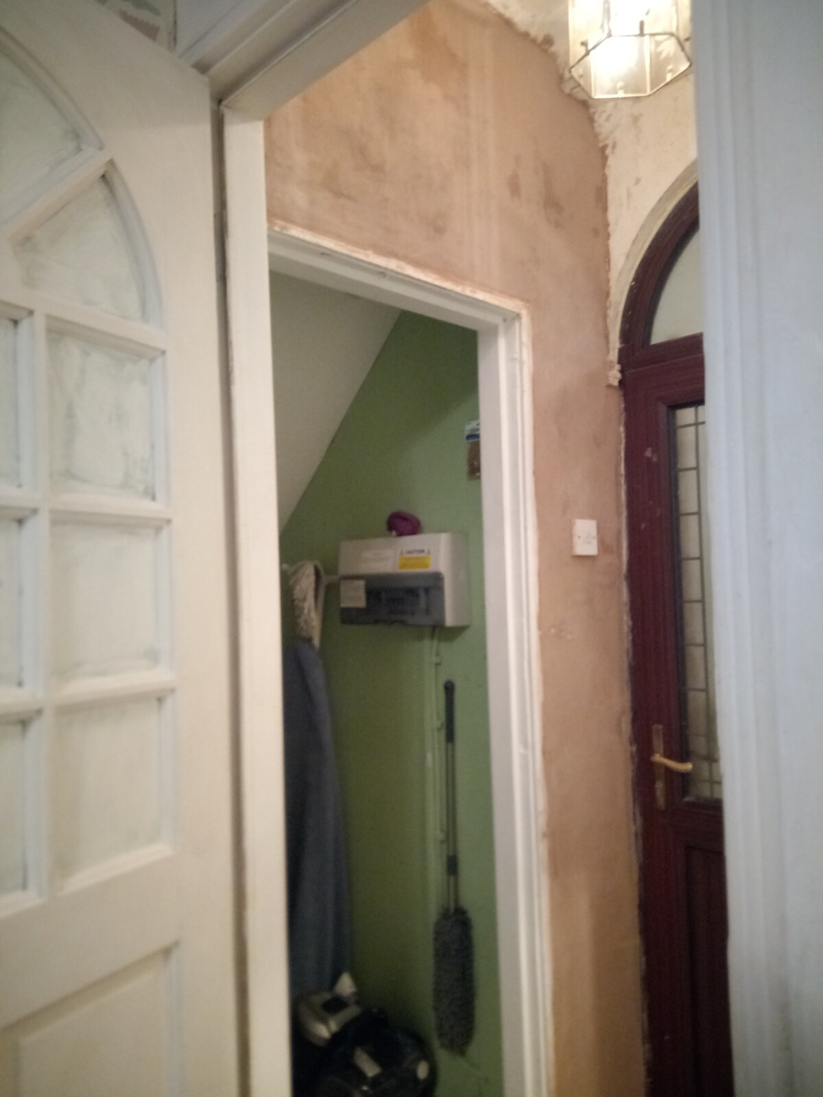

Hi Guys, can you please help me? I've messed something up but I'm not 100% sure what. I plastered a wall in my hallway today, I was pretty happy with the result but DIY dream has turned to DIY nightmare.
I've gotten an electric shock (not flying accross the room but ow type of tingling and yanked my hand away immediately) just now from the light switch on the wall. Plaster has been drying for about 4 hours. I've turned off the lightswitch with a piece of wood and turned it off at the consumer unit, but beyond this what needs doing to make it safe? Does it need to dry out/need a new switch or does an electrician need to do a full test of it?

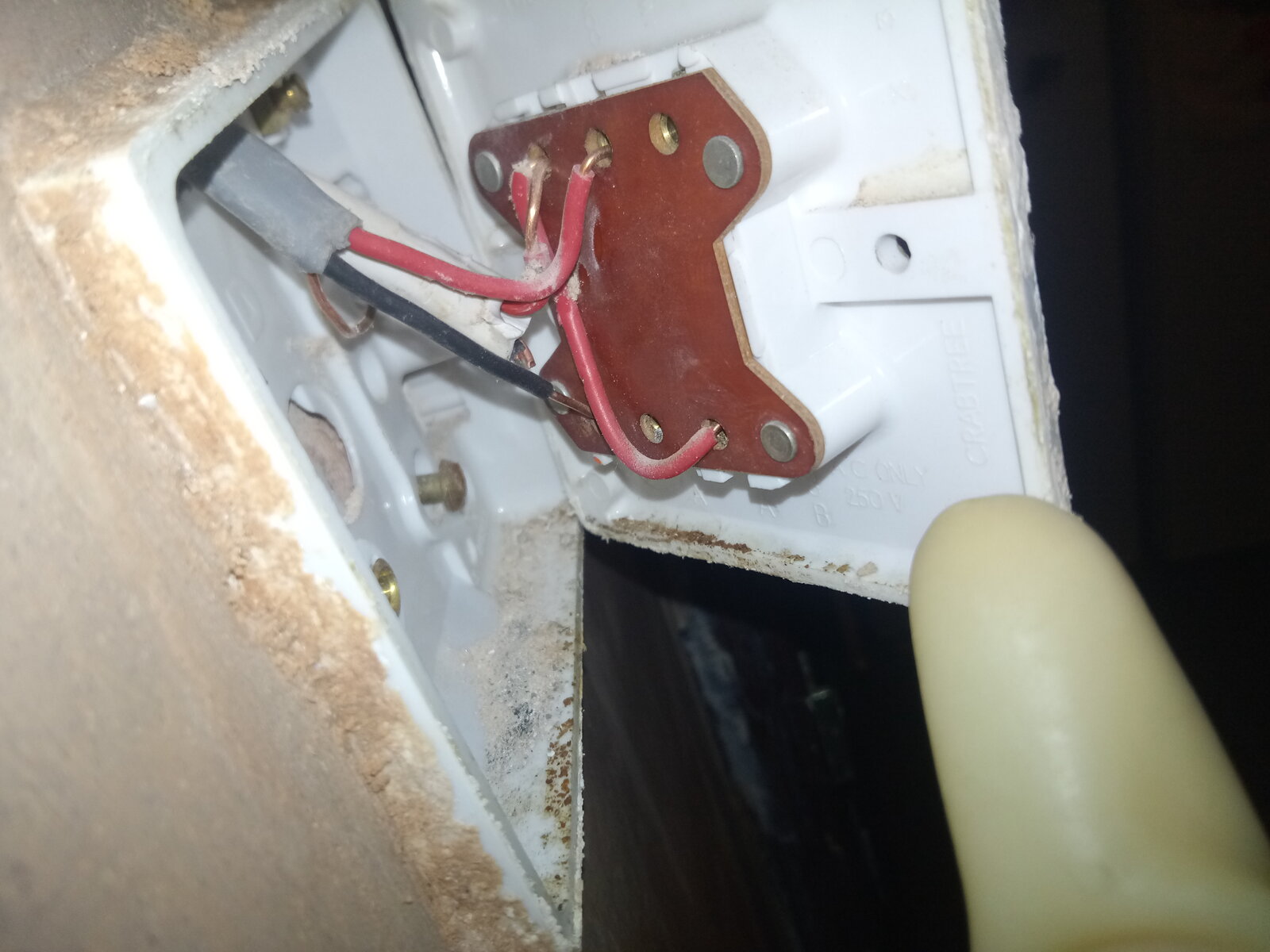

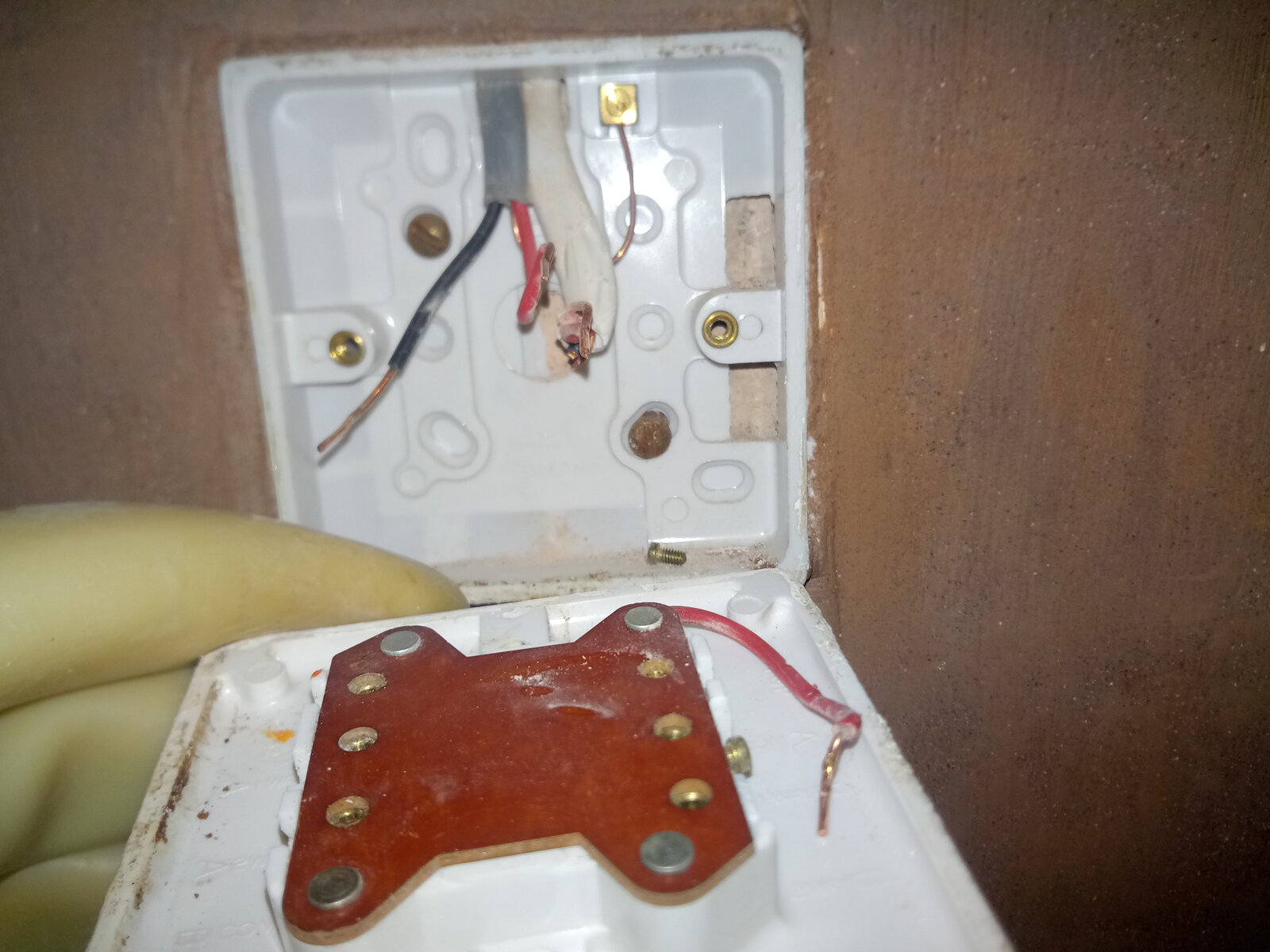

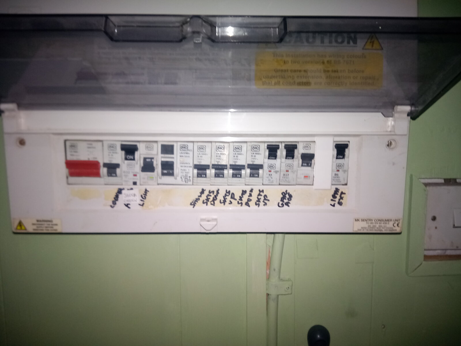

Hi Terry,
Its a plastic switch. I've attached a picture of the consumer unit, sorry the lights are off so not the best one. I'd already just screwed off the front of the plate and there was a bit of loose red wire in there, it looks like it was being used as a repair of sorts? The neutral wire coming out of the right hand cable (white) is not long enough to fit into the terminal.

Hi Terry,
A bad wiring job in the first place.
Do you know where each wire went?
You will need to strip some of the wiring back to re-terminate.
Wires can be extended with 1.0mm2 cable and 6 amp connector blocks.
That is a plastic box intended for surface mounting. It looks like it might be 1960's wiring (no earth). Do not fit a metal faced switch, it would need to be earthed.
The bare wire, with the white sheath needs to be sorted out, its a terrible botch.
Any plasterboard nails, screws, angle bead been used?
Hi Sparkwright, yes I used a metal stop bead the length of the brown door on the right. I've put a tack through a cable havn't I?

I think the fault is most likely to be at the crumby wiring at the switch, that's the place to start.
Both cables appear to have bare earth conductors ,the white sheathed cables cpc isn't connected up to anything. Poor wiring for sure .
I can't see the consumer unit clearly ,but it appears that the lighting circuit in question is not RCD protected ,can anyone clarify ,I am only viewing on a phone at present.

Thaks Sparkwright, yes I took some pictures before I disconnected it so I'm reasonably confident I could get it back how it was before.
Thanks Harry, how would I sort the bare wire? Does it need replacing or would some insulating tape around it do?
Hi Terry, how would I tell? Sorry in my ignorance I thought that having a lot of individual switches was RCD.
