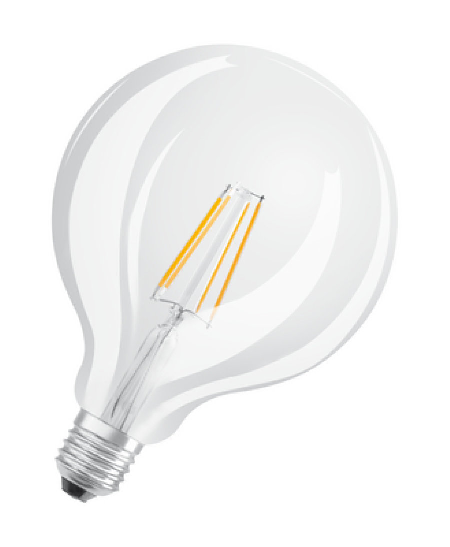

I found a data sheet for the Osram P RF CLAS GL 125 6.5 W/827 E27 and it seems to be Retrofit CLASSIC GLOBE. So is aimed more for how it looks than for a set output, however it does say 806 lumen which is not a bad output for a 6.5 watt bulb.

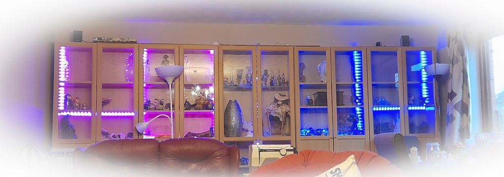

We have one odd lamp with LED filaments. These lamps 1692830699933.pnglike you have fitted should give a better spread, however when visiting pubs with these lamps I have a problem reading the menu. They do seem mainly used for decoration, but my cabinet lights are designed for decoration 20230227_170703_1.jpghowever turn to white and also reduce the dimming and they can add a huge amount of light to the room. All lights on, and at max, likely around 120 watt of lighting in the room, although rare they are all turned up full.
