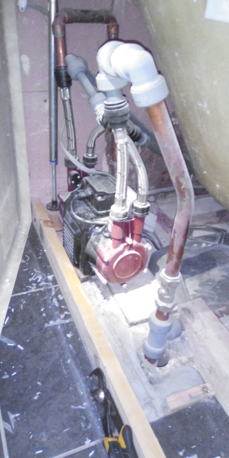

A picture of the situation behind the bath, in case anyone's interested:
You can see the functioning bath support strut at rear left - I believe the one which has collapsed is attached to that block of wood at bottom right. As you can see, the piping is very close to the shell of the bath.
With the pump now exposed perhaps someone should sit in the bath with the pump running so that the growly noise starts, and then locate where its coming from (which is presumably the pump) and push and pull the pipework around the pump to see if it stops. Then devise some further supports to keep the pump in the position where the noise stops.
I guess you'll need water in the bath to be able to run the pump, so the bath occupant will probably need a swimmimg costume unless everyone is close family!
