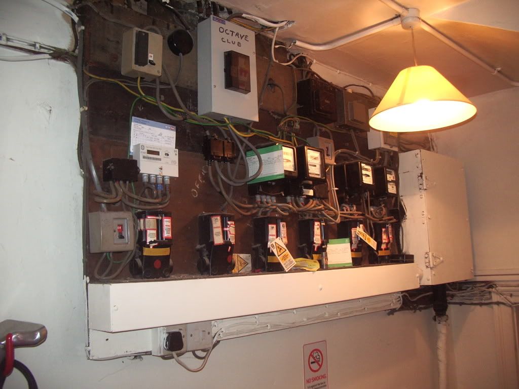

I know there isn't really mch to go on, but see if you can work out what is wrong in this picture.
This lot supplies a working mans club, a sandwich shop, and a clothes shop.
Yellow lampshades dont suit switchrooms... I think electric blue goes better :lol:
One of the incomers doesn't appear to be in use. Where's the main earth coming from :?: :!:
All that lot for one socket, one fcu and an illegal 100 watt (whoops 60 watt) lamp. :lol:
What are the rules & regs on the supplys on the far left.
i.e having twin and earth cable (small diameter) connected to the supply with unsuitable fuse size.
Would like to know for future reference.
What do you mean? How do you know the fuse size? The cable looks quite substantial to me, 10mm or 16mm.

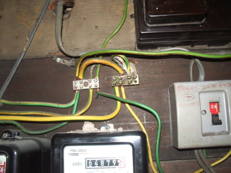

And I'm going with there being no main earth. The supplies all go back to the MET, but I cannot see a alink to the suppliers cabinet on the right.
