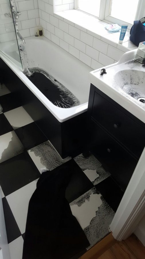

Hi all,
Thanks very much for your answers before. I finally got my management company to have the drains cleaned from the outside and it completely flooded my bathroom with filthy water. As I wasn't told it was happening and wasn't in when it happened it has left quite a mess of my bathroom. The management company are claiming that it only flooded because of a problem with the way my plumber did works when I had a new bath, shower and toilet fitted last year. The gurgling problem existed before I refurbished my flat so I think this sounds like excuses! What do you think? I have asked for more details on why exactly they think this flooding is due to my plumber's work but don't have any details so far. Your help is much appreciated!
How did they clean the drains? Internal flooding can be caused by a blowback when high pressure water jetting is used to clean sewers.
I cannot see how the way the appliances were fitted could cause an issue suddenly, especially if you weren't even using any of them at the time. Can you photos up of the mess? Still sounds to me though like a blowback, which is down to the drainage company that have done the work, they should be insured for this type of eventuality!
Thanks Hugo, that is what I suspected.
I just have one photo which I have hopefully uploaded.
FFS: it even made it to the basin! Or is the mess in there due to an attempt at clean up on your part?
