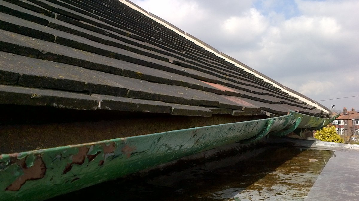

4. Picture 8 shows his guttering at the front running in all directions...It actually looks like there are bends in the guttering but this is just an optical illusion as cast wont bend or warp !!!
5.Picture 9 shows the rusty six inch nail he banged into his rafters end to support his guttering !!!! It also shows ( but you have to zoom in to see it ) a black cast bracket taken from our side of the property and fitted on the end of his guttering to support it...You can also see that by fitting the packing and bracket that this has lifted his guttering approx an inch off his rusty nail .......
6. I didnt attach the last picture but i think this picture is the most damning of the lot. If you look closely you will see his gutter dipping down to the left where it joins onto his UPVC down spout..You can also see no other brackets supporting the entire length of that peice of cast !!! You can also see that it has dropped so much that it is pushing the next length along upwards and off the bracket that is meant to be supporting it..Carry along to the next length and you can see that its pushing the last length of cast down at the beginning and upwards on the far side !!!I beleive these pictures to show the state of his guttering and it jsut amazes me how the "surveyor" didnt comment in his report to the insurers just how badly maintained their clients guttering was !!!!!

I see a shallow pond on that bay window roof top, and I see a big green gutter sagging in the middle due to its own gravity pulling the earth upwards, and that joint seems like it is a fire escape for the little ants.

Station, You need not worry mate, pictures are clear enough to show the state of his gutters prior to your renewing your gutter, there was no soffit, and his gutters were sagging and supporting brackets were inadequate, in one place as you said a 6" nail was used to support cast iron gutter, and in any case the gutter has to slop towards the center shared downpipe, otherwise water from both his roof and your roof could run back towards his side.
You have not caused any damage to his side, instead you actually strengthened it more by providing him with a proper bracket where that nail was.
Your neighbour has devious intentions, as he couldn't bear the fact that you renewed your side of the gutter and his one looked old & worn out with flaking paint, with sections sagging and poorly joined, and although your roofer may have disturbed it a little causing one or two joints to start leaking, but your responsibility would have been only to fix any leaking joints, not the cost of a new gutter and new soffit.
You owe him nothing, just tell them that you will see them in a court as you have proof of the state of his gutters prior to your roofer started work on it, backed by photographic evidence from Google street images.
The water collected by your gutter had to fall into his gutter hence it needs to be lower than yours, and his gutter has to have an end cap, but was your old gutter joined together in a same level as his to the funnel and the downpipe?
I can see obviously you had to raise your gutter over his as yours is PVC and his was old cast iron , so you couldn't have easily connected to the funnel at the same level as the sections would be incompatible, or different shapes, but you could have improvised a solution of some kind, where two different shaped gutters meet and one can improvise a little bodged joint but effective using mastics and what not.
He is probably pi55ed that your new gutter now falls into his rather than a joint in at a same level.
