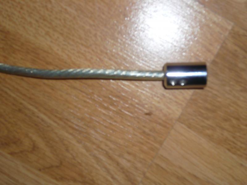

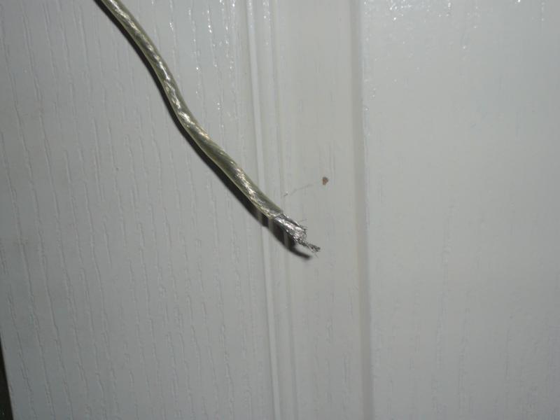

A single round cable with transparent insulation, external diameter between 4.5mm and 4.9mm (need to be fitted in a 5mm diameter hole as in the attached photos.
It seems that the cable is reinforced (internally) to carry its weight plus the light fittings.

OK, so measured up (ooh er) and I have 8 metres, external diameter is in the area of 4.5mm. It came as part of a kit, so I don't have a supplier for just the cable alone.
Also, there is no internal 'reinforcing' wire as you describe - it looks extremely similar to what you have, but it's simply translucent plastic coated stranded steel wire. All the conductor material is exactly the same throughout, but from your description I get the impression that your cable has a steel reinforcing core surrounded by stranded conductors.
Here's a picture, if it helps: View media item 8997

electronicsuk Many thanks for spending the time and effort to help out. Just one remark, I looked again and it seems that the reinforcement is not a steel wire, what you can see is 2 different stranded wires, a small one that is surrounded by a larger stranded wire.

electronicsuk Many many thanks, I received the cable and it is too small, I measured it and it is about 3.7mm. it was a good try and much appreciated.
