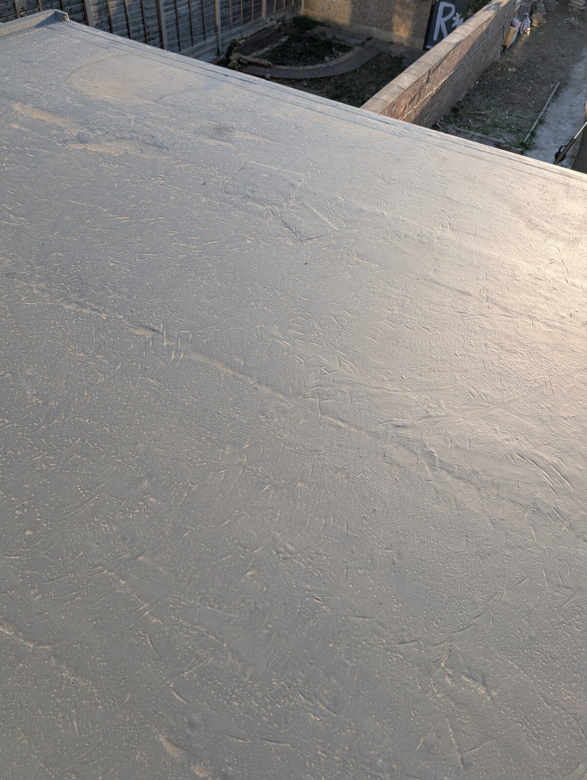

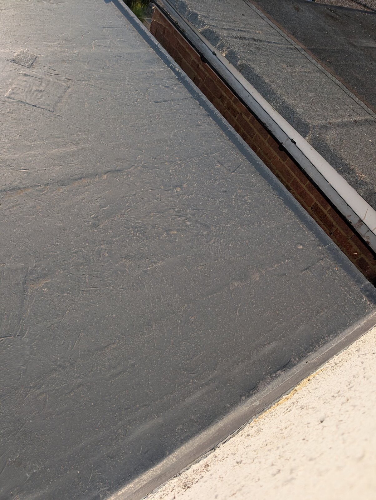

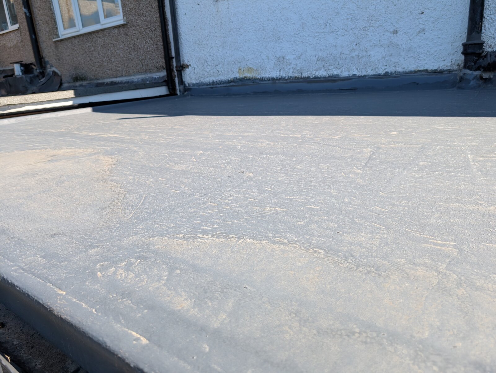

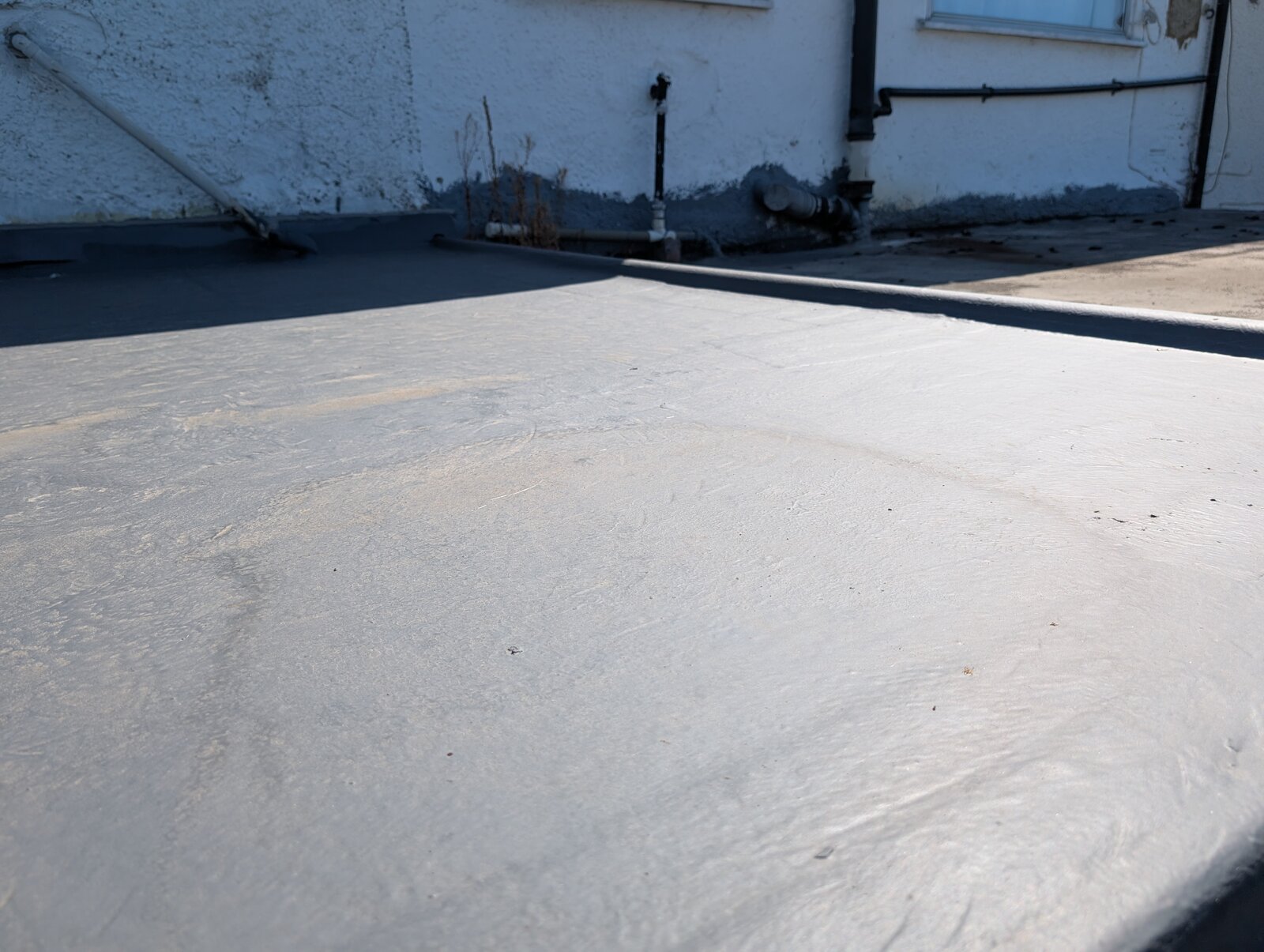

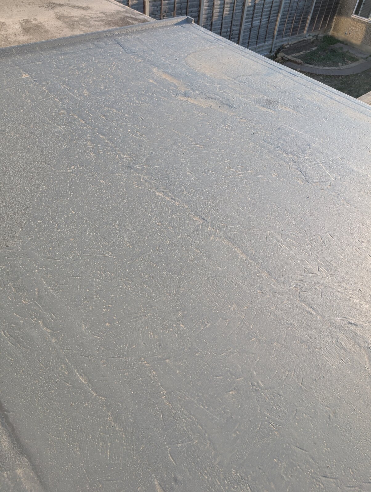

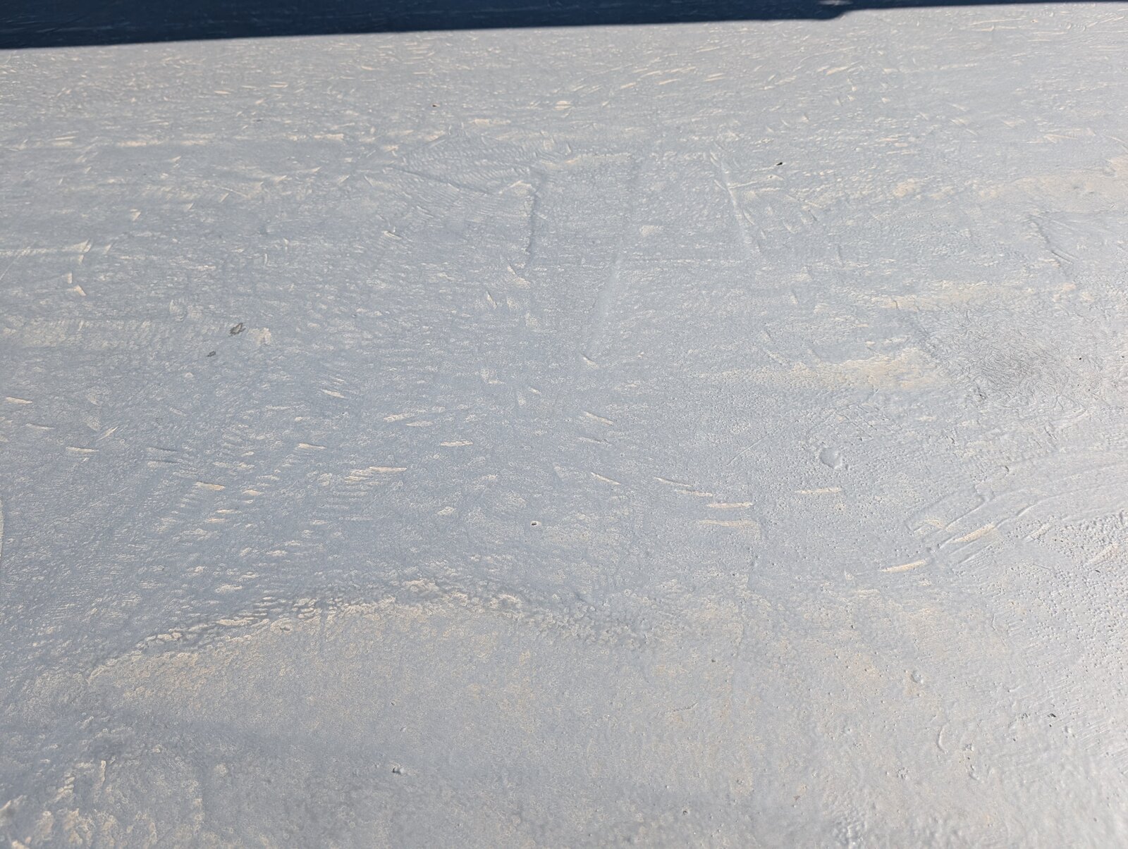

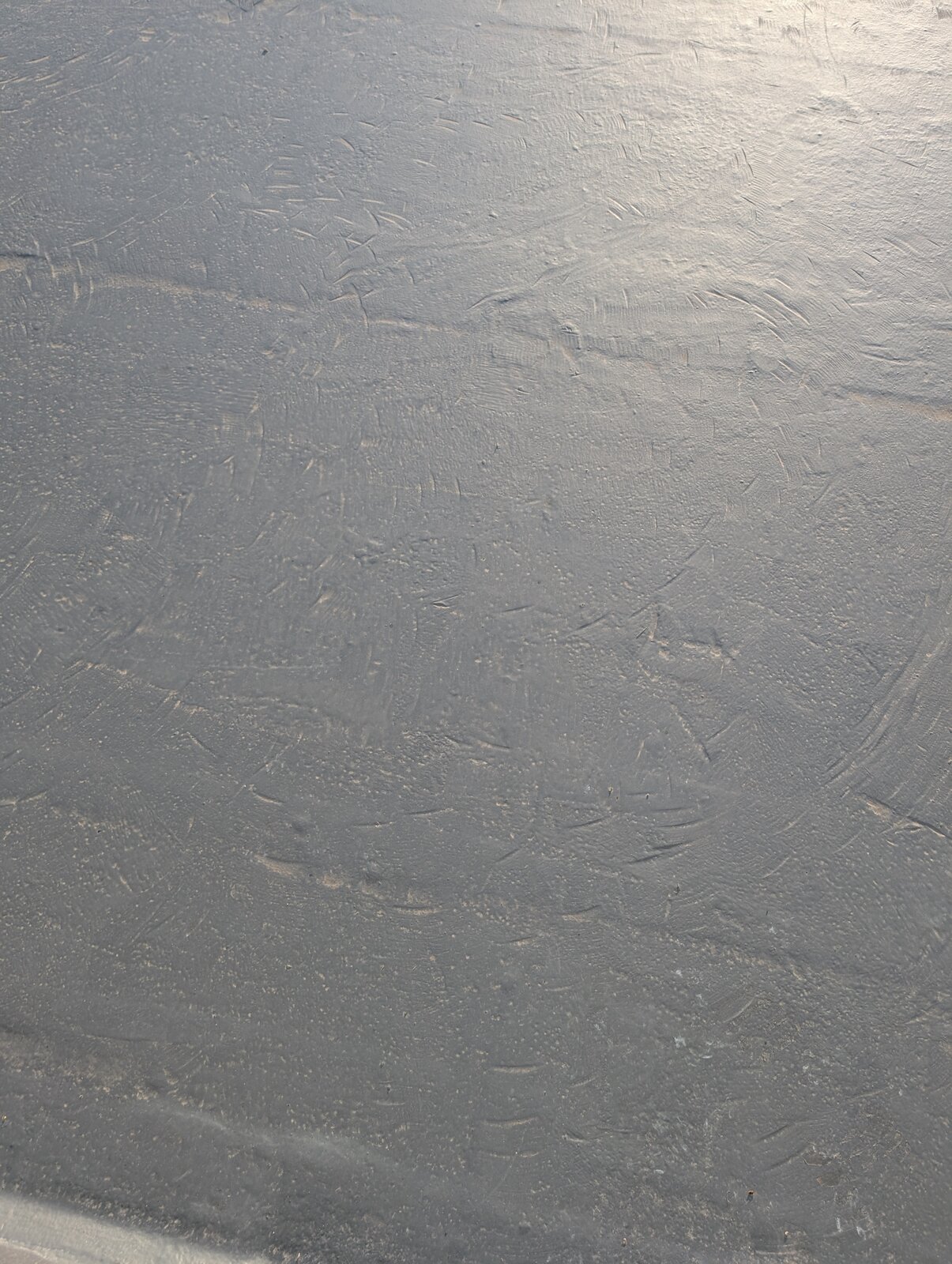

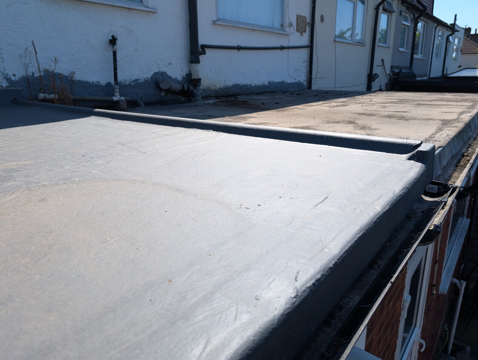

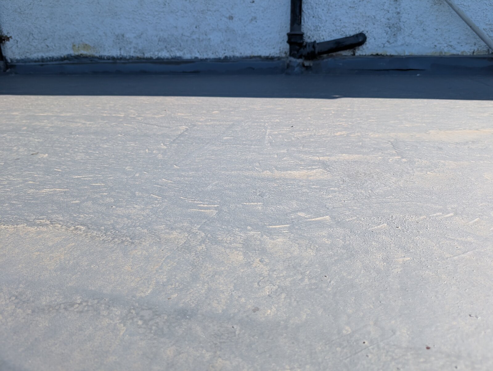

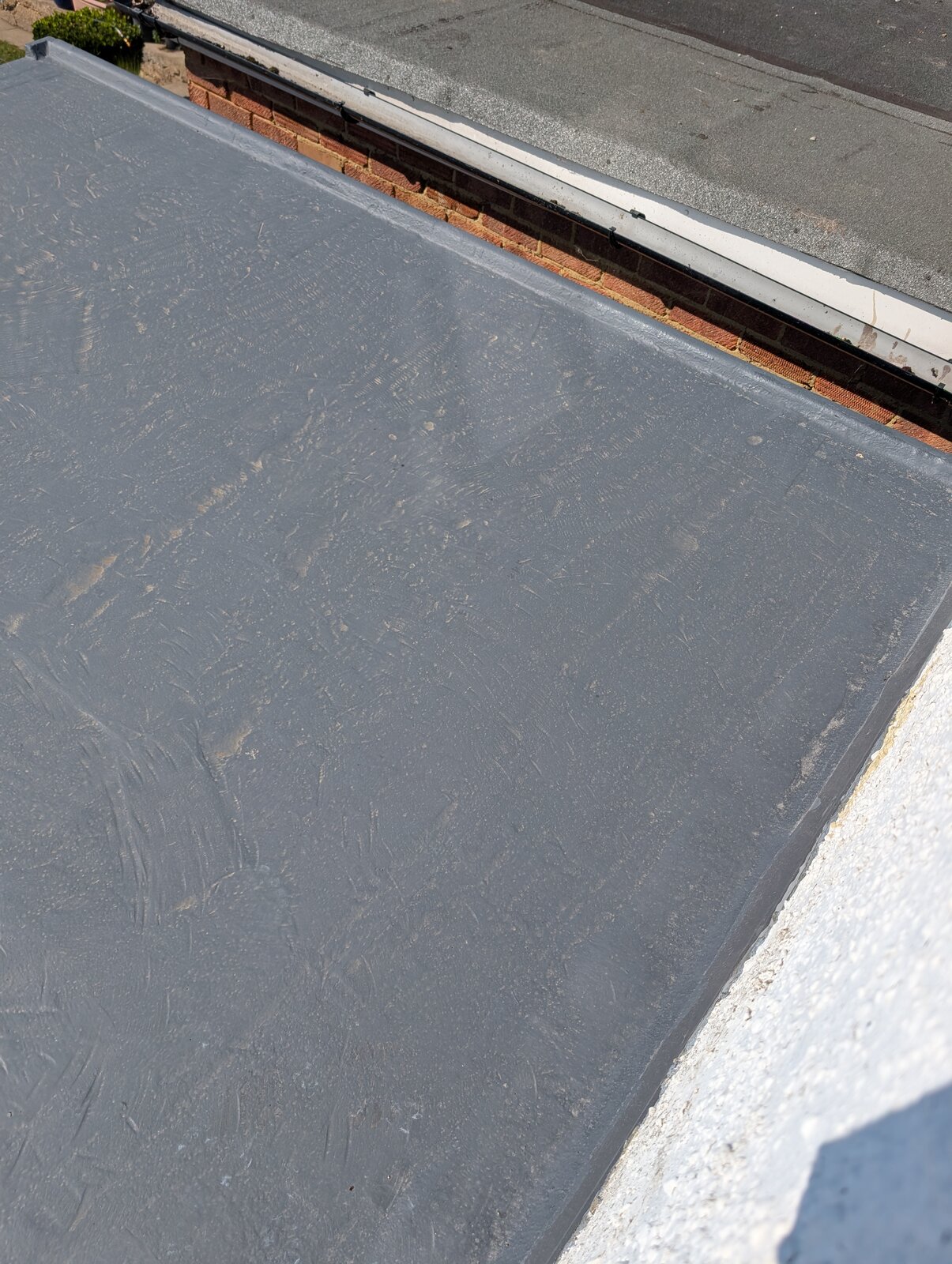

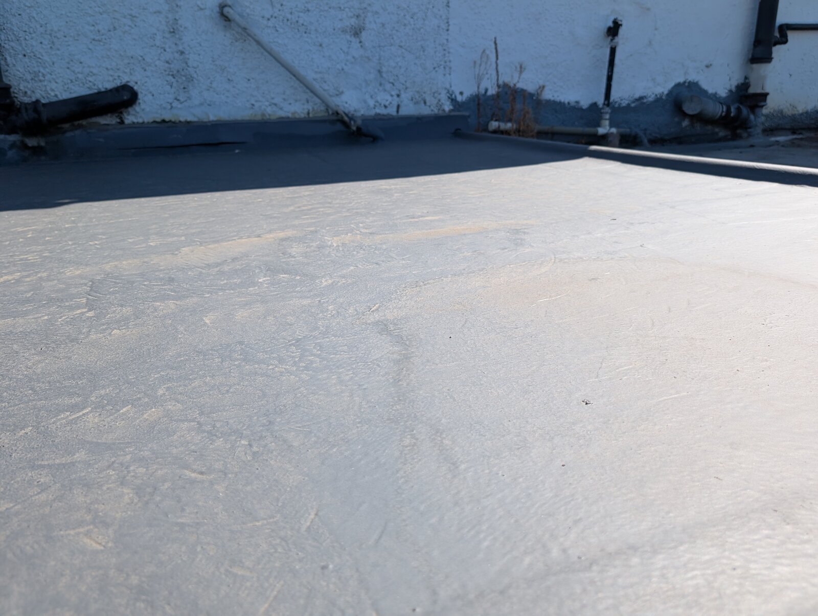

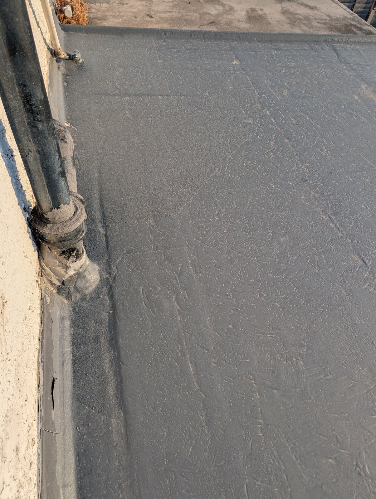

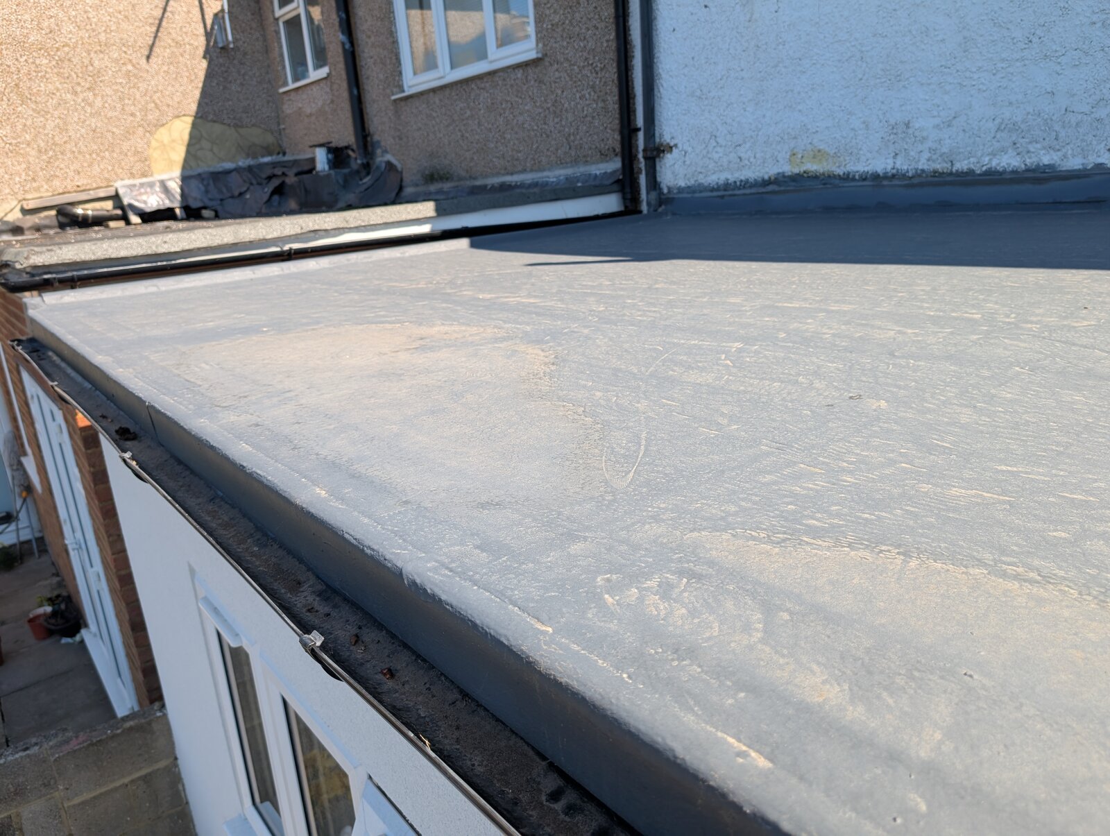

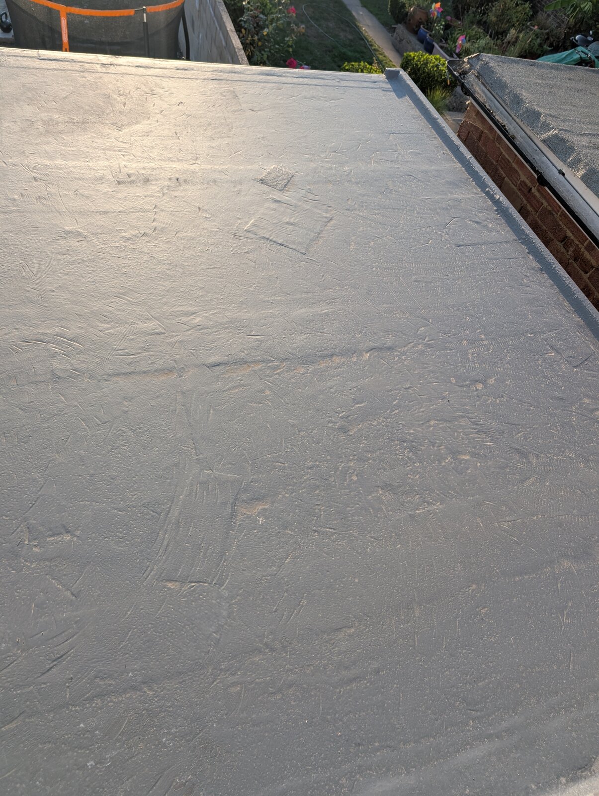

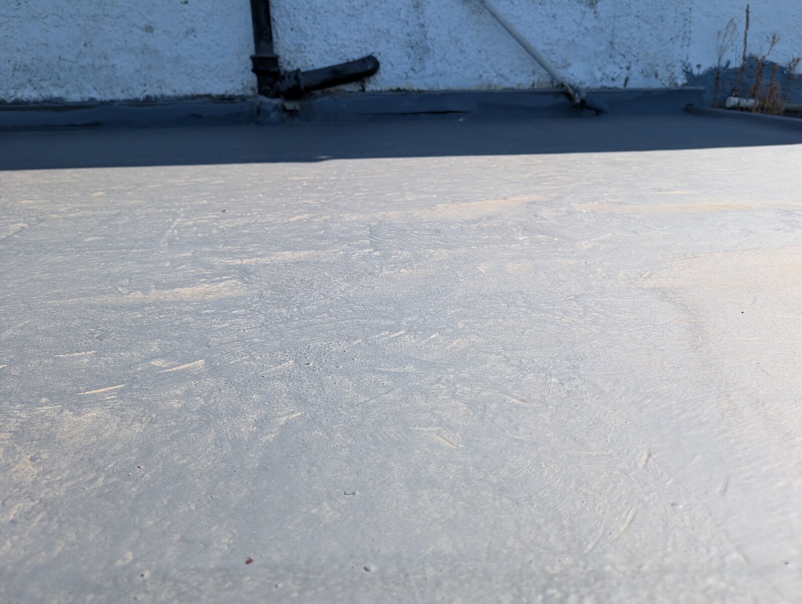

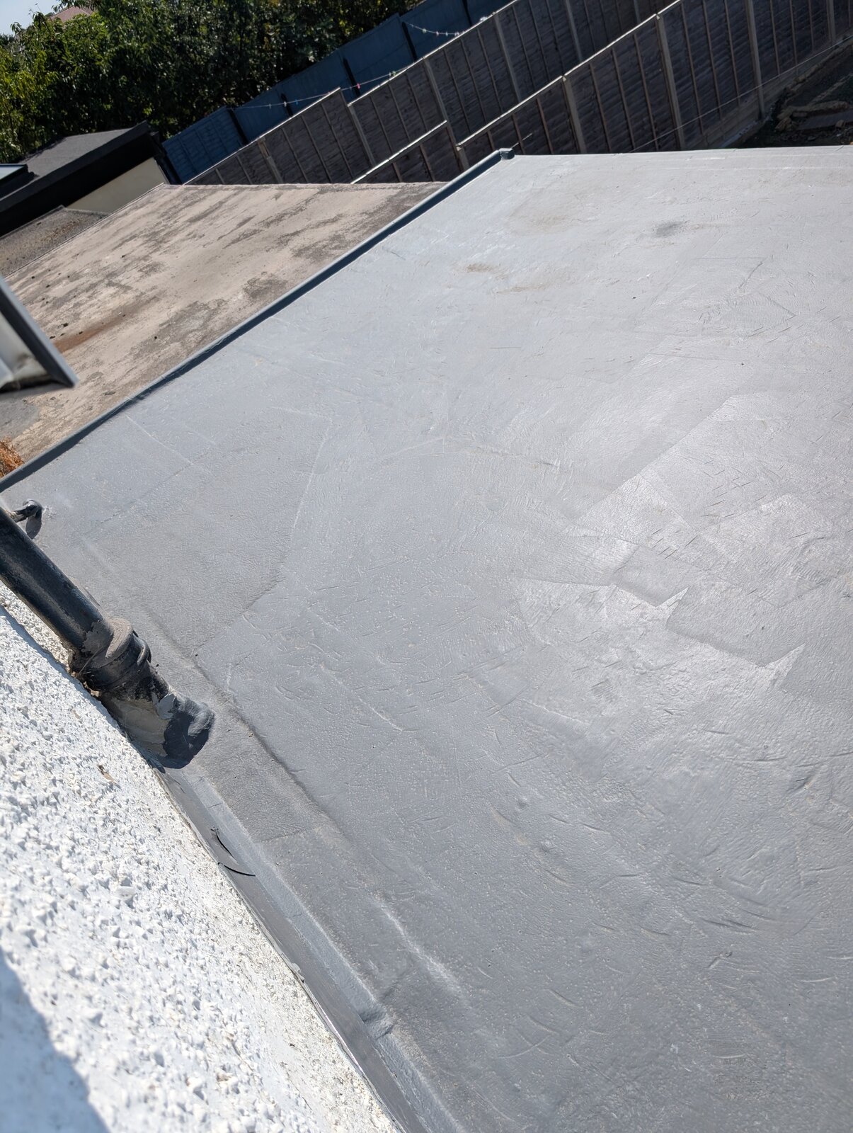

Hi all,
About 6 weeks ago I had a new flat roof installed (new timbers + GRP). From the very start, the roof didn’t look right to me - there are multiple visible patches (I counted at least 10), and I even had a leak near a drain pipe. I asked the builder to get it repaired, but the roof still looks like this (pics attached).
My builder, who subcontracted the roof work, told me that patching is normal - he said patches are used to cover bubbles that appear during installation. But from what I’ve read online, bubbles generally indicate incorrect technique or poor workmanship, not something that should happen on a properly laid GRP roof.
For a brand-new roof, I would have expected 0 patches.
I’ve spoken with a couple of local roofers, and their feedback has been very negative:
  • One said the work is “shocking” and wouldn’t survive a proper downpour.
  • Another said he’d be surprised if it lasts 5 years.
That said, I don’t want to rely purely on their word, since they might be exaggerating to get work out of me.
So I’m asking here: if there are any GRP roofing experts, could you please take a look at my pictures and let me know your professional opinion? For context, I believe it’s a cold roof (insulation between joists, above the ceiling).
Thanks in advance!

I'm no roofer and know little about these roofs.
However what I do know is - that looks crap!
Not surprised.
I would have deffo had a conversation about future proofing that drain set up, i.e. renewing the SVP in plastic then bossing the basin waste into the stack. The roof could have been weathered much easier that way.
The roof finish is diabolical.
Doubt the originals guys will sort that out. They are just cowboys...
