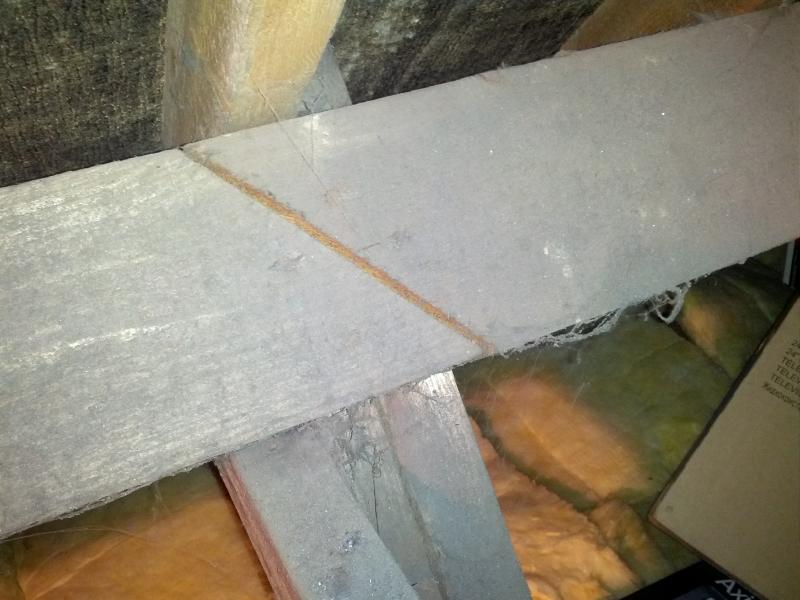

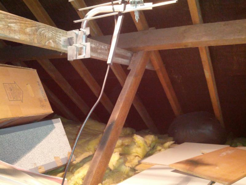

Hi I do plan on taking a couple of simple pictures showing loft but basically wanted to know If i can remove the existing diagonal timbers that go from the floor to the purlins. The purlins are hefty things and look in good condition as does the point where they are fixed in the walls. There are three sets of timbers which are not equally spaced and go diagonal from floor to purlin then a horizontal piece across the two diagonals. I was hoping that i could remove these and put vertical supports directly under the purlin to the floor, perhaps every metre?
The house is mid terraced 1950's 3 bedroom.
The only reason for doing this is to add a floor for storage as the diagonals are in the way currently.
Any advice appreciated.
Russ

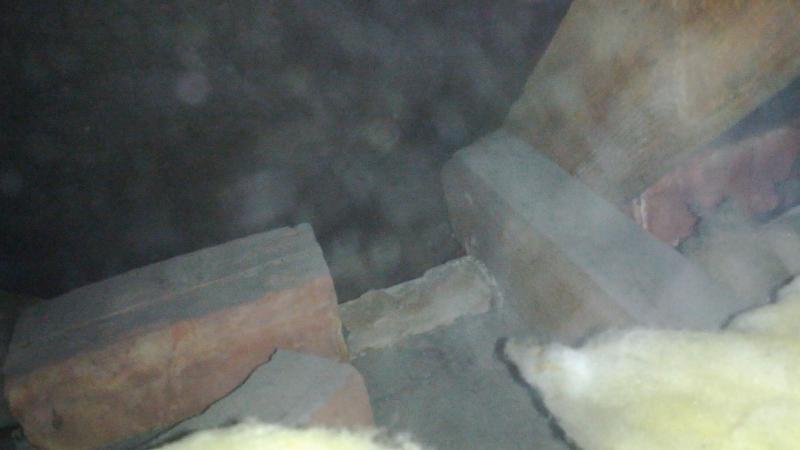

Hi, it was suggested to me that they were there as a temporary measure when the property was first built. I have had a closer look and took a few pictures and my thought are they dont look temporary to me. Now i have had a closer look I can also see the purlin is not one continuous piece and is joined. However I am still hoping the supports can be removed and replaced by uprights direct to the underside of the purlins. See Roof Support pictures. I have more if required.

They are supporting the purlin to reduce it's unsupported span. So you should not remove them

Probably change the purlin for a steel beam
You wouldn't be able to just remove the diagonal post (purlin post) or the collar (horizontal timber) and build a frame vertically down onto the ceiling, due to the fact you would be transfering the roof load to your ceiling. Your ceiling will probably not be strong enough to take any roof loads.
Replacing the purlins with Steel would be a good option (although costly). I'd try looking at using a EWP product (engineered wood product) such as Timberstrand, Glulam, Ultralam etc.
Try contacting a local roof truss manufacturer/ Engineered joist supplier and asking them. IF they carry the product on the ground, most should be able to provide an idea if a EWP product would work.
You say that you cant remove the diagonals and replace with vertical frame to support purlins due to load transfer to floor. Surely the diagonals are placing load on the floor as they are? I have had a builder and he brought what I assume to be an engineer/architect and they seem to think the posts in question can be removed without too much of a problem. I think i need to get a few more people in to see if they all agree.

The diagonal beams will be placing loads on the ceiling but below that will be the central supporting wall to take that weight from the roof.
