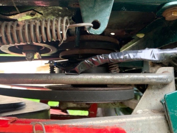

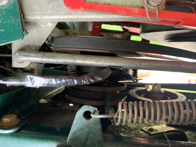

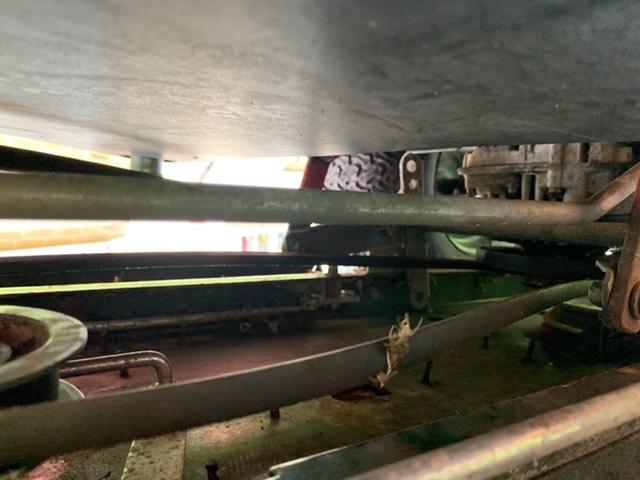

Hi, I have finally got the engine on this mower running again and have a new tranmission belt. I have also repaired the wiring that was ripped out when the belt broke previously. However, while the engine runs the mower still won't move/drive. I am guessing this is a problem with the hydrostatic clutch which makes me wonder whether my repaired wiring was not right. Any ideas on where I should look next? When I disengage the brake and select to move forward (or reverse) there is no response and it doesn't look like the pulley or belt are moving. I'm kind of learning as I go here so not entirely sure what I should check next but I would assume that the main wheel/pulley directly under the engine should be spinning when the engine is running.

With a hydrostatic transmission, this is driven continuously by an upper belt which is basically untouched - its under tension all of the time and drive is engaged by pedals.
The electric clutch is driven by the lower belt just above the deck and is used only to engage the cutter blades and has no connection to the transmission.
Can you confirm?

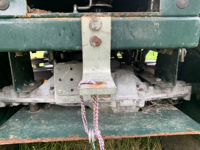

There is a free wheeling device lever which disengages the hydrostatic drive so the tractor can be pushed without the engine running Its usually operated from the rear above the axle,
Yes, the lever is to the right of the seat. However, this now doesn’t do anything. What should this drive (even if the main drive belt is not in place)? I assume the main wheel directly under the engine? If the clutch is not operating correctly (e.g. because the wiring is not right) then I assume this might stop that wheel from spinning?

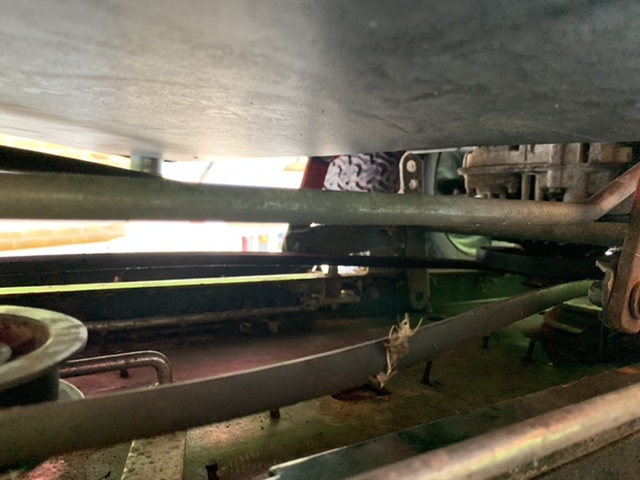

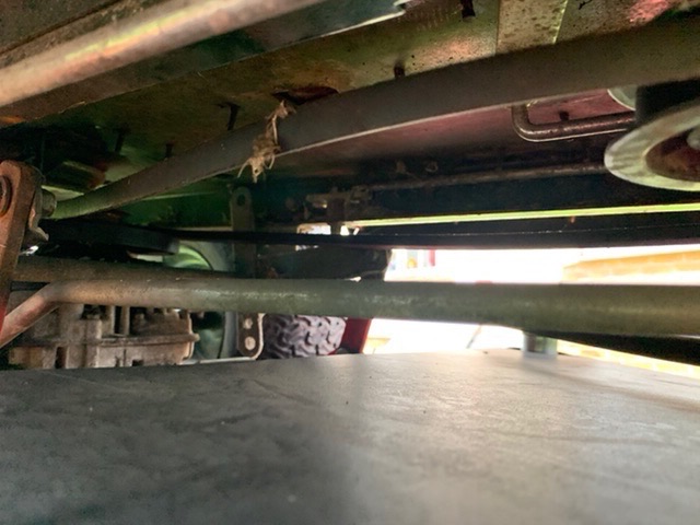

F25B30A4-5C2C-4BCF-8B2B-32EA348ADF20.jpeg The transmission, thin upper belt from crank to hydro axle as John says should be running all the time, provided the parking brake is not engaged so check the pully on top of axle is turning.
The thick lower, blade drive belt only runs when the electric clutch switch is activated and is nothing to do with forward and reverse motion
The lever on the side may be the one that engages drive to the power sweeper grass collector . can you post pics of your controll levers

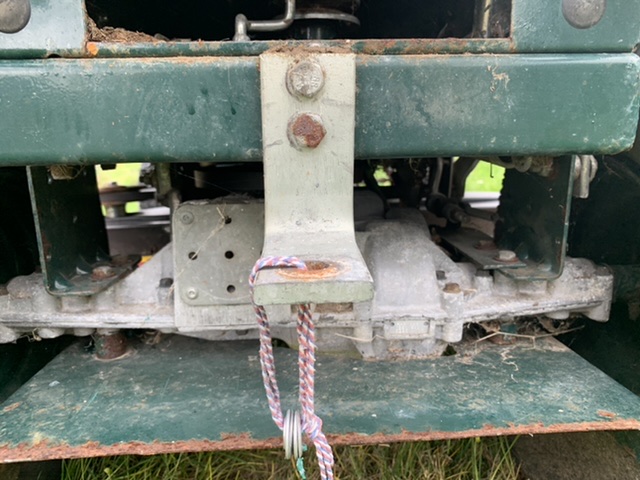

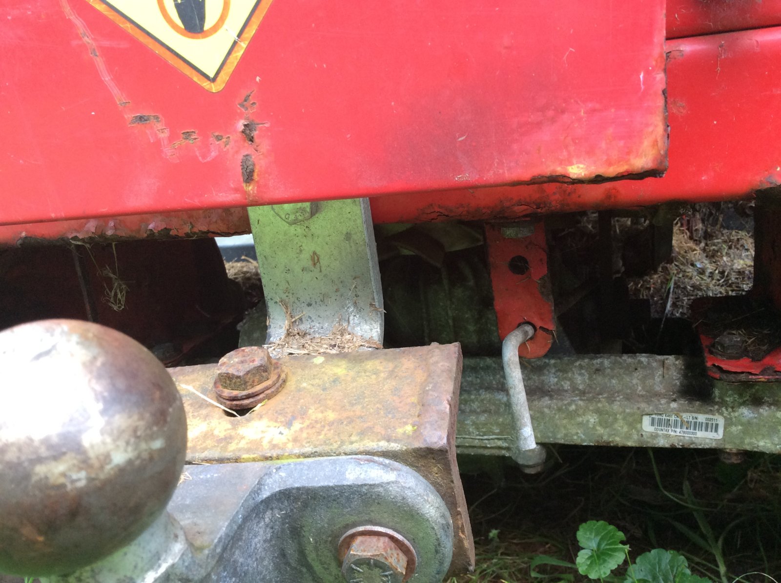

pic shows free wheeling lever on countax

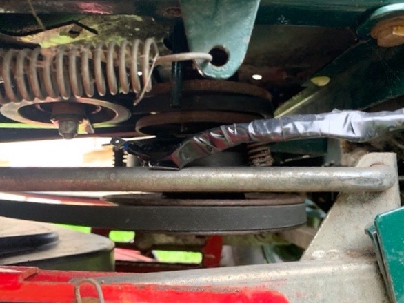

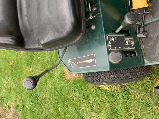

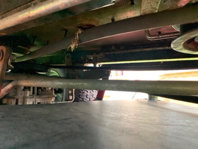

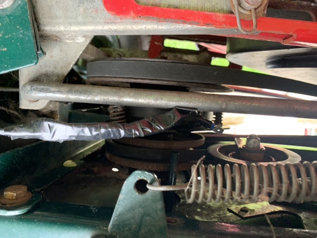

Can’t see any pulleys running at all which seems odd as I’m sure they were previously. Have attached some pictures to see if they help. Can’t find a freewheel lever either but wonder whether there is one somewhere.

Picture 2 and 3 seem to have uploaded upside down.
Better?
As I thought, the levers on the right are deck height and pto for rear collector
are there any peddles on the right deck floor or is the lever to right of seat the hydro control? if yes to latter, that may be why there is no lever above the axle
