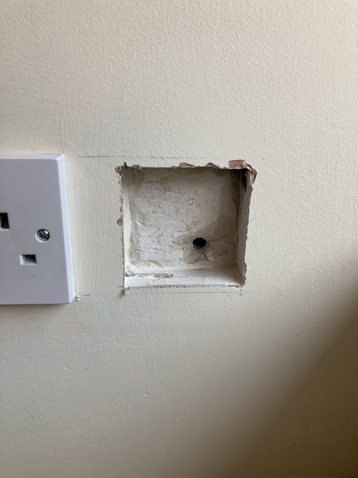

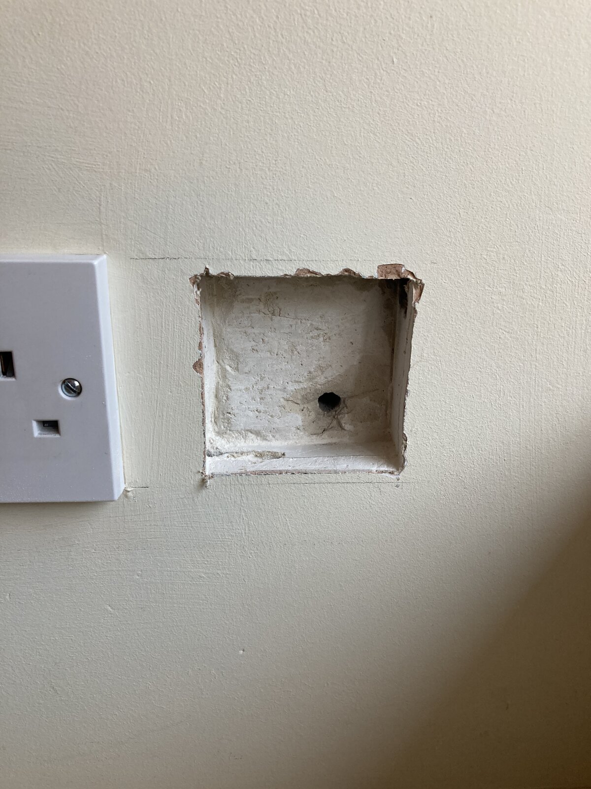

I ran the Ethernet cable round the house and not wanting to drill from the inside outwards I went to the trouble of taking measurements thro a window on the adjacent wall and transferring them round the corner and down the side of the house ... luckily it landed in the right place. :D
Impressed, or what?
Time to get a Lottery card, I think ;)

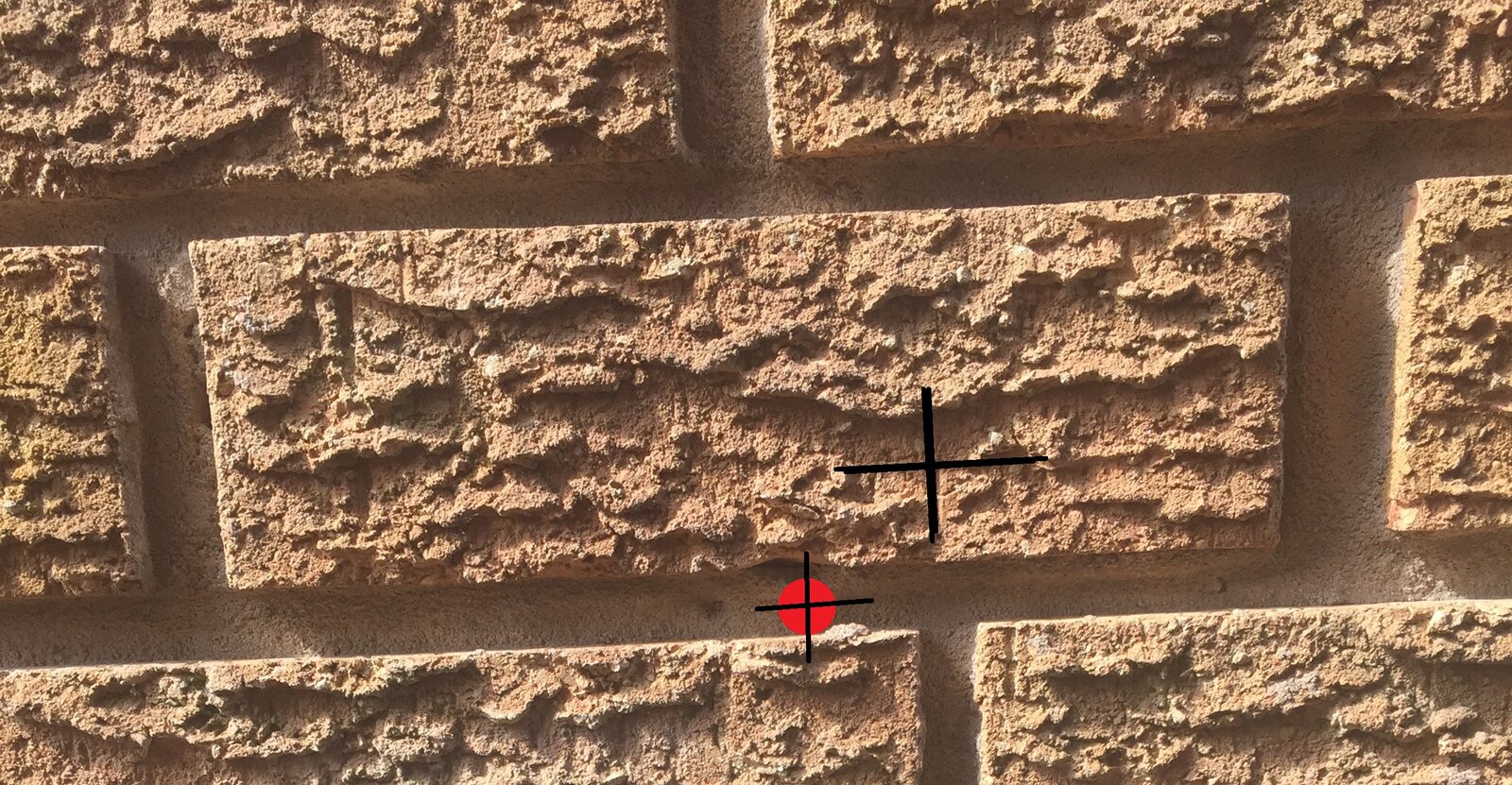

It was lucky ... the centre of the back box landed on a brick - but exactly the right place to go down and across a bit to pass thro one of the knock outs

Harry Wrote ... Time to get a Lottery card, I think ...
Well played.
Don't forget to loop the cable downwards (on the exterior) to prevent water running along the cable and into the house.
