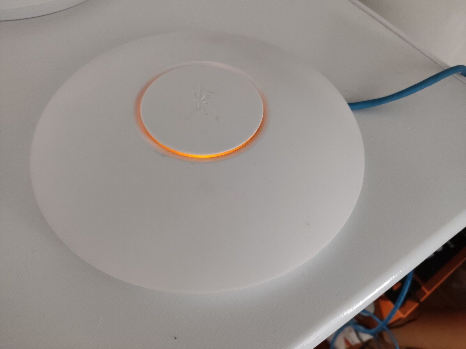

It still says "please wait" so we can assume It 's not working. I have been using the "stand alone" option, not the "console" method.
Well, I got one of these things
Plugged it in yesterday. Didn't see any improvement yesterday, upstairs speed check was about 23 MB yesterday.
The tablet ran flat overnight. After restarting I ran speed check and it was 120 which I thought satisfactory.
Tried again just now and it is down to 42.
Adequate but I don't know why it's dropped.

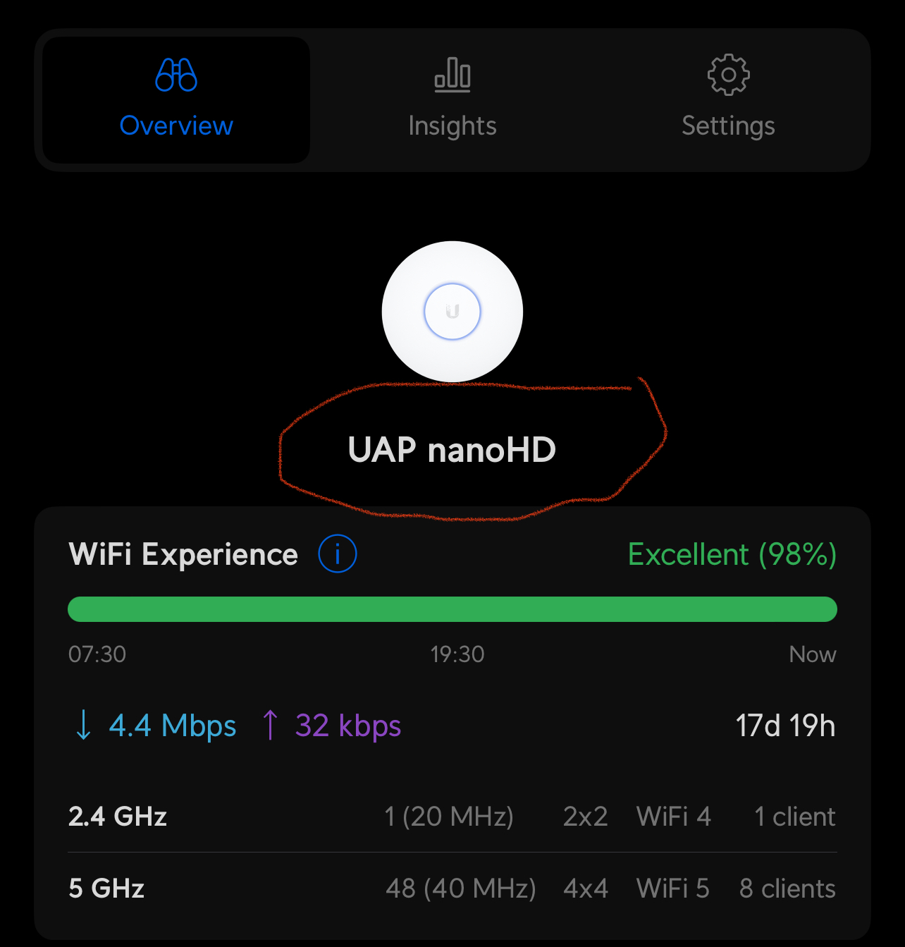

Can you share the model number.
I agree it should be blue; I have two of those although have a lot of their other kit with the management interface built in (Dream Machine Pro), but as others have indicated, that’s not needed as you can manage them independent.
The orange means it’s waiting to be adopted (terminology they use to say it’s been commissioned).

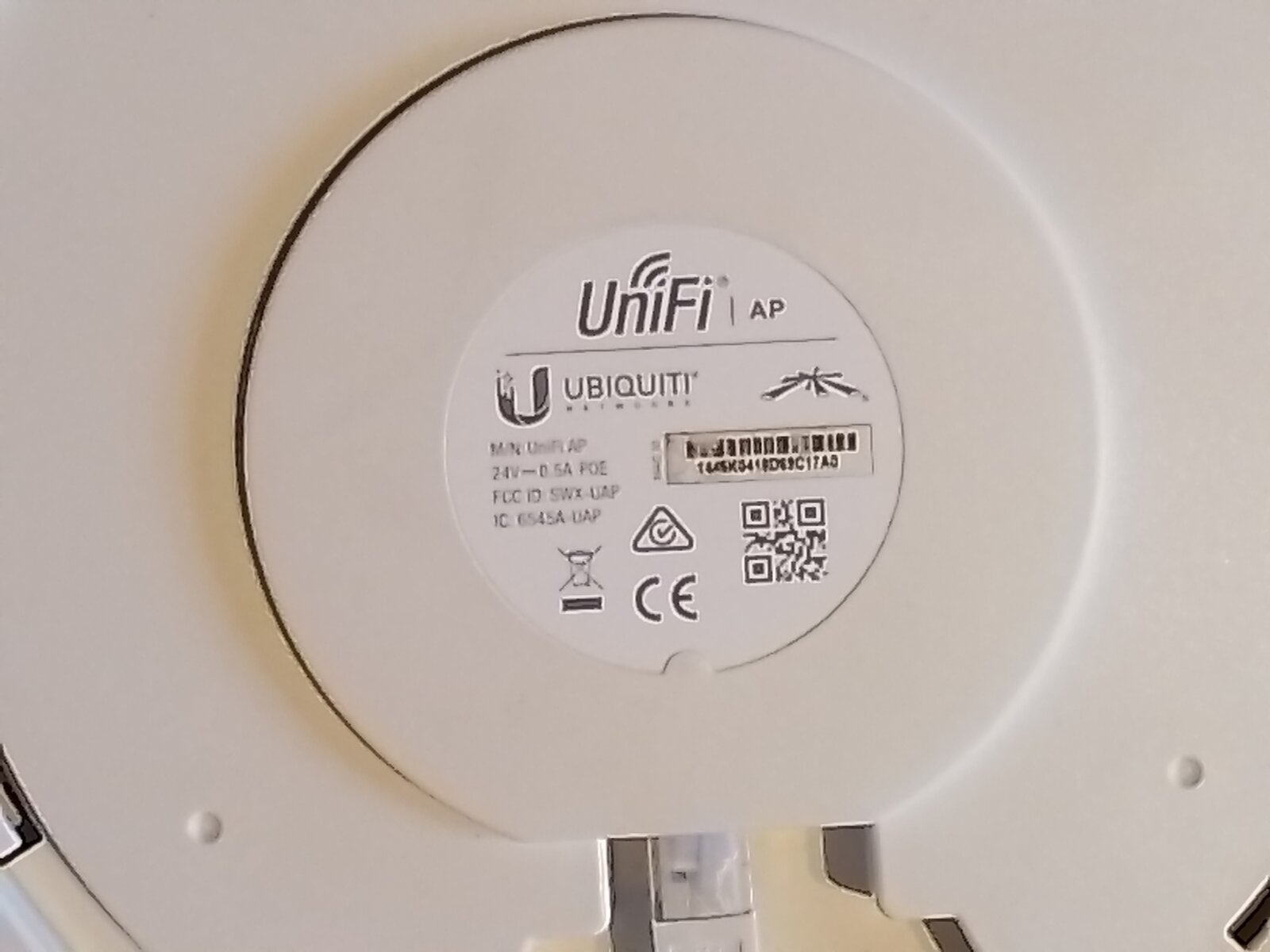

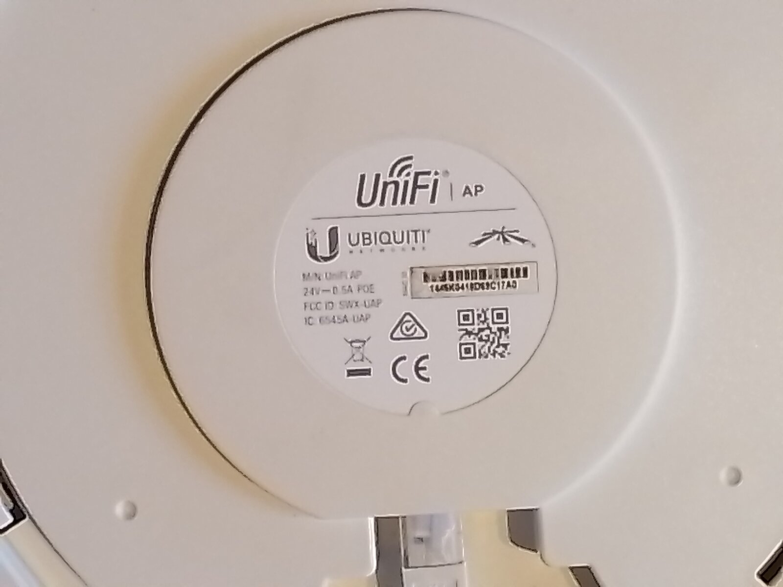

Where is the model number?
I think it might be relaying on my normal network address as the WiFi speed is faster upstairs.
Usually on the back or somewhere in the software where you’re trying to update it, it would show.
Might look different to this but something like this
It is one of these

It is still glowing Amber
But my tablet can see, and connect to "uni" and the closer I get, the faster it is reported.
Well that's odd
To get the backplate off and photograph the label, I disconnected it. After reconnecting, it is now glowing green
Standing next to it, download speed on the tablet is 48Mbps
And now it's 12
Mine are green, and my iPhone 12 get la 48mbps on a speed test (the wired devices get 900+ so I'm reasonably happy the internet connection isn't the limiting factor) - my unifi APs are connected to gig internet via a 100mbps switch and at 48 meg through two walls I dare say that's an 802.11n connection.. Though n has a theoretical max of over 400 I wouldn't expect to get that IRL
