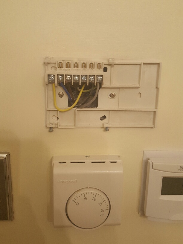

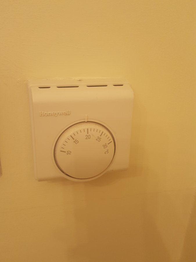

My Set up for the ground floor is:
1x Vailant 637 boiler which does my ground floor heating and hot water
1x Honey well programmer

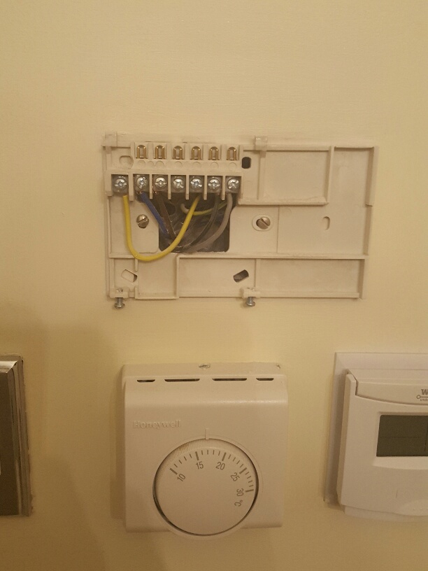

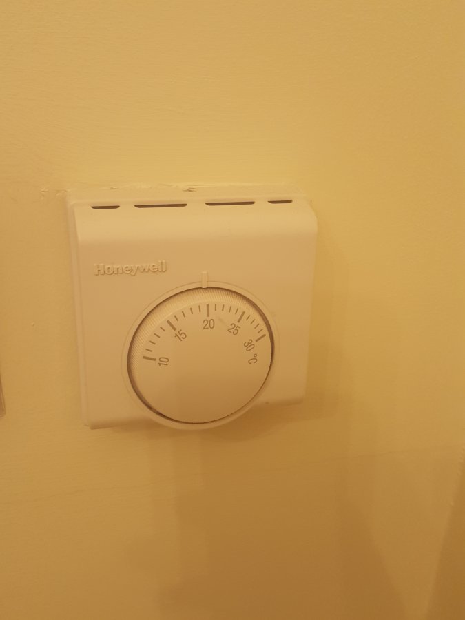

1x Honey well Room stat.
and my system is Zoned.
Tried changing the programmer with the nest installed leaving the Honeywell Room Stat on the wall, just did this to test so the trigger would start my boiler going, well that was the plan. Did not plug the nest room stat in as I wanted to see if the boiler fired up.

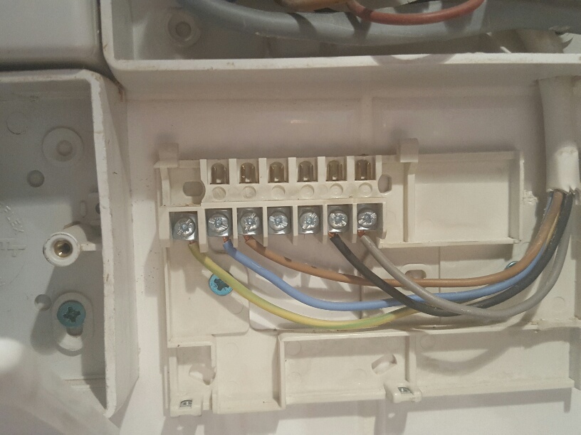

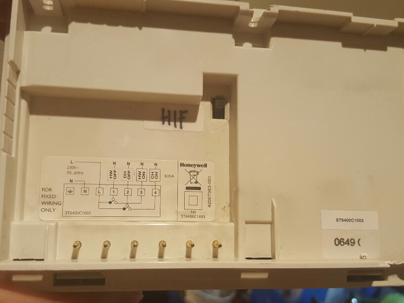

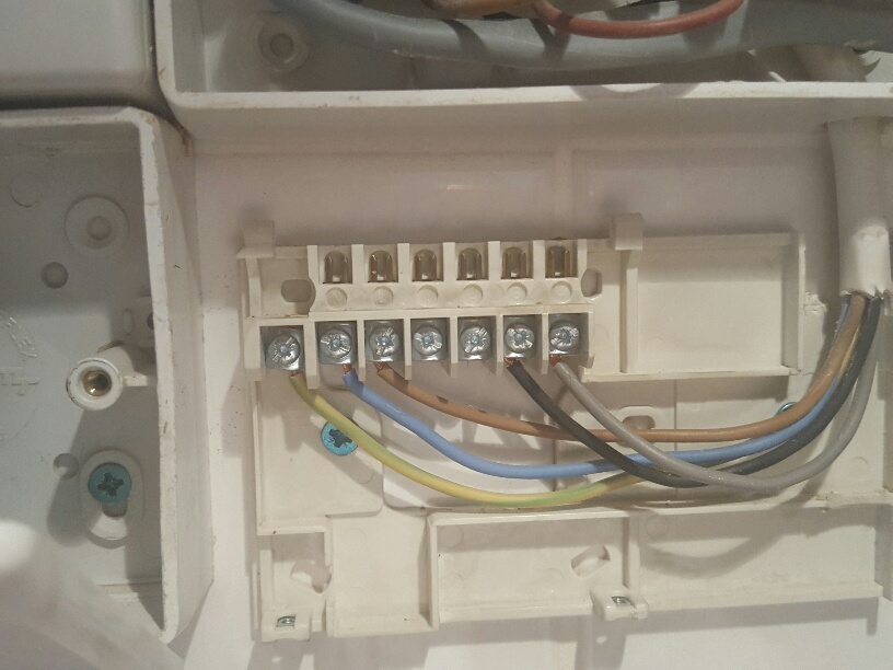

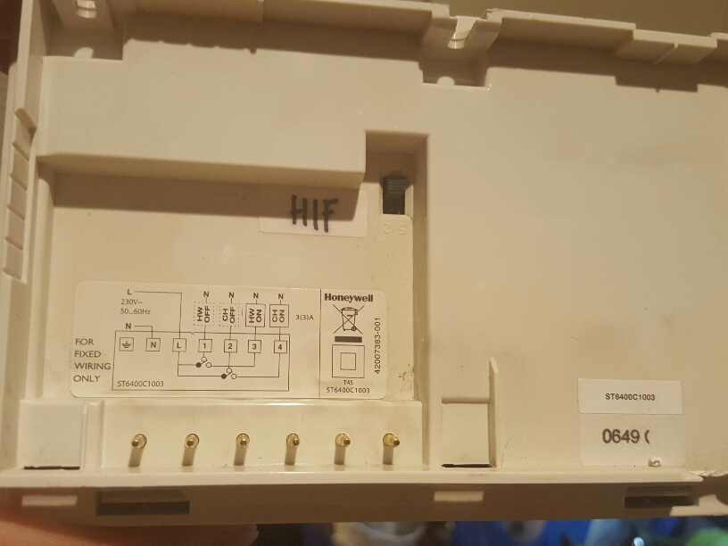

So going by my photos on the Honeywell programmer I have from left to right
Earth, Neutral, Live, then 3 (Hot water ON) Black, then 4 (Central heating ON) Grey.

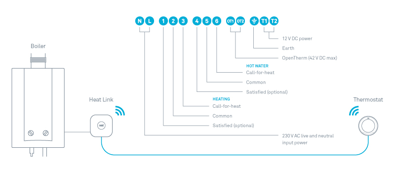

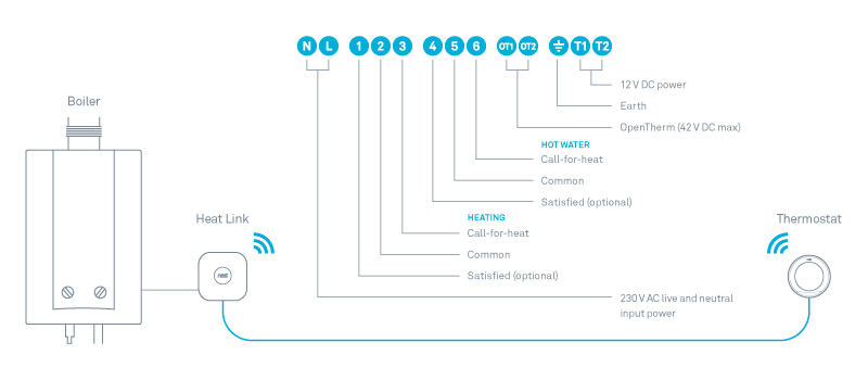

So I link the nest gen 3 as follows left t right
Neutral, Live, Loop from live to 2, Grey cable (Central Heating On) 3, loop from 2 to 4, Black (Hot Water On) 5.
I did this and my boiler would not even boot up. Well it would show for a moment a tempreature reading and showed some geberish on the lcd screen but the boiler was making no attempt to start up abd the screen would go blank, so I treid the original Honeywell programmer and still no go. Had to swap the PCB on the ground floor Boiler with my second boiler (Same Boiler make and model) and left the system with the original Honeywell programmer and it fired up.

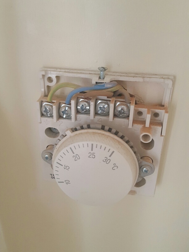

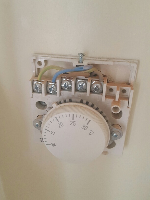

My second floor Set up.
1x Vailant 637 boiler (PBC Not work at the moment as I had to swap it with my ground floor boiler)
1x Honeywell Programmer
2x Room Stat. One located first floor and 1 located second floor.
and my system is zoned. So if my stat is turned down on the second floor but high on the first floor I will only get heating on the first floor.
I was under the impression that the black wire is just a 240v trigger for hot water and the grey is a 240v trigger for Central heating.
What am I doing wrong?

You shouldn't really be taking the front case off your boiler as it forms the room seal and should only be removed and refitted by a Gas Safe Registered engineer...
It's not unheard of for Vaillant PCBs to fail just because the power has been turned off and on again. There are fuses on there though so it would be worth checking one hasn't blown before fitting a whole new PCB. I can't find anything wrong with your description of the way you've wired it up
Tried to change the fuse but no good. May try again tonight and pray it wont fail the second board.
Should be:
Neutral, Live, Loop from live to 2, Grey cable (Central Heating On) 3, loop from 2 to 5, Black (Hot Water On) 6.
