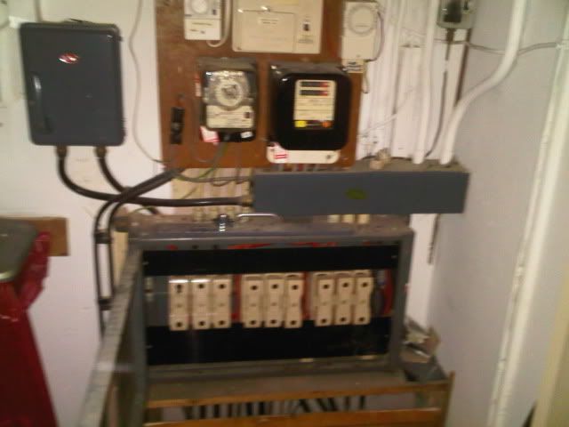

When the guy from DNO (lets call him Dino as thats an apt name i reckon) came round he looked at the fuse board in my flat and checked that cut out before my meter had not blown. it wasnt and there was no electrcity going into it.

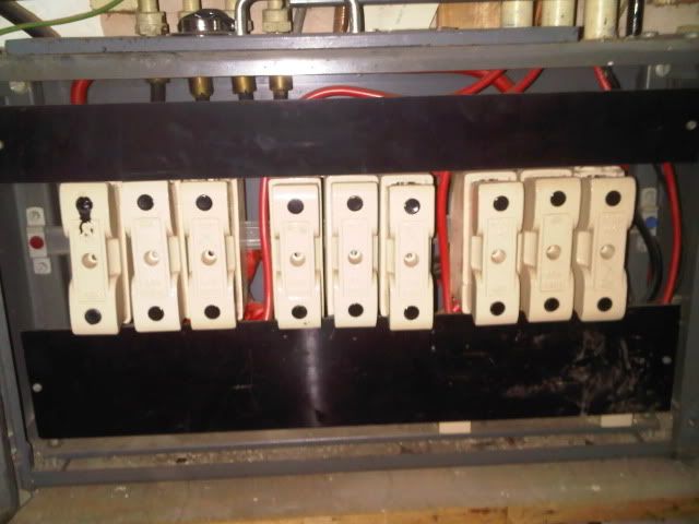

Next step - we went to the main distribution board in the communual hall (pictured below) which takes the electrcity from the DNO`s main servise fuse and seperates the electricity into the individual flats i.e each flat has a 60amp fuse before their meter.

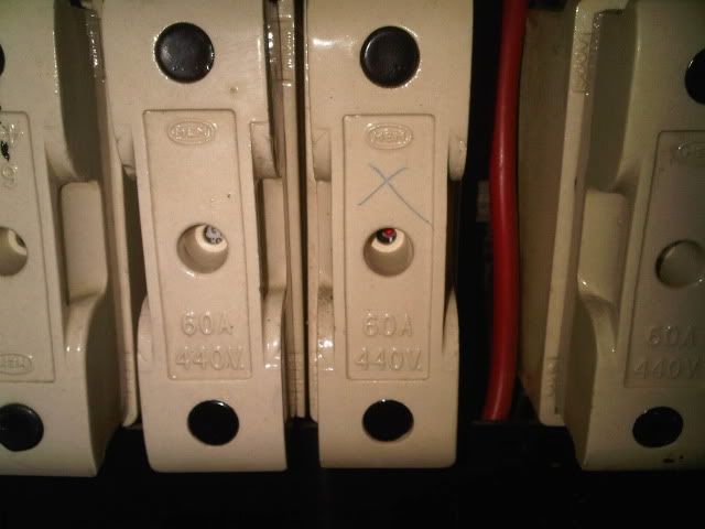

the door to the main distribution box told him what fuse was for my flat -
X marks the spot on my fuse
Dino said that the distribution board does not belong to the DNO therefore he could not toch it as it could get him into trouble if anything happened.

Dino said that I could do it myself if I had already made safe the initial fault and to isolate the ringmain just incase to reduce the risk of arcing at the Main Distribution board.
he did that for me in the flat, took the main cutout from in front of the meter and took out the main 60amp fuse cartridge.
I went to the wholesaler, got a new one. screwed it in. plugged it in to dist. board, closed it all back up and made sure it was secure, went into flat, reconnected the main cut out in front of the meter , re inserted all of my cartridge fuses into the board (soon to be changed for new board with mcb`s) and then switched all of my boards to the on position and then the moment of truth to see if my radio worked.......it did. all had returned back to normal.
