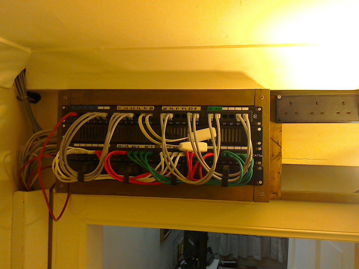

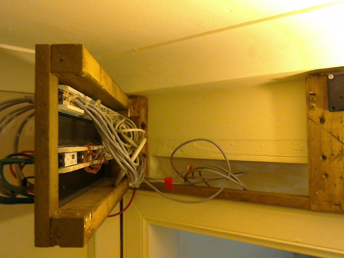

Here're a couple of pics of my home-made patch panel which goes over a door and is hinged.
