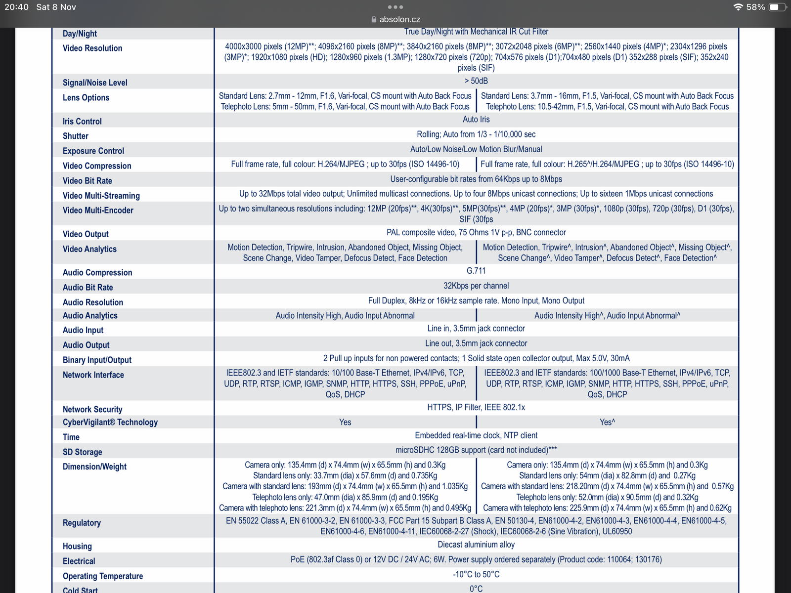

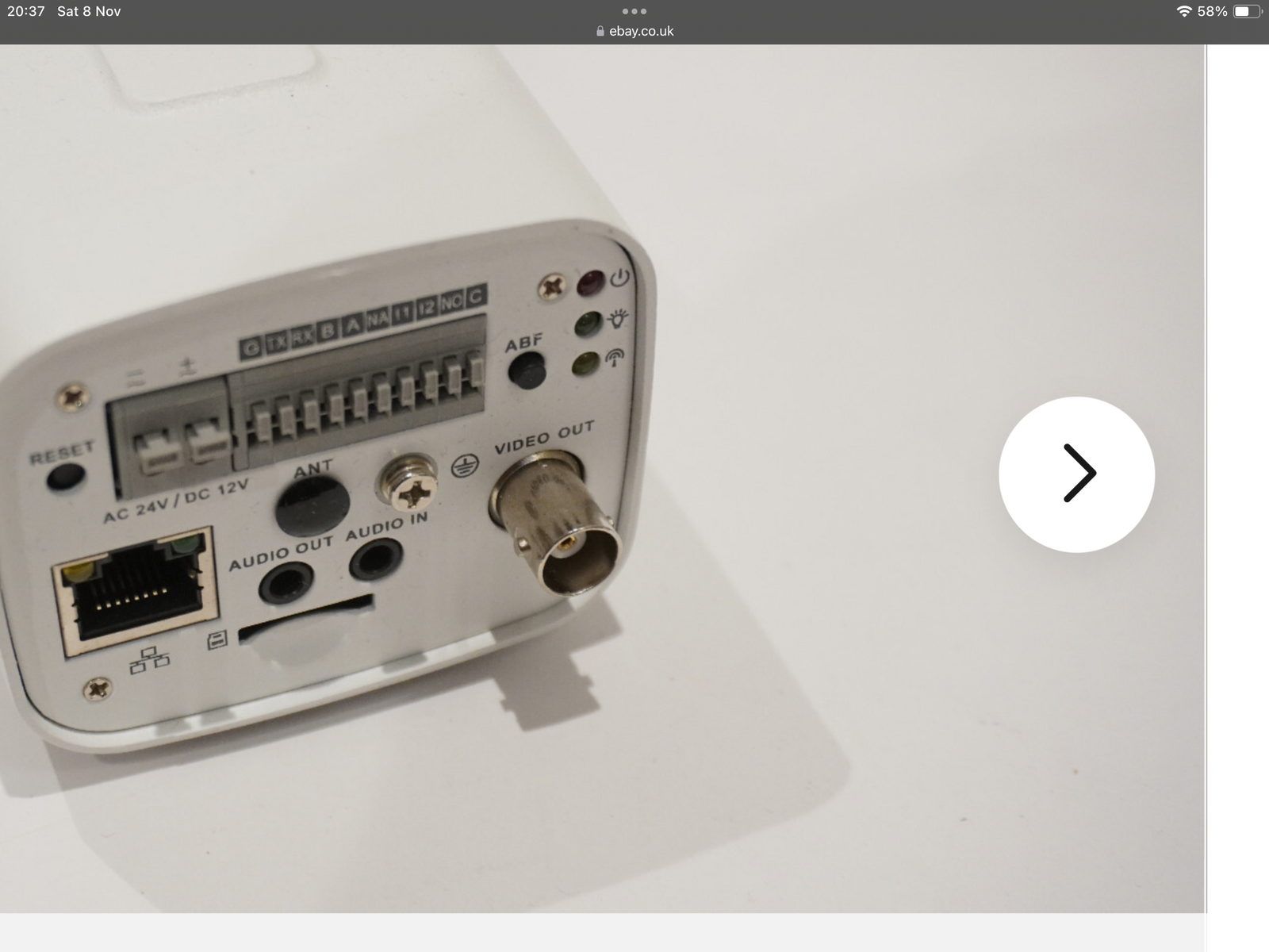

Ok from what I can see the output is standard PAL composite output , to be honest this is an ip camera it looks a good spec …but it may need resetting …whybthe video out isn’t working is ? Bad connections at your end …software issues in the camera or it’s faulty anybody’s guess , try to connect via a pc …
There is a reset button on the back that i have pressed
I dont know where to buy a proper connector for it from
Do you mean the eithernet cable?

A PAL composite output is an analog video signal format that combines color and brightness information into a single channel, using the PAL standard for encoding.
If you are outputting PAL composite video from the camera, then you probably need a BNC to phono cable, and that connects to the yellow phono socket on your TV. You then need to set the source of the TV to the phono socket.

So are you saying I need a BNC from the camera to a yellow phono to the TV, instead of a coaxil to the TV instead?
The BNC socket, might be an old type network connection, rather than the 1v peak to peak signal you need, to feed the phono socket on a TV. The BNC socket being for a network connection, is further confirmed, by the modern LAN socket, I think I can see in your photo. The BNC is a 10 base T socket. The more modern LAN socket, is the one on the lower left, looking at your photo of the rear of the camera.
The scart socket on your TV, is basically the same as the yellow phono socket, except the phonos are combined into a multi-plug.
[EDIT] and a correction. The BNC is (looking at Sparky's better photo) obviously a PAL output, which should work with a yellow phono input to an older TV, or a SCART.
The socket on the lower left, is clearly marked as a LAN connection, so probably would allow it to be plugged into a router, and the video watched via a web browser.
