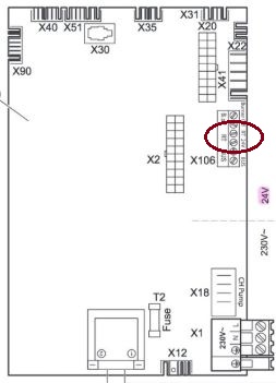

Sorry for the hijack. I'm in a similar situation. I have a Vaillant ecoTEC pro28 combi, and am currently using a Siemens rcr10/433 unit with it.
Looking at the Vaillant manual, the PCB looks like it has a 24v and a 230v section. Would I be able to use a dual channel Hive with this?

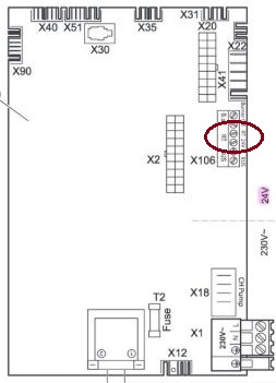

It would appear so, rt to terminal 4 at hive. Can you not just get the single channel?
The control part of the Dual Channel Hive is linked to the L terminal internally so it can only give 230V control.
If you try to use it with 24v it will apply 230V to the 24v boiler circuits. The results would not be good

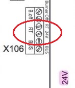

From the diagram you have posted, the only room thermostat terminals visible (marked RT) are marked 24v
The mains terminals at the botton right are the mains supply to the boiler. There isn't a RT terminal for 230V connection to a thermostat there.

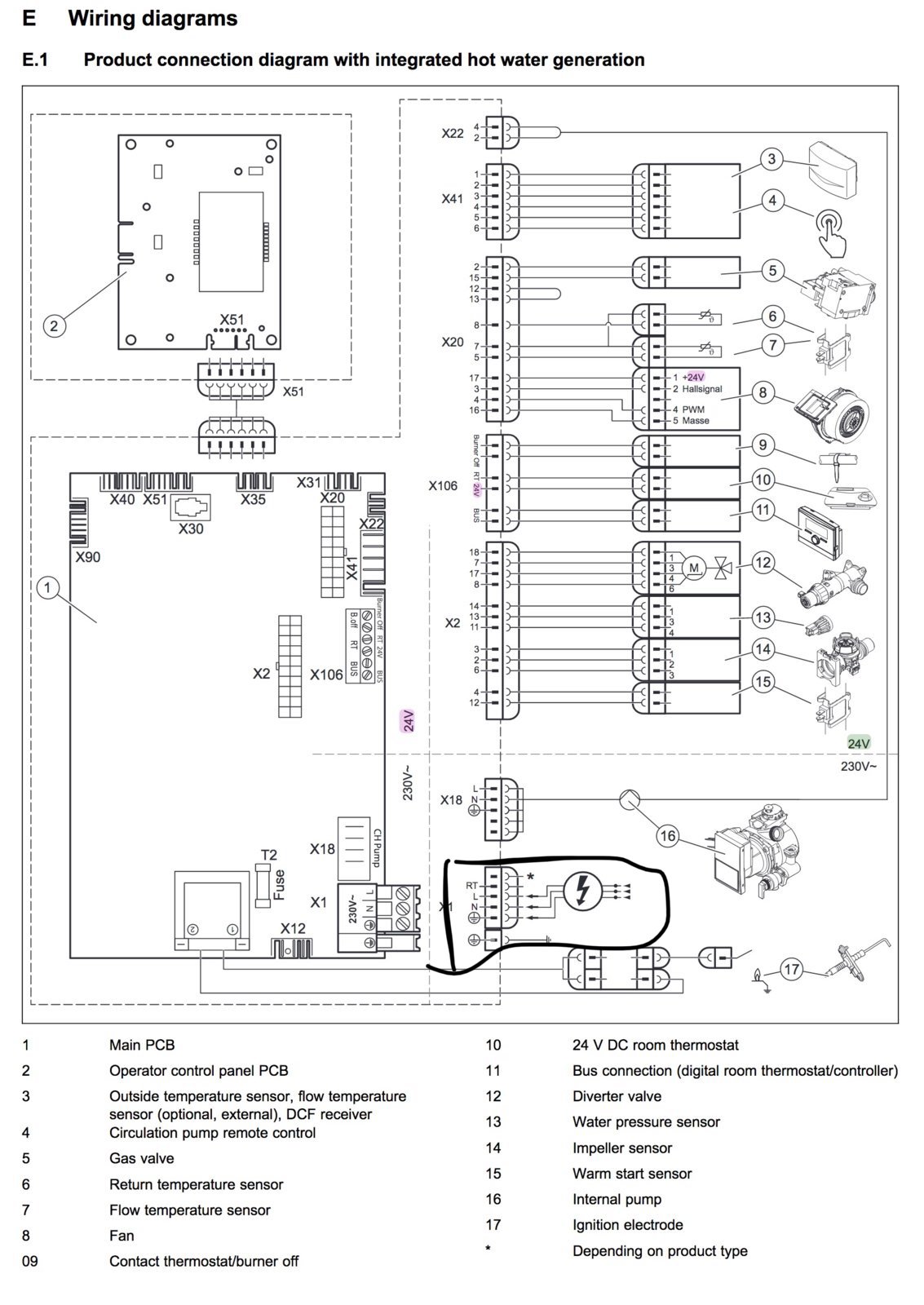

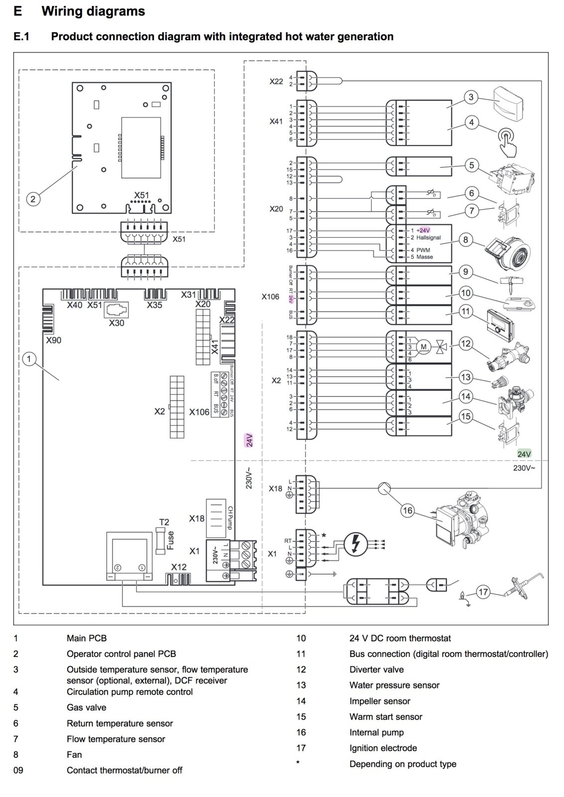

@stem, I think on these Vaillants there is a 230v rt connection using a single wire, with a link at the receiver, but that’s built in on dual channel?
OK. It does say RT, so would be OK, the little * symbol says 'depending on product type'. Usually there is an RT terminal right next to the mains supply like this.
Vaillant do seem to have many different wiring formats. Personally I have always used a Single Channel version on 24v anyway.
I did read some posts about people moving a couple of wires over in the Hive unit, but wasn't 100% that was doable with my boiler. Let me try and find the posts.
If there's a 230V RT connection you would be able to use it with a Hive Dual Channel, but it's a bit of a 'fudge' IMHO and you will have a hot water function that won't be doing anything.
@stem Yep, usually a purple plug in type connector is what I’ve always seen on the newer ones (2012 model). I’m not sure about the brand new ones, not had to wire any in, as most boilers we fit now are Intergas. All the previous ones are the purple plug or the original white strip with terminals 3&4.

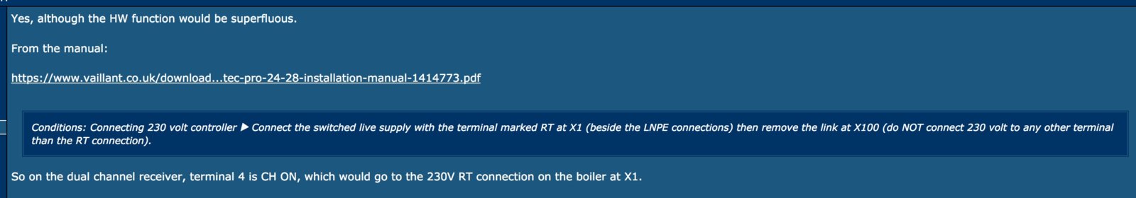

Anyway, I posted the same question up on another forum and some eagle eyed person spotted this in the manual.
So it is possible to connect a 230v controller.

I was just thinking. The Siemens reviver that I've already got with the boiler is probably 230V anyway. Wouldn't it just be a simple matter of replacing the Siemens unit for the Hive unit, and using the same wires?
It might be connected to the 24v side of the boiler, which would fry the pcb. If you open up the receiver side if there’s a link inside, chances are it’s 230v, but if it’s 2 wires then could be the 24v side.
Check if it's connected to X1 (230V) or X106 (24V).
If the former, then yes you can replace it. If the latter, then you will need to make sure the hive is connected to RT on X1 !!
