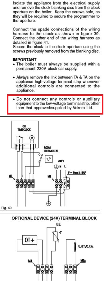

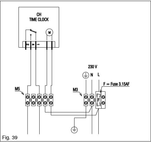

My question is this, from what I have read you can indeed use the dual channel receiver, but only if the boiler uses 230v switches - is that right?
My Boiler is a Vokera Unica HE 28, wiring is attached.
It does indeed say 230v at the main power terminals, but not above the clock / thermostat terminals.
Can it be done on this boiler? Last thing I want to do it pop it!
I know on the single channel, id simply connect up common and 3 (heat on) but on the dual channel there is no common, and Id be connecting to terminal 4 (if it were possible).

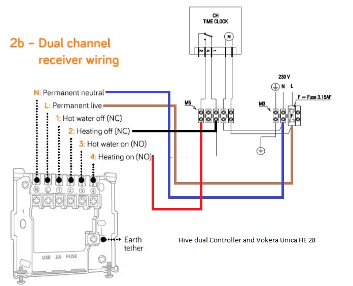

Many thanks Ian, to confirm, I believe with the dual controller I would be wiring like the attached picture?
I currently don't have a thermostat in the house! - just the time clock - I presume it would be safe to remove the time clock wiring? Other wise id have to have that in the "On" position at all times
When the timer is set to OFf one of the two control wires from it will NOT be Live and when it is ON that same wire will become Live.
That is the wire which your Hive will then control by connecting it to the Hive Heating On terminal and this will also effectively bypass the timer which must be either switched to OFF or disconnected completely.
There is no need to connect anything to the Hive Heating OFF terminal.
So just whack my multimeter on the boiler, see which one is live when the timer is switched to on and connect terminal 4 on the Hive dual channel? - great stuff
Yes, one of the wires will be Live permanently but it's the other switched one that should connect to terminal 4 of Hive.
Hi guys,
Sorry for questioning this again, ive now received the Hive and got the manual out and found this:
As I understand it the Hive dual channel (heating and hot water) doesn't have a common so shoots 230v from terminal 4 on the hive wiring - wouldn't this pop my system? given the picture above says don't connect anything with high voltage to the low voltage terminal strip.
Cheers in advance
But you connect terminal 4 on the hive to the switched live at TA TA at the boiler that is the high voltage connections , you have been advised how to check which one is the switched live, do not connect any other wires except LNE at the hive, and do not use any of the low voltage connections at the boiler
All done guys, cheers for the help.
Popped the multimeter on it, found the switched live (230v which was a relief) removed the mechanical clock wire, put the "spare" wire from the 4 core cable, to outlet 4 on the hive. The rest self explanatory obviously.
Took around 20 minutes all in. Thanks very much guys.
