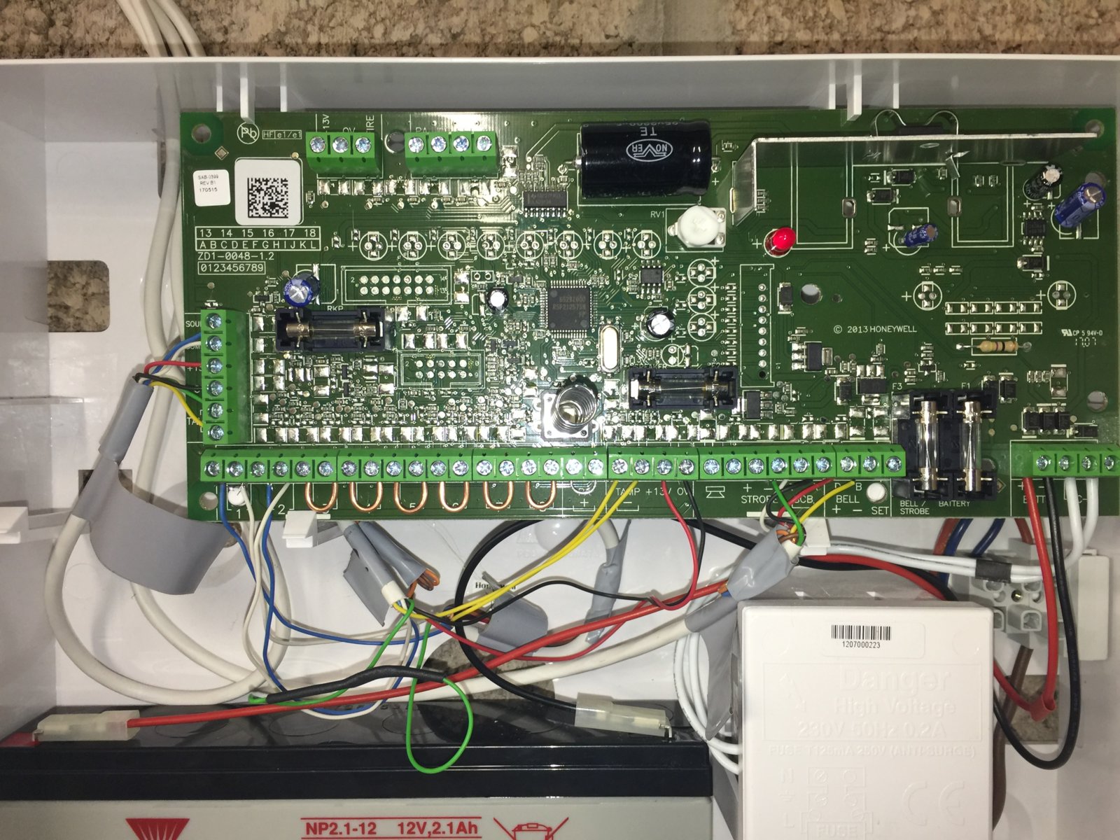

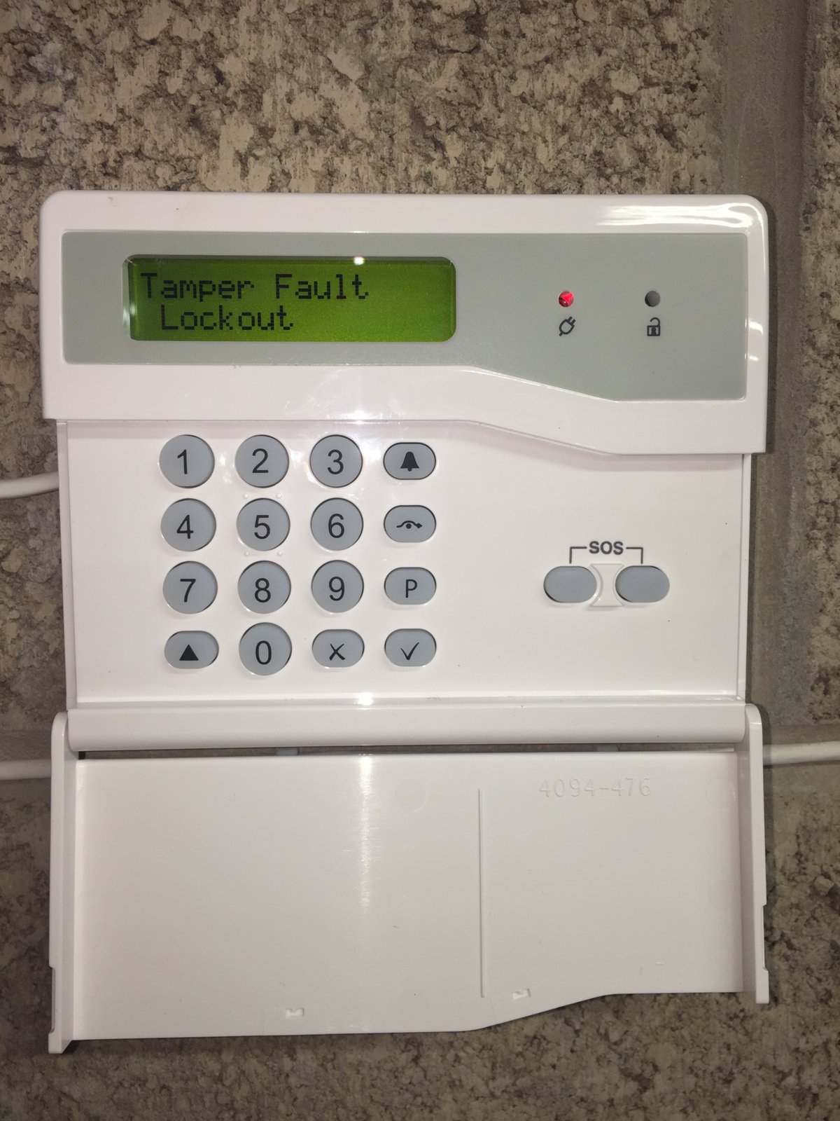

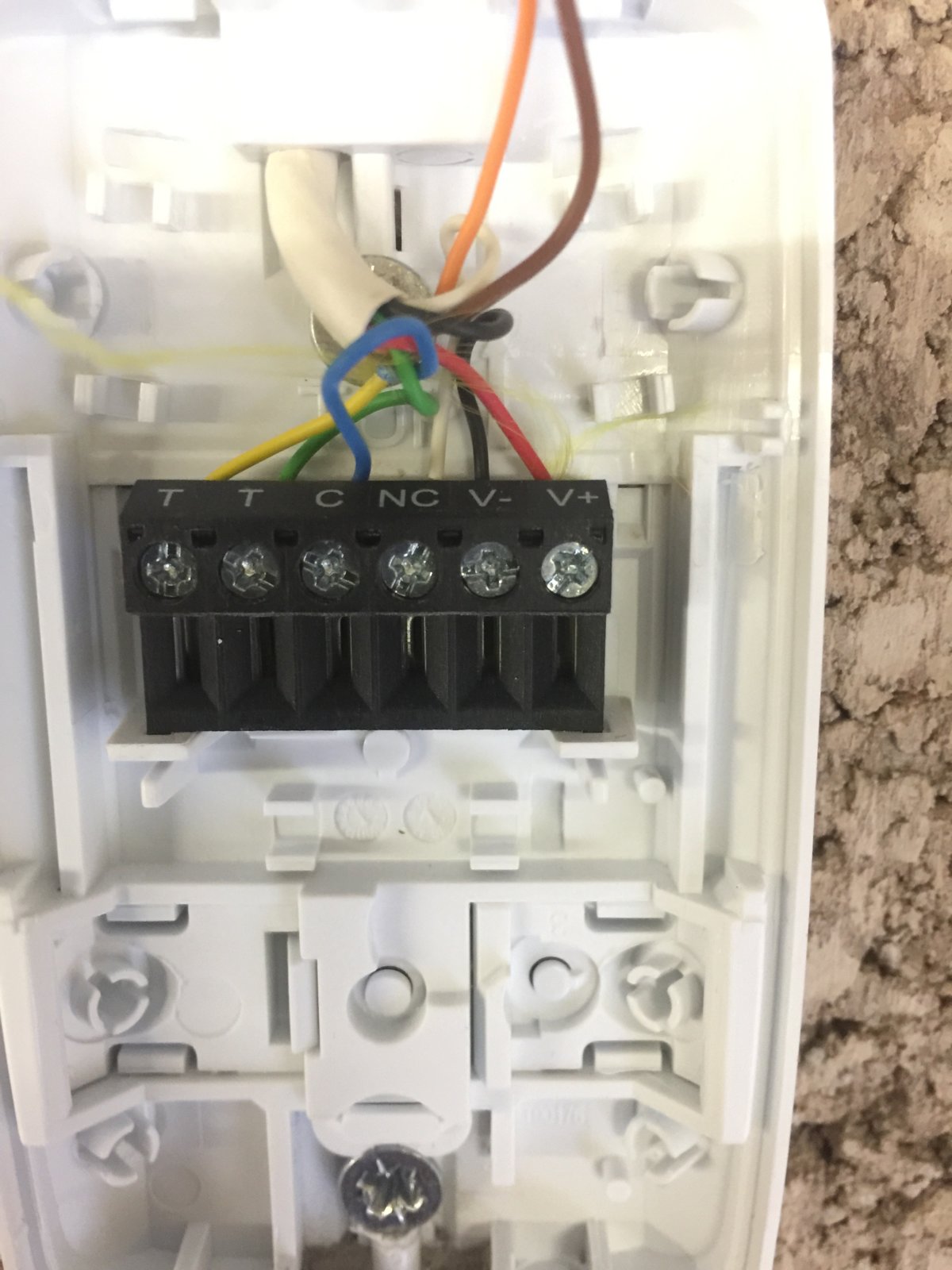

Ok - I have done exactly as instructed above and connected the power tonight to set the system up. I connected the power, alarm went off, entered code and silenced. Closed panel to set tamper. audible click heard. I have managed to set the time, zone 1 and 2 marked used the rest as not used, changed user 1 code and user 2 code etc etc. What am I doing wrong? I now have a "tamper fault" lockout and have no idea? I only have the door magnet and one PIR connected as per my previous pictures. Pics below of LCD keypad and panel etc

Ok one step at a time ....take out the tamper wire and fit a link ....does it clear after fitted lid and pressing reset ...If not ( if so this is your problem )
Take out the keypad tamper fit link ..does it clear as above ....if not
Fit link on bell scb black and white ( leave cables in ) if not ....faulty panel ......if so your bellbox is either not wired correct or tamper switch not closed
Well I never - its only WORKING!!!
Linked the tamper circuit - no joy
Linked the keypad tamper - fault disappeared!
Removed keypad fascia, checked tamper spring - kept pressed in when removed from wall - fault disappeared.
It would seem that the keypad tamper spring was not compressed enough when keypad fascia fitted to back plate. A little tlc and its all sorted.
Now to tidy the wires in the panel - my OCD is getting the better of me lol
Thank you so much for your help and advice.
