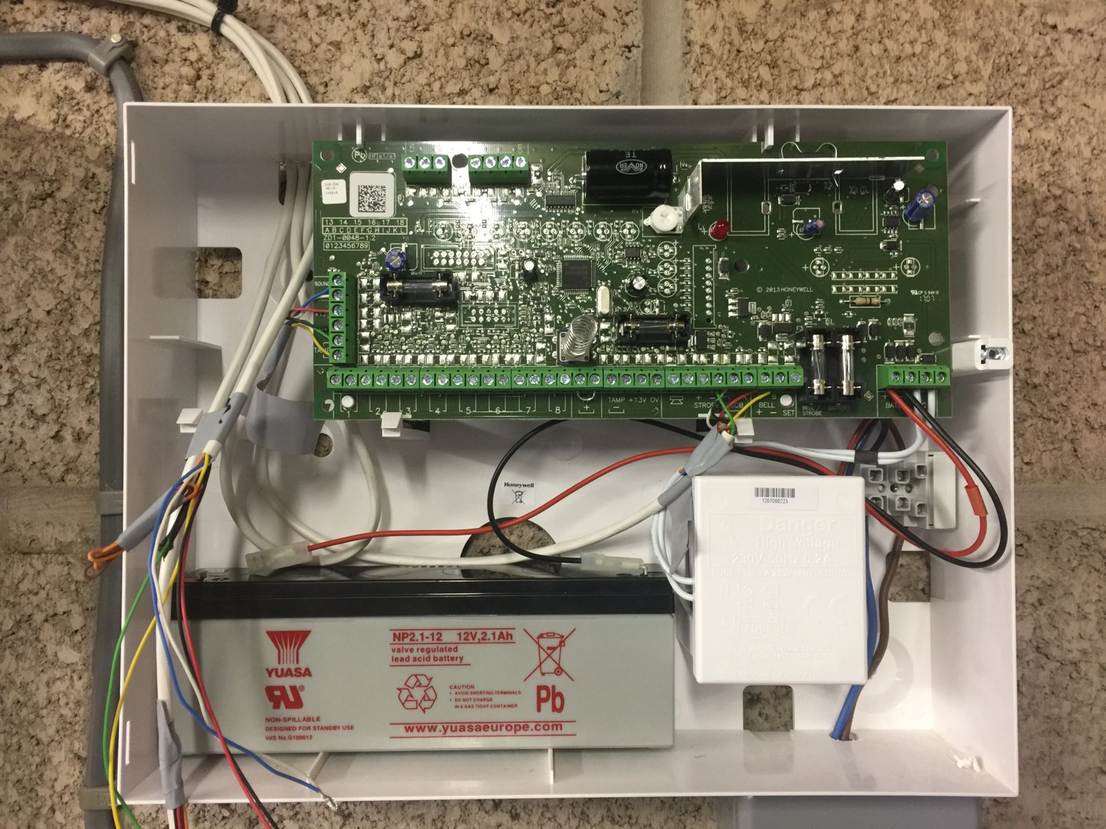

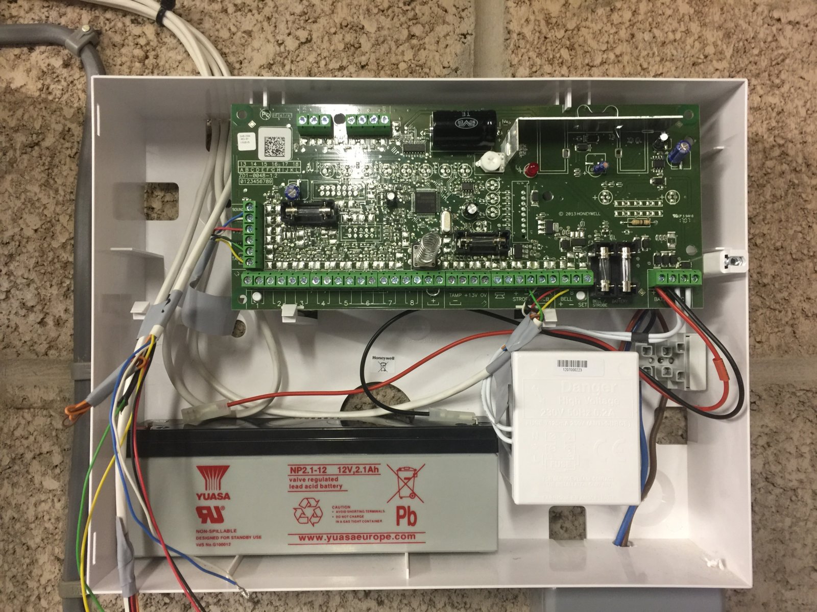

Hi All
I've just finished installing my Accenta G4 in my workshop.
I have connected the siren box to the panel
TR white
V- Black
ST Green
V+ Red
S Yellow
and remote LCD panel to the panel
0v Black
13v Red
Comms - White
Sound Blue
Tamp yellow
Tamp Green

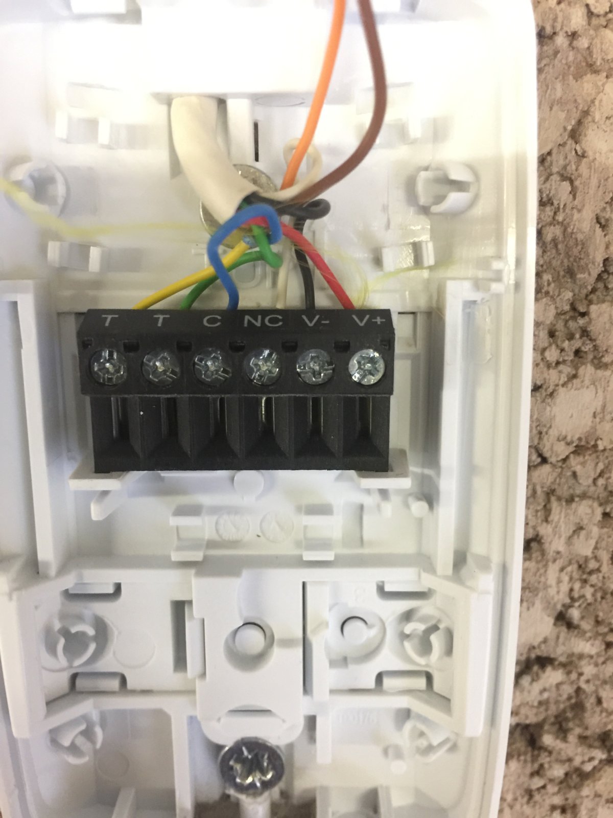

I only have the PIR and door contact to now connect to the panel, But I'm not sure how to connect them to the panel.

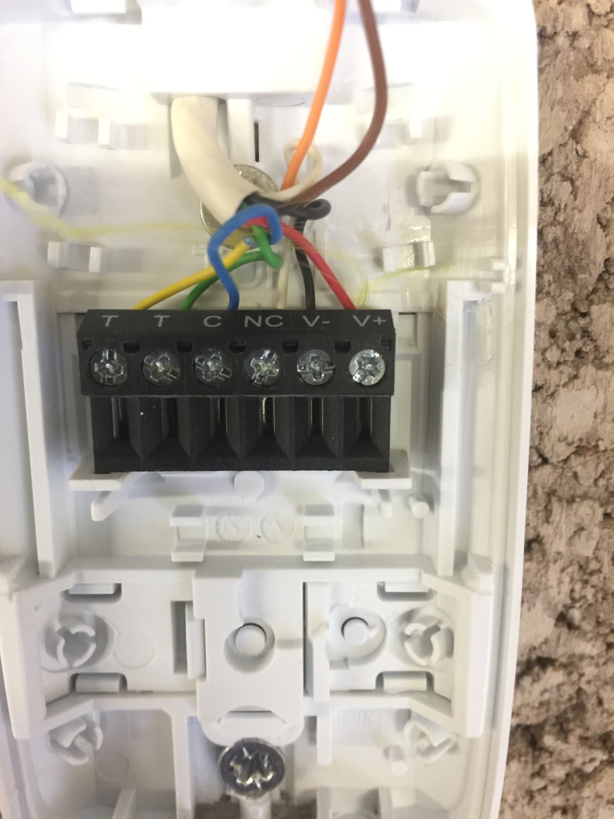

The PIR has 6 contacts
T Yellow
T Green
C Blue
NC White
V- Black
V+ Red

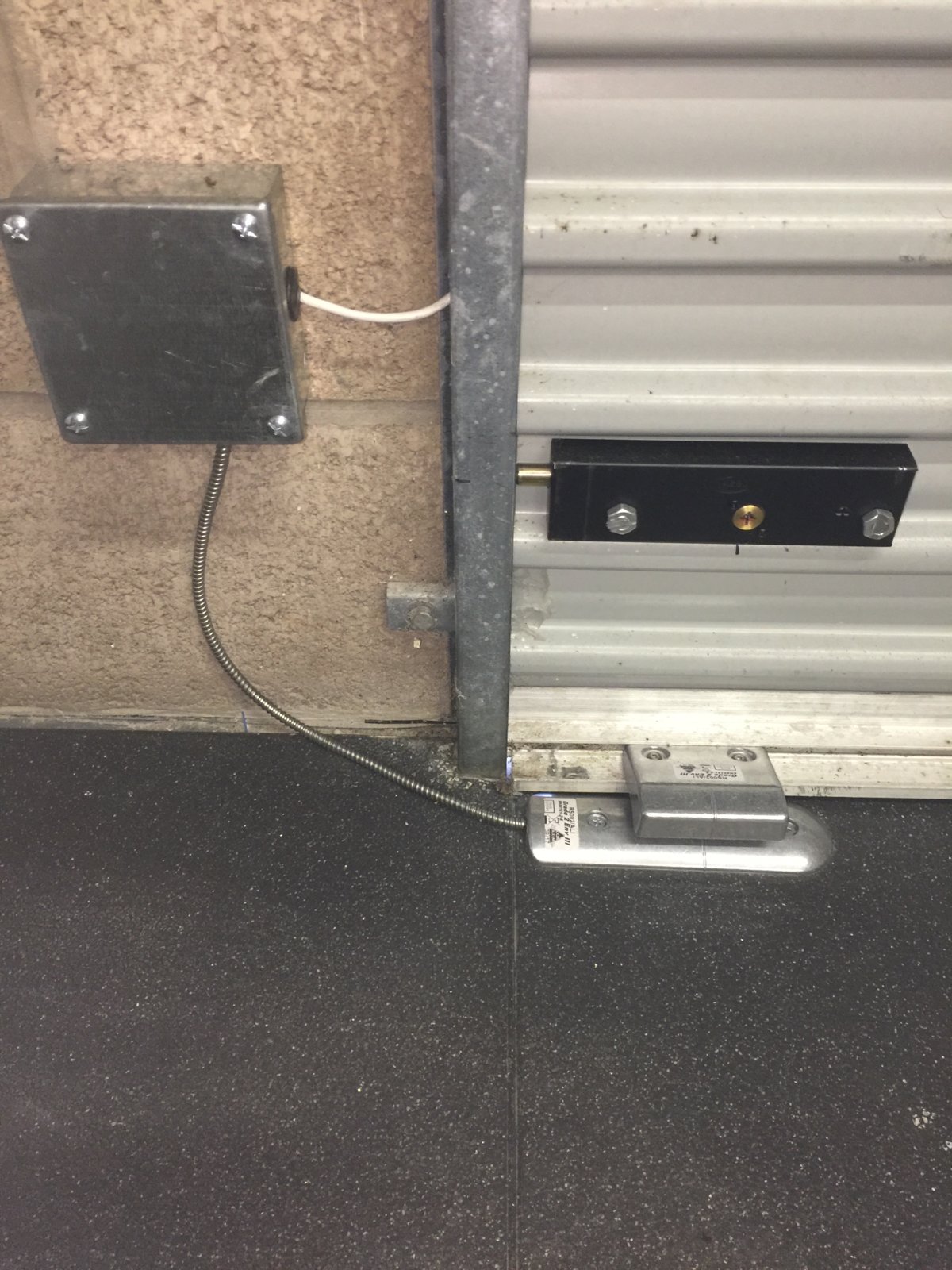

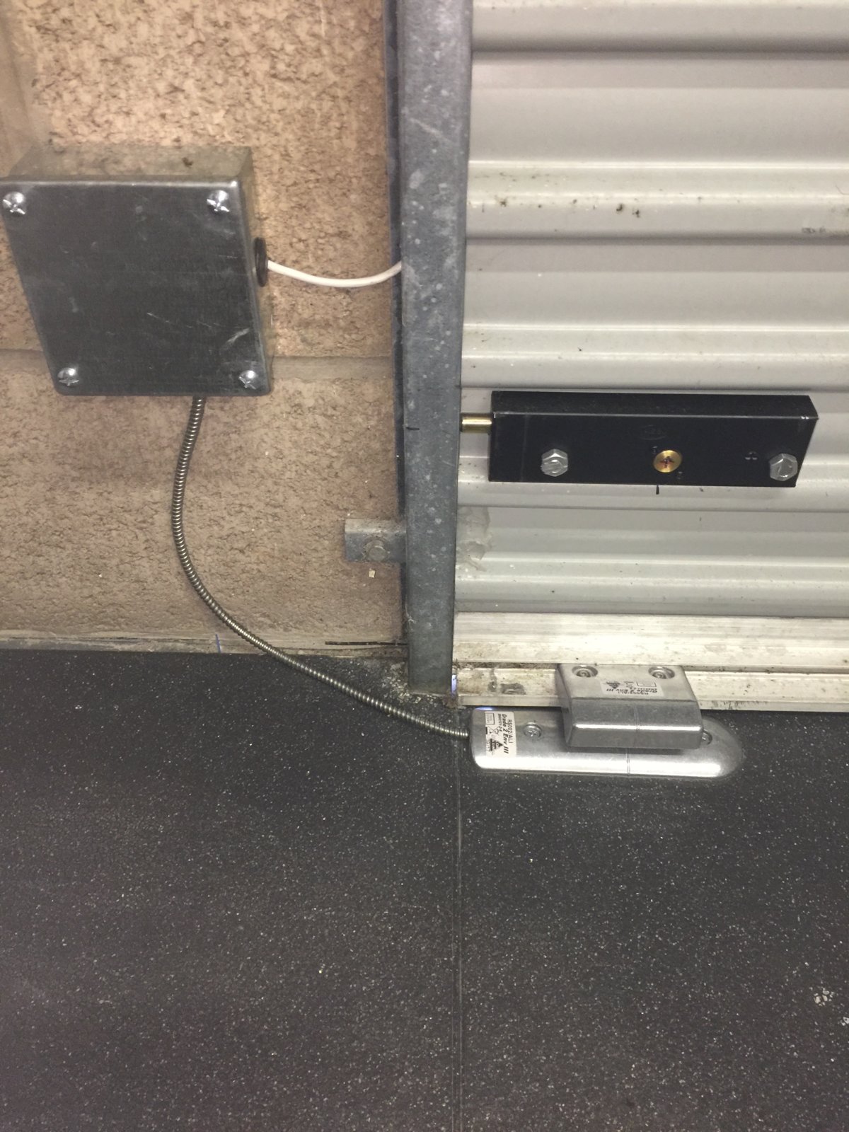

The door contact has 4 wires
2 x switch wires (blue and white)
2 x tamp wires (green and yellow)
Where do I connect the PIR and door contact wires on the panel?

Blue and white of door to zone 1 pir zone 2 , yellow of the tamper to tamper zone from both devices and the remaining greens twisted together and put in a connector , the red of the pir in 13v and black in 0v
Now program according....
Your blue and white cables are your alarm circuits and want to go into your alarm circuits on the control panel.
Zone 1 garage door ,zone 2 pir and so on
Your green and yellow cables are your tamper circuit and need to be wired in series and then put into the tamper circuit on the control panel
Zone 1 will be entry exit zone and will set the timer
Great - Thanks

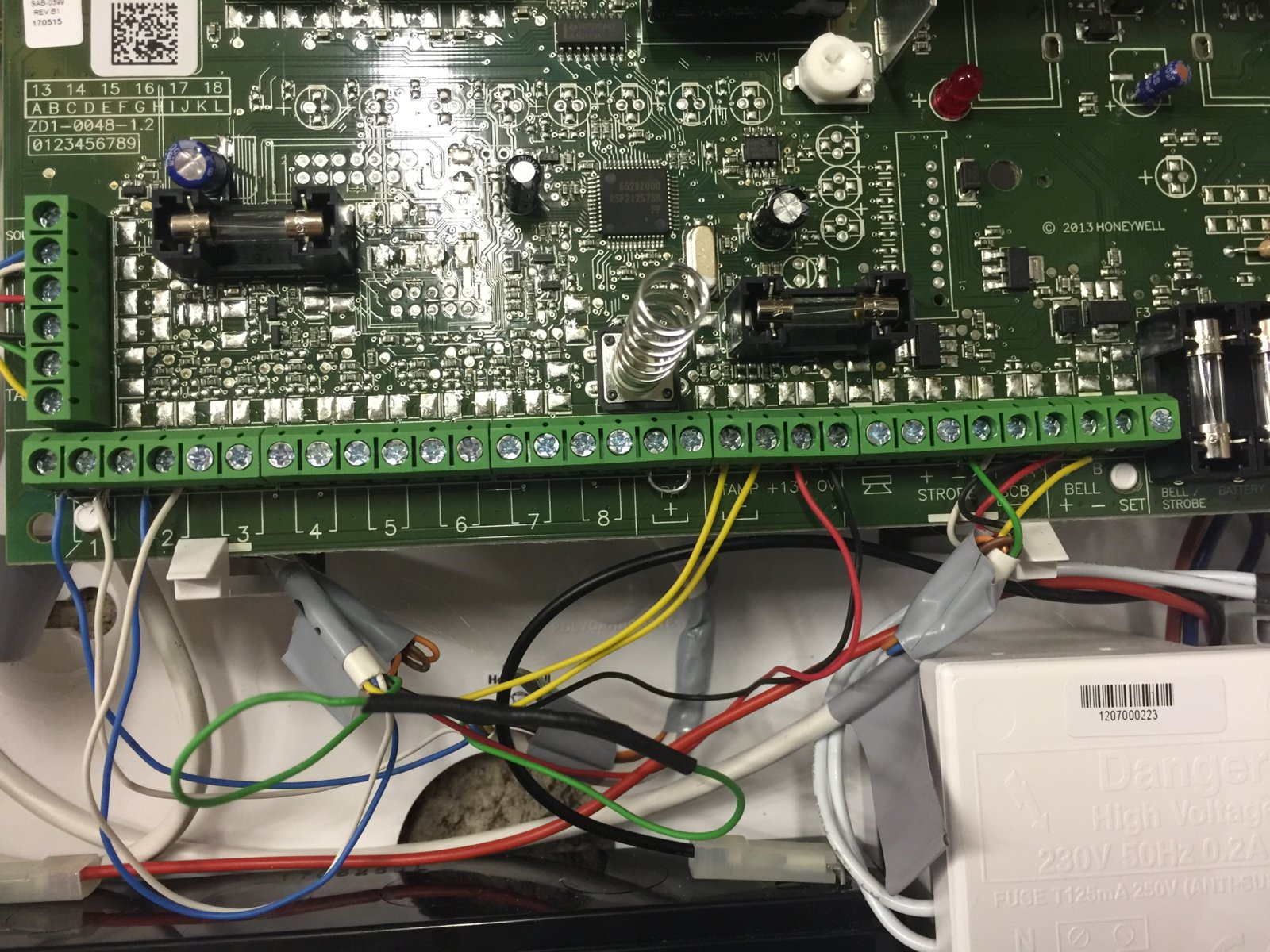

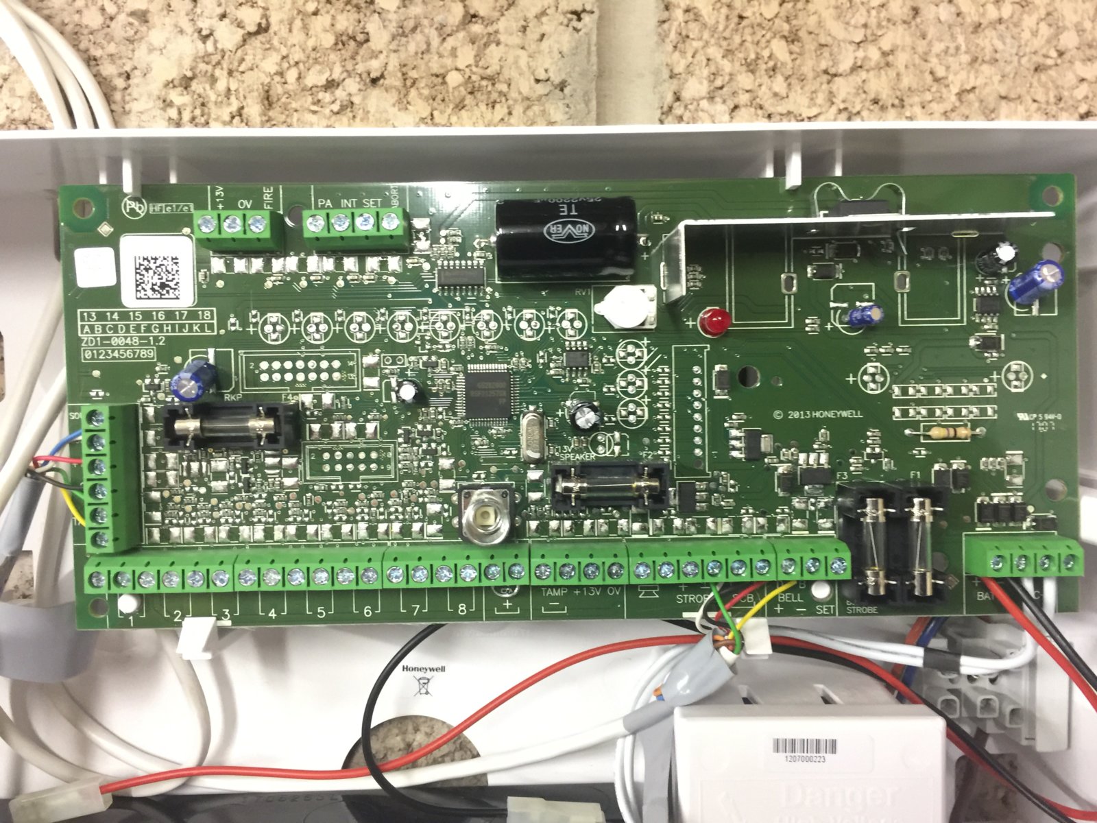

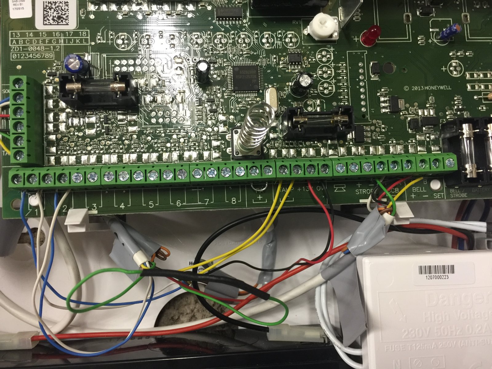

How does this look? Am I good to go? Connect power and set program?
Zone 1 Door
Zone 2 PIR
Green Tamper from Door and PIR connected together and heatshrunk
Yellow tamper from PIR and Door to Tamp on panel
PIR red in 13v
PIR black in 0v

Looks fine , only other point ....lack of speaker ...will you hear the setting tones from the keypad ok ?
Thanks - the key pad is only a few feet away from the panel next to the roller door. Do you think I need a speaker in the panel?
If I fit an internal speaker will that also sound at the same time as the external siren if the alarm is triggered as well as replicating the key pad sounds? That would be an extra deterrent having your ears riniging in my small workshop
Keypad speaker is fine, but rather than a speaker in the panel, use a sound bomb as a deterrent.
Wire links in unused zones not necessary, as the programming will cut out the unused ones
Putting wire links in unused zone will prevent any programming errors.
You mean just cut some small lengths of alarm wire (lets say red) and link each zone? same as some of the small wire links I had to remove for some of the connections?
Yes ,correct
Linking out unused zone will make fault finding easier if you have any faults your are unsure of
