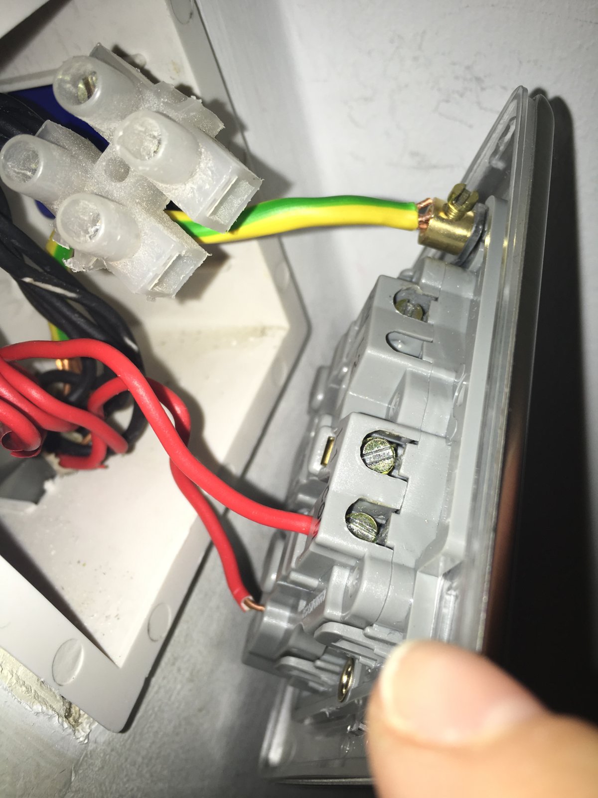

    so I have brought a new light switch for my kitchen 9 replace the old one this is a 3gang 2 way plate switch.
    After taking all the wires out and marking them on paper I have got myself in the right mess and I cannot for the life of me figure out what I have done
    I have 5 red wires 2 small brown ones that are not connected inside the electrics (these were connected in the lady socket only) and I have an earth
    Please can you help these lights are to switch on 3 different lights in my kitchen and nothing else but I am confused as now I cannot seem to get the lights to switch on at all
    I have managed to get 1 lot to switch on/off but 1 is on all the time and the 3rd lot won’t switch on at all
    Any idea

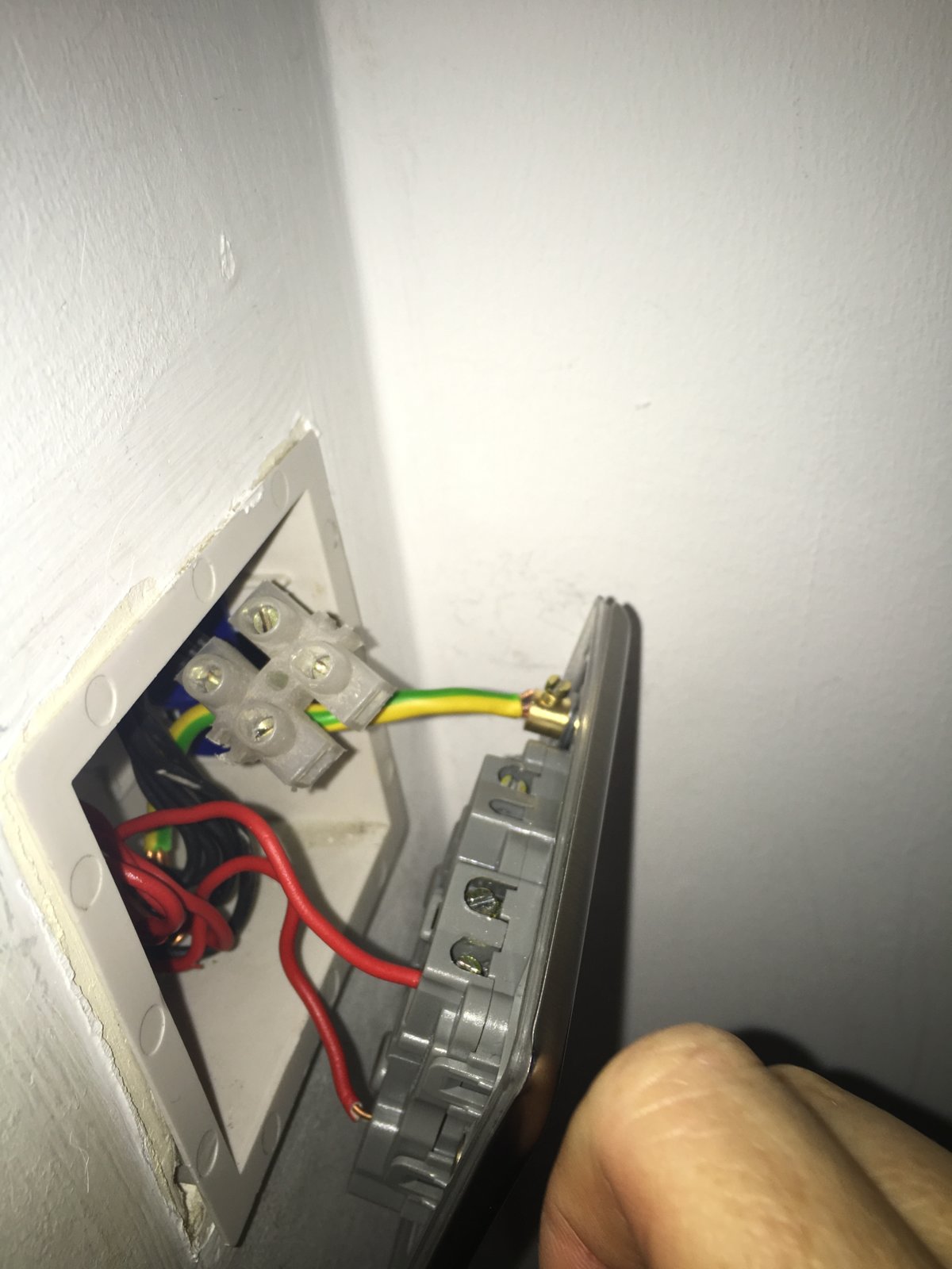

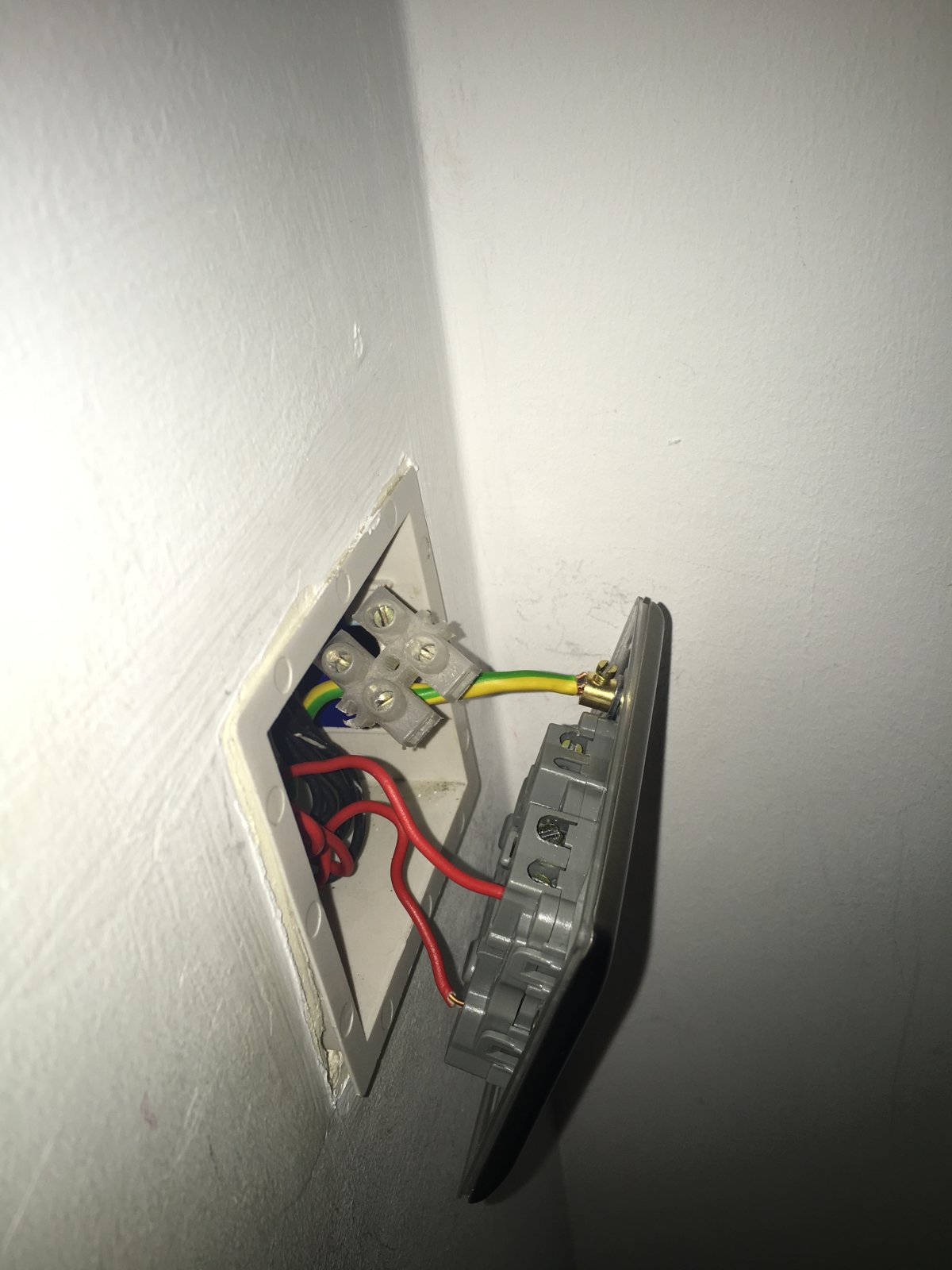

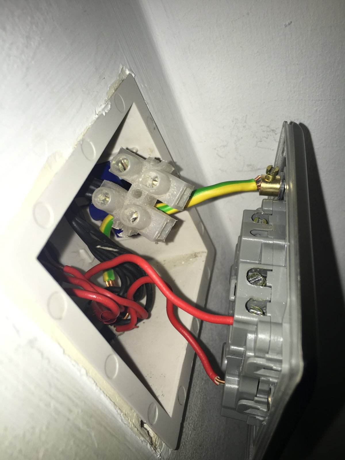

    Thank u i know its a simple task i have just been confused attached is the socket
    Any idea or help would be good we have been trying to fix it all day we have 1 light working 1 we cannot locate and 1 which turns on but not off!!

  14. Odd that you've got 5 red wires in a 3 gang switch, where you'd normally expect 4, or 6. You haven't mentioned what type of lights you're connecting to, so we don't know how to advise you yet. You could have 3 live feeds, and three switched live feeds in the com connector, then going back to the lights from the SW1 connector, or you could have one live feed into the first comm, and then a strap to the 2nd and 3rd comm. So when you took the old switch off, where there wires going in and out of each switch, or how was it done.
    Do you have a meter or mains test screwdriver to detect the live feed as a starting point. But you've got the earth right, so you've made a start.

    5 sounds perfectly normal to me.
    Line in, Line out, 3 x switched line. Can see from the photo that’s is 2-plated so 5 is fine.
    If it was 3-plate there would be 4 or 6 reds.

    It is a 3 gang switch. Hence, 3 switched lines
