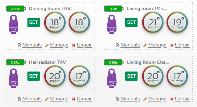

Weather comp and no zoning would be my recommendation. Turning off heating in individual rooms that aren't used in my opinion/experience saves the sum total of naff all, not to mention the faff of keeping doors closed etc. Heat the envelope of the entire building to one temp that you are comfortable with.
