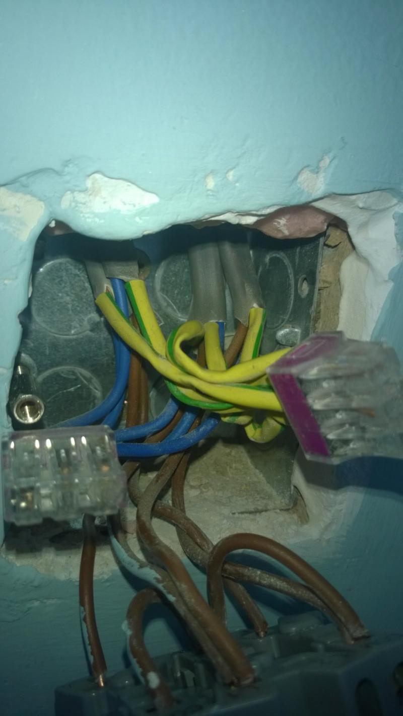

Hello,
I replaced my white switches with some nicer BG ones, but in doing so I seemed to have messed up the three gang two way switch which was working as a one way switch.
The switch controlled two seperate ceiling lights and one pair of wall lights. The situation I have now is the switch on the right seems to control power to other two. If that is not on, then the other switches will not work.
To compund matters all the wires used are brown and there are no labels.
I have one wire coming from the wall into the com port on the top right, with additional wires used to create a link to the centre com and from there to the com on the left.
I then have two wires coming from the wall into the L1 at the top, and two additional single wires from the wall into each of the L1s at the bottom.
The switch order is fine i.e. the left switch operates the light on the left hand side of the room etc. so I'm guessiing it is the com which is the issue - but I'm not sure what I did wrong in re-wiring. :confused:
** Edit ** I've uploaded a couple of pics. There are five cables coming down into this switch.
As you say the problem is with the com terminals and the small link wires.
The middle switch on your new switch maybe upside down when compared to the old switch which may have confused you.
The link wire on the first switch (right) needs to come from the other end of the switch (so this switch doesn't need to be on to allow the others to work)
Thanks Andy - I've added some pics.
Things are a little more clear for me now. The middle switch has two cables in L1 as I have two seperate wall lights (duh!)
To clarify, the wire that is currently in the com port on the right should be going into the left?
There should be an earth wire between the front plate metal terminal and the green/yellows for safety.
On the right hand switch (the one controlling all lights).
Swap the two wires which go into to the wall. You can see they are kinda crossed over.
Leave the link wires where they are
Thanks Andy - that did the trick!
Should I be concerned about the lack of earth wire? None of the switches have these and I've just had it all rewired!
So yes you should fix it.
So yes you must fix it
On all of the light switches etc that have metal plates.
Get whoever did the rewire back and make him comply with the Manufacturer's Instructions and BS7671.
On the Installation Certificate that he gave you :?: he will have signed to say that the work he has done complies with the Wiring Regulations, and it doesn't.

Assuming you had plastic switch plates before, your electrician should have connected the earth wires to the metal back box earth terminal, to ensure the metal back box was earthed.
The new metal faceplates MUST be connected to earth.
