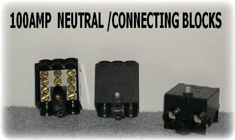

Hi Guys
I wish to extend my meter tails with a henley block similar to the one in my pic
what i am finding a bit confusing is how the phase and neutral are seperated in the block as there seems to be no seperation between them??
am i missing something here? the phase and neutral seem so be connected by the bridgeing piece across?
You'd have to use two of those. One for live and one for neutral.
You can get 2pole ones though. Either way is fine.

Ohh, a neutral tail shoved into a live henely. Thats gonna smart. :eek: :eek: :eek:

especially if you shuv both live & neutral tails into the same block :oops:
