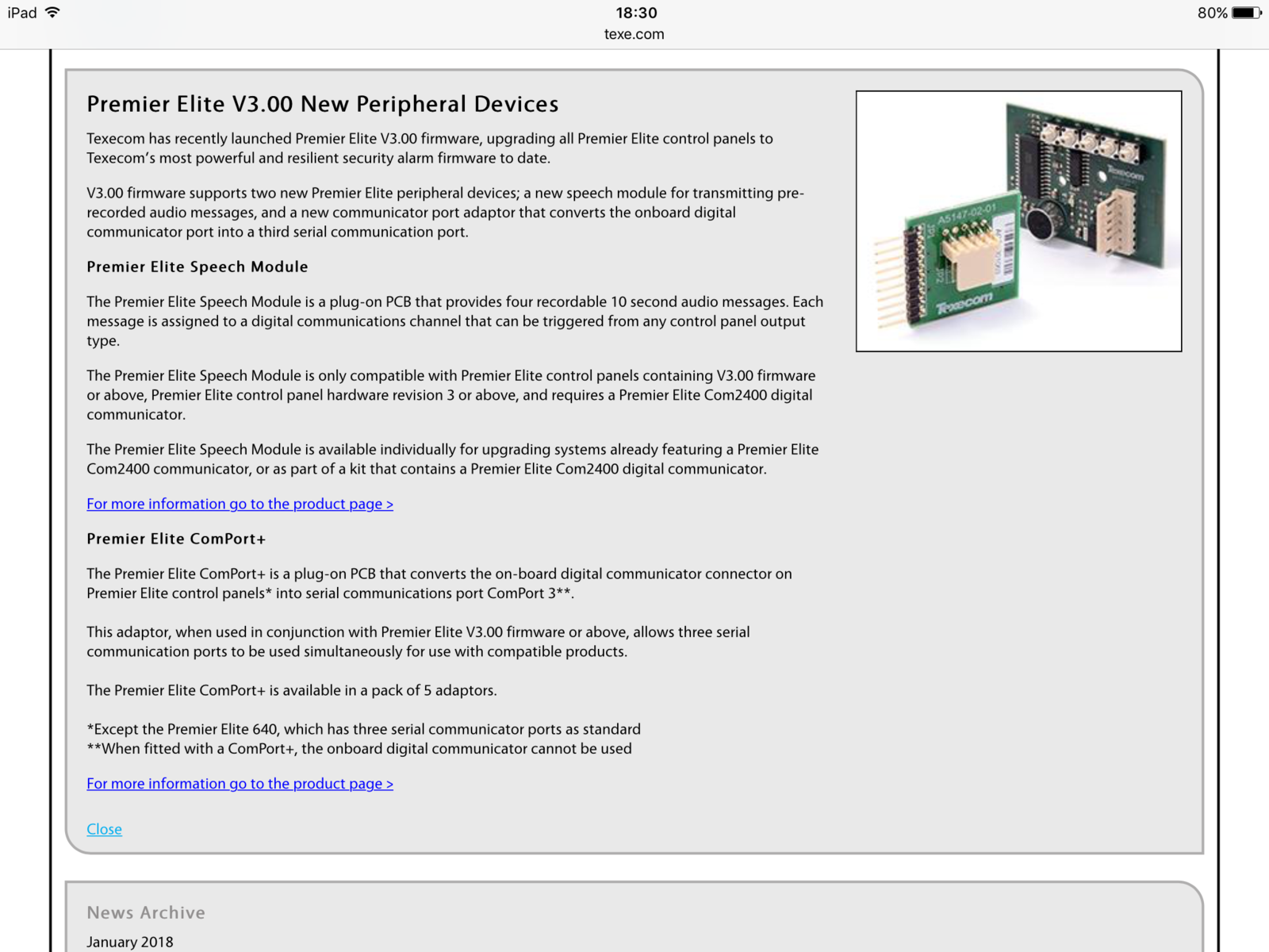

Another question, on my current set up I have the com gsm my concern is the texts sometimes get ignore or missed, is adding a speach dialer worth it? People (myself included) are less likely to ignore a phone call.
Looking at the texecom speechdialers I can only find ones that haven’t been updated for years. Are these still a viable option?
Thanks in advance.
IMG_1802.PNG The new premier panels take a plug on low cost speech unit ( £20 ) so you can do both text and speech, requires comm2400

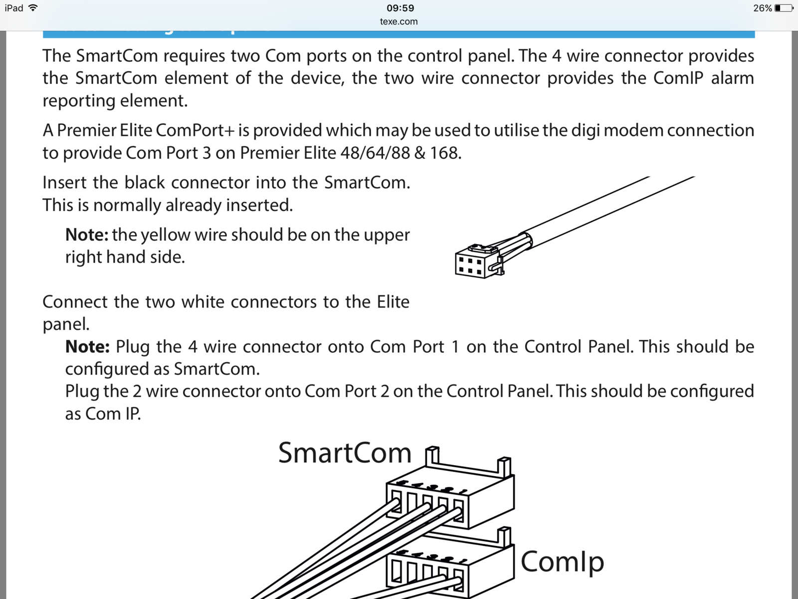

Or add a SmartCom alongside the speech module/2400 and get an app & notifications for free.
I did look at the smart com as well. To be honest I’m going to take the com gsm with me when I move.
Could you have all three on one system? Ie the com gsm, the com 2400 with speech and the smart com?
IMG_1808.PNG I don't think there is enough comm ports ! As the smart comm takes two
How many com ports are they is it three?
If so in effect if I wanted the alarm to ring me, text me and have the smart com I would need to have a Dialer attached?
