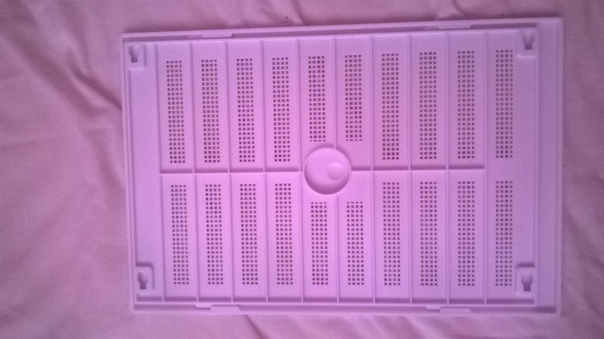

I have only recently bought a replacement vent for my baby's bedroom. The house is mid 1950s built and in the box room there is a vent already screwed into the wall. Its the only vent in the house.
When I bought the replacement vent I discovered there are no screw holes? I have tried to contact the seller but received very poor customer service. They can take my money but they are uncooperative in helping me fix it to the wall.
There are 4 "fixing points" at the back of the vent, does anyone know what tools or equipment I will need and an easy explanation on how to put this on the wall?
I was thinking of just giving up trying to find out what I need to put it up as there are no answers online, and just use no more nails, the glue but it is not very strong at all and says it takes 24-48hr to cure/stick. Any help would be appreciated. Thanks guys x

This is the back of the vent and front, the back has keyhole shaped slots but have no idea what I need and how I fix them? Is it the same as hanging a frame or mirror? I just cant understand the logic of it being similar to hanging a frame as there would be a gap inbetween the vent and the wall

the front cover slides and clicks off. The back part has a hole in each corner. You drill the wall where each hole will be, insert a plasplug, screw the back part to the wall, slide and click the front part on.
If the room becomes damp or you get condensation on the window, slide it open for ventilation. Babies can cope with any amount of fresh air.
p.s.
in your photo, it is upside down. The keyholes go on with the large hole at the bottom. This allows them to fit over and slide down the screwheads, if they project the right distance.

Yes wall plug with a screw in.
With the screws make sure the head is smaller than the large part of the keyhole and larger than the small part.
The important thing is getting then positioned exactly right, which can be tricky in an old wall.
you use a screw of convenient size. Needs to be more than an inch long so it will pass through the plaster into the brick. The screw size is defined as size of the hole x length.
So you might want 4mm x 33mm, which is plenty strong enough for such a light fitting (needlessly big in fact, but a useful size to keep round the house). If it was a shelf or a curtain rail you would need longer.
