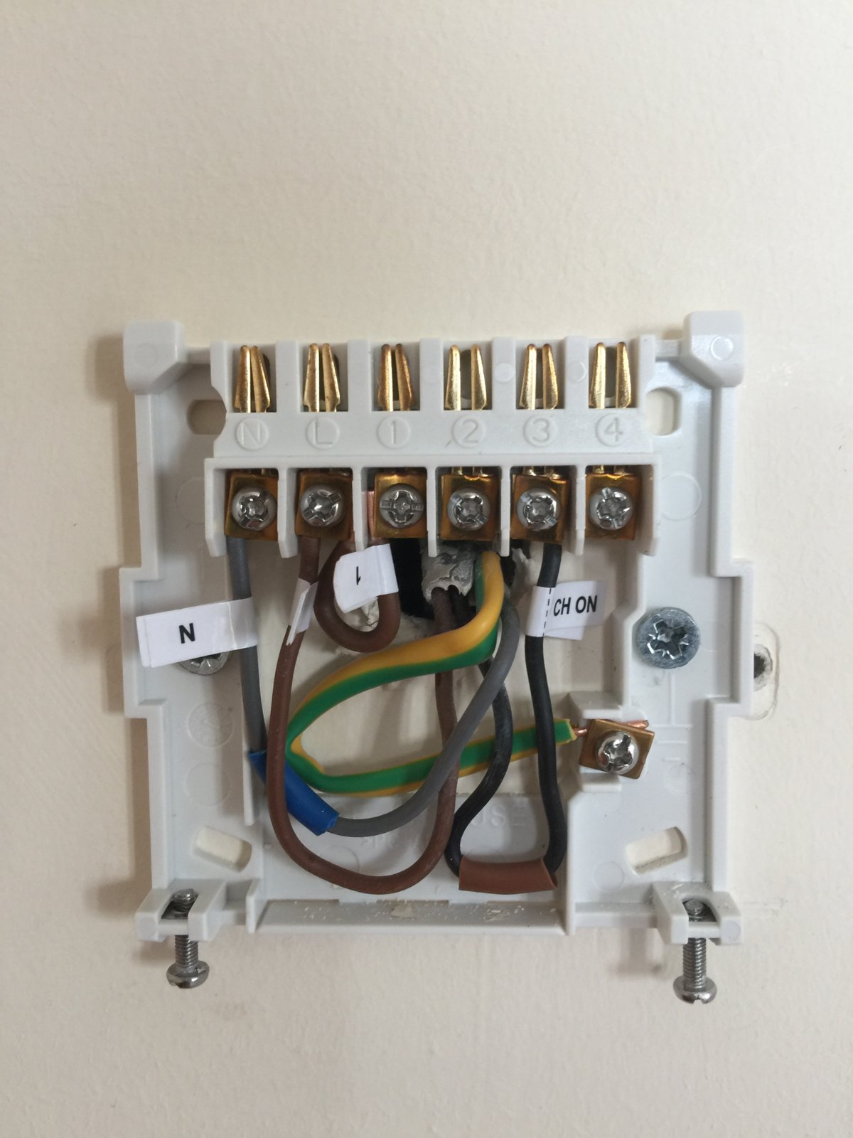

Thanks for posting all the suggestions on this forum. I had similar problem to the initial post, where my upstairs Danfoss TP5000 was connected with only 2 wires. Fortunately N wire was there also, so I could use it for HIVE receiver. I've created the bridge from L to COM as advised and now my second Zone is up and running! Picture attached.

Grey wires on a S plan are permanent live to the zone valves. I'm a British Gas engineer, multizone is easy enough once all wires are identified. All depends on what type of controls are existing. I've got the Honeywell wiring guide I can send you if you are stuck
